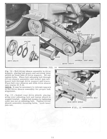

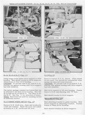

As near as I can tell, that unusual bracket is for a D-19 with 3PH.
These pictures might help you....they're right out of the manual.

Think you are missing the bracket that bolts around the PTO shaft.Plus do you have the pulley that goes on the tractor PTO shaft?

All great info ......
and unfortunately bad news for me....  Grrrr !!!
Thanks fellas
Edit: I do have the pulley assembly that goes on the PTO.... unfortunately that pulley has big chips out of it too.
