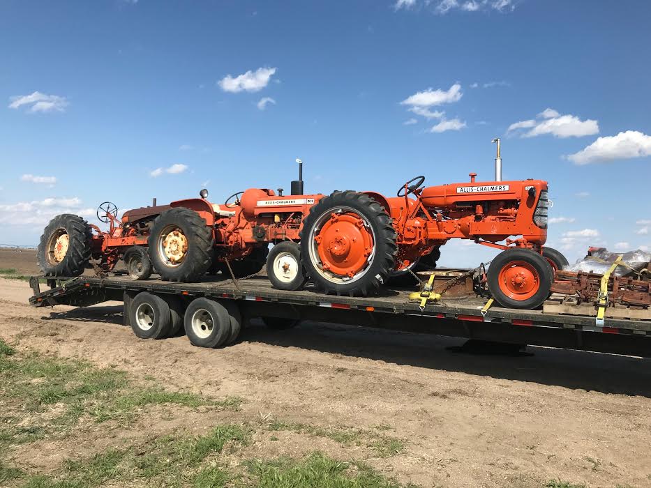

The last coupe of weekends, I have been picking up tractors that I had bought awhile back.

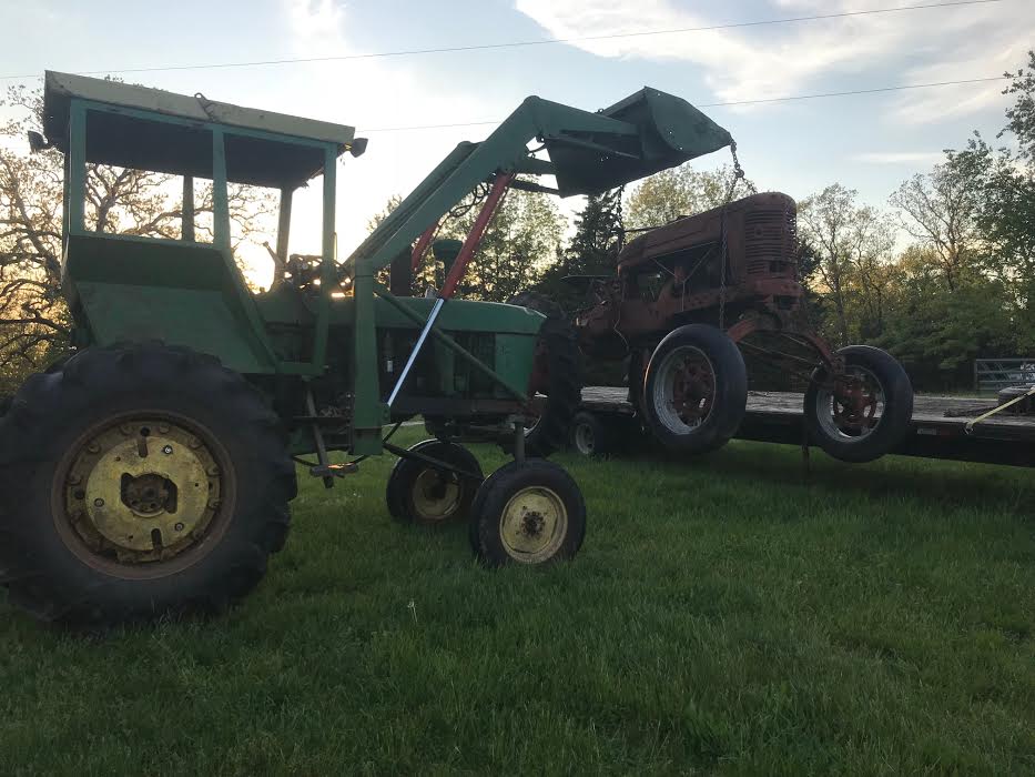

Left on Friday and made it up to Lad's place and pick up some parts.
Fertilizer attachment for Allis G and few other parts for other people in Mo.
Saturday morning made to 2nd stop this drive was not fun Fog was bad.

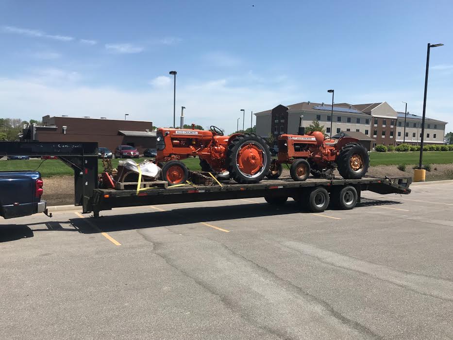

Loaded the D 14 High crop and D 15 Propane series 2.
Then head to Ryan's place and loaded the WD 45 Diesel on the back.
Sunday morning drop the 45 diesel off at Don's place, This will be used for parts for a Project.
Made a stop down the road and moved the D 15 back some and made the ride better with the load to Rolla.
Total miles on the MN trip was 1750.
Wish I would had more time to see other places, but had to be back at work on Monday.
Bought these 2 out of MI and I pick up in Perryville Mo the previous weekend.

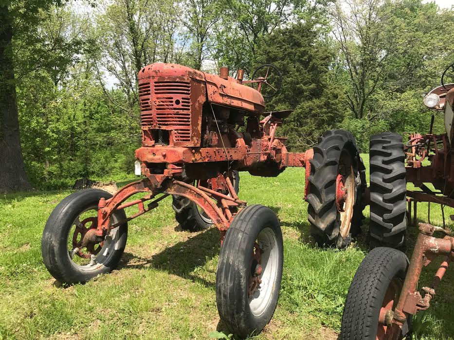

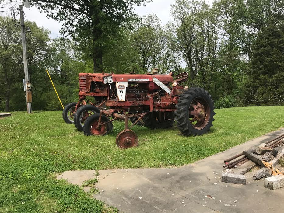

Farmall MV.

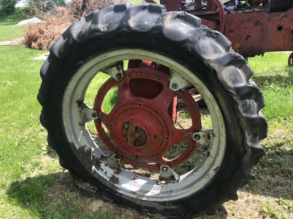

This is taller than my other MV tractors.
Front axle is taller, The Front wheels are 24" instead of the normal 20".
The rear drops are also taller and the rear wheels are the 44" type.
The 560 Gas Hi clear, this will complete the set of Diesel and Propane Hi clear tractors.

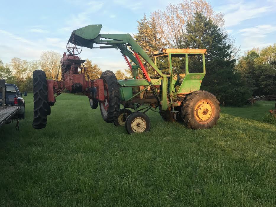

I put a tire on the back of parts Project and moved it in the shop to start removing parts for your tractor. It's a little rusty inside. lol

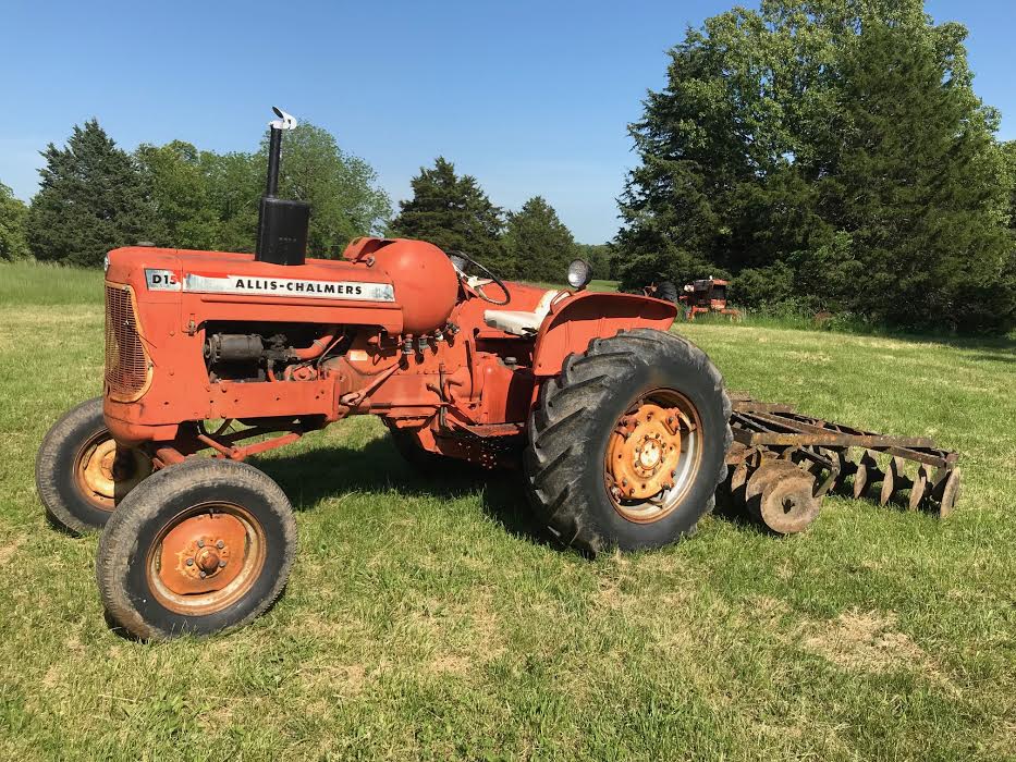

The D14 High crop, not so good on this tractor.
Clean the carb. Points did not have any Spark.
Fix that new coil and also new set of Points.
here is the bad part, when the tractor first started up had no oil pressure.
Put a gauge on the oil filter no change.
Pulled the filter and the stem had been pulled out, when they must of change the filter.
Had another from a parts motor, motor oil pressure came up, but I could already hear something was not right when the very 1st time the tractor started.
Also check the starter and nose was broke off it ,thought maybe this was the noise I was hearing, but after changing it out with another one, that was not the case, Also work on the wiring as they had hotwire for the coil from the battery.
New switch and amp gauge, corrected the wiring for the generator - A and F not going to the correct terminals on the regulator.

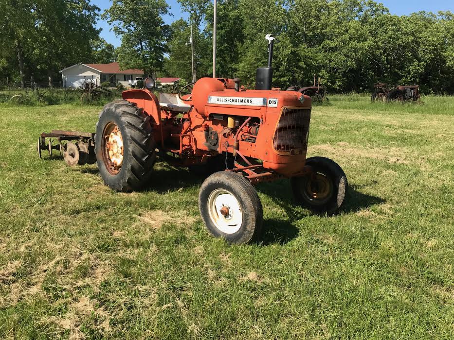

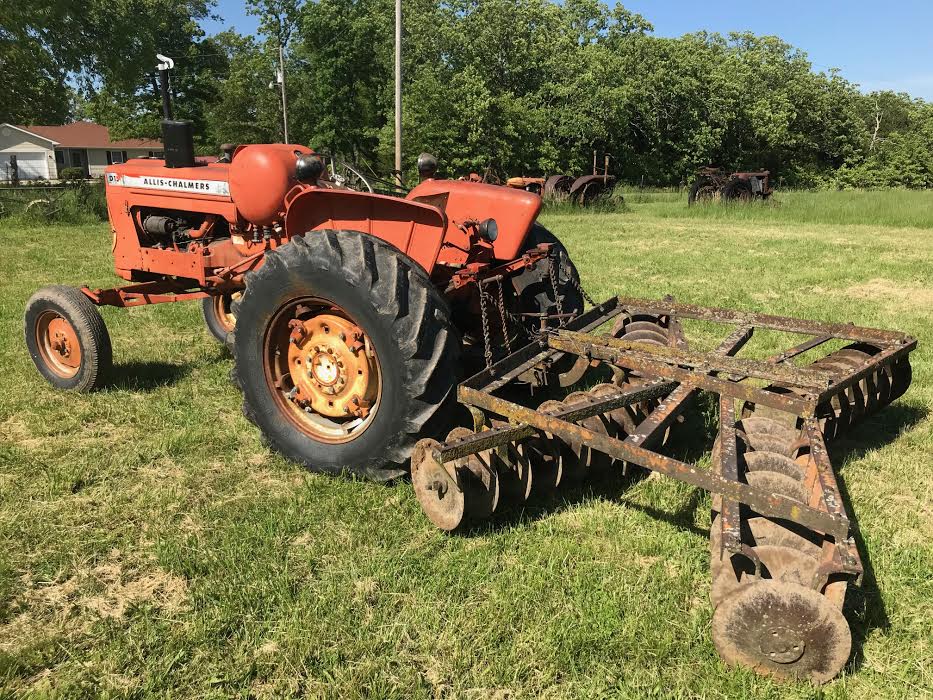

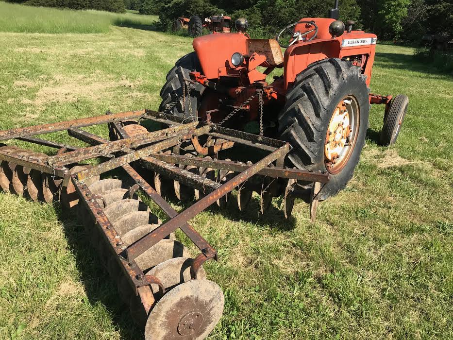

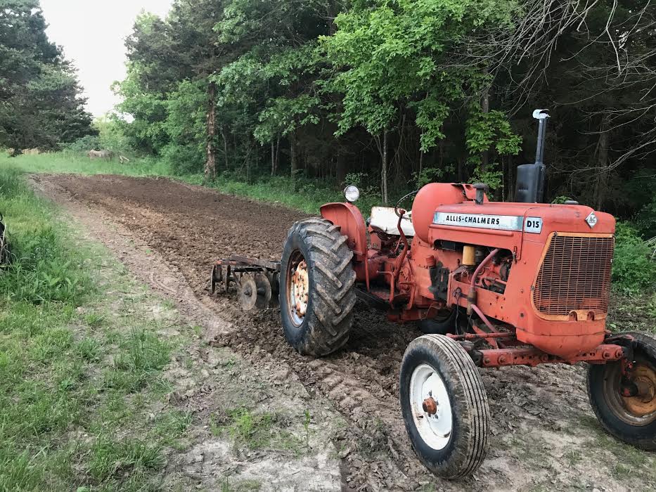

D 15 propane after getting it running, Hook it up the Snap coupler disk today.

 D15 looks real good pulling that SC disc! Good luck on the 14 too. Thanks for the pictures!
Makes me want to go turn some ground over, if it would dry out a little!
