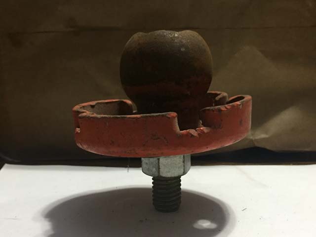

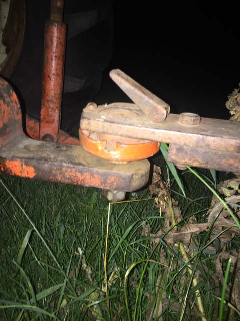

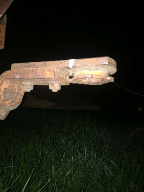

Here are a few pictures!

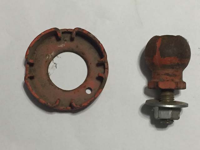

Here's an nos one we have

Post Options Post Options   Thanks (0) Thanks(0)   Quote Dmpaul89 Quote  Post ReplyReply Direct Link To This Post Posted: 25 Apr 2019 at 6:48pm
they work well but the flaw is, its hard to keep the nut tight especially if there is any wear to the drawbar hole. it gets pushed back and forth and loosens up. you really need to shim it to fit each drawbar. plus the ones I had were course thread shanks. the pic above looks like fine thread which wuold be an improvement over what I had. overall a good design and much nicer than dumb old clevis hitch flapping around.

Post Options Post Options   Thanks (0) Thanks(0)   Quote DennisA (IL) Quote  Post ReplyReply Direct Link To This Post Posted: 26 Apr 2019 at 7:46am
OK, I have to ask..
what's the 'magic' for it to latch ?
The 'lever' does 'something' similar to a trailer 'ball coupler' ??
curious...
Jay
under the lever is a pin. When you push the lever down the pin drops in to one of the notches in the locking ring. This prevents the locking ring from rotating and releasing the implement.
