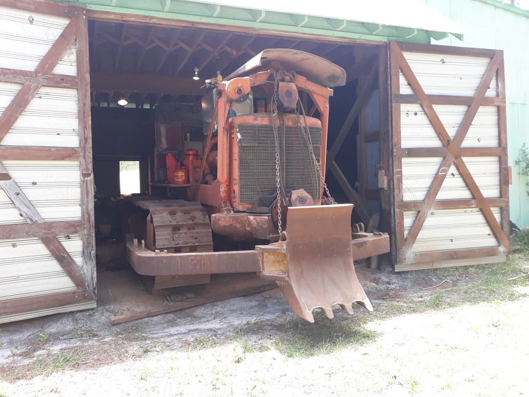

Ok guys.....been corresponding with Calvin on direct email. sent him several pages out of the parts book for converter and fuel lines. Told him to post us some pictures....or send them to me and I would try to post them.  Yep (he took the Darrel route and sent them to me) LOL.
Looks like it was a scraper pusher
This looks like a very very nice specimen !! It definitely needs to be preserved.  Keep working on it...ask more questions here..whatever it takes to get it out of there. More pictures!...especially the one of you loading it on the lowbed to haul it home.

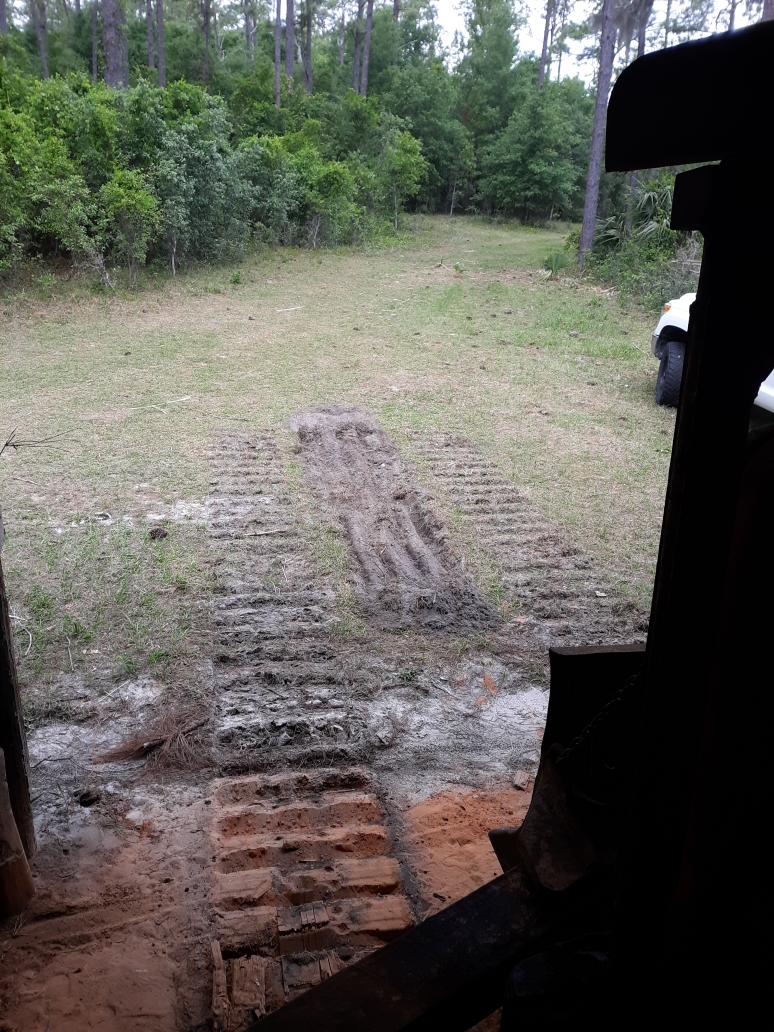

Well I fired it back up and let converter spin in neutral for a few minutes I then put it in gear and Davidson throttle for 30 seconds or so I pulled down on both steering clutches a few times and let him go and all of a sudden pop she starts walking right out. I drove it out approximately 20 ft to see if it will steer and it didn't really want to but did not try the band brakes while operating steering lever either I backed it back in and shut it down couldn't believe it. Everything seemed really smooth when going forward and backward. This thing Hall's but in first gear if you wanted it to can imagine 2nd gear. Once I get main tank hooked backup I will test steering clutches more and see if Band Breaks will help steer it I have about 1/2 Mile Drive through the woods and a few turns through the trail to get it to the pasture.
CAL(KS) View Drop Down
Joined: 18 Sep 2009
Location: Chapman, KS
Points: 3804
Post Options Post Options   Thanks (0) Thanks(0)   Quote CAL(KS) Quote  Post ReplyReply Direct Link To This Post Posted: 26 Apr 2019 at 12:28pm
thats great.  they wont steer well without a load you will need to use the brakes.

Sorry about the double pics above. Just wanted to show you guys taking a peek of daylight

Judging from the gouge you got it moving!! Now would be time to get that winch functional to drag that nose Up!

It'll sure take you a long time to build a pond with that monster of a blade.    Hope you get her going good. Everything I see looks good.. Good luck with her
Yea i chained up the stump ripper. Didn't whant it to drag when going out but as far as I know that's as high as it can go up because there's bunk plates further back towards middle track. The reason why I have it chained is because the front blade control slave cylinders were taken apart and laying on the floor board when i found her so I did not want to push my luck with that i just need to get her home now and then i will start hitting buttons lol
