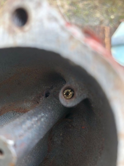

May be a long shot but I would check the intake manifold for a leak where it mates up with the block.
1957 WD45 dad's first AC
1968 one-seventy
1956 F40 Ferguson
Post Options Post Options   Thanks (0) Thanks(0)   Quote CTuckerNWIL Quote  Post ReplyReply Direct Link To This Post Posted: 13 Apr 2019 at 11:21am
Originally posted by Ranse Ranse wrote:
 It's a new hose and clamps, looked ok the last time I had the carb off. That's the only place it could be drawing air unless there's a big rust hole on the back side of the breather that I've never seen. I never had it off the tractor.
That is NOT the only place it can draw air. If you have a leak in the manifold, whether it's where it mates to the head OR internally, it can and will draw air from the area of least resistance. You could have a rusted thru spot inside the manifold, letting exhaust gas be sucked back into the engine. Wink

I haven't had a chance to tinker with the B since the other day. I'll probably drain the fuel tomorrow. That valve lash is something else new to me. I've heard of adjusting valves, but I don't know exactly what you are referring to when you say "valve lash".
I'm also going to check the suction at the carburetor to see if there's more vacuum there. I don't believe there's a manifold leak, not an obvious one anyway. If it's internal how can you tell? I have a suspicion the compression isn't good. It's just a suspicion, I have no way to check that either.

Well I've got a ton more suction at the carburetor than I did at the breather pipe. I can choke it to death in an instant with my hand. I'm not sure if that's good news or bad. The tractor does seem to run better with fresh gas and no breather, but it's still sputtering. Especially at idle. The adjustment screw still don't seem to do much. I think it's safe to say at this point that it's not an adjustment issue.
My question now is how was it getting air before? I still don't think that hose was the problem. Over condition of the canister looks good. It's made a little different than the one on the D10. How do you get the mesh out so I can wash it? It looks like this bottom flange is painted on, but it's hard to tell. It could be pressed on. I believe it will knock off, but I want to know for sure before I start whacking on it.

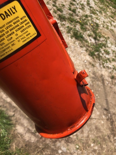

Post Options Post Options   Thanks (0) Thanks(0)   Quote CTuckerNWIL Quote  Post ReplyReply Direct Link To This Post Posted: 16 Apr 2019 at 8:44pm
The retainer for the wire mesh, is spot welded in. Gotta break the weld to get the mesh out, or soak the whole thing in diesel for a while and swish it out good. Maybe pressure wash it at the car wash? I removed mine on the old WC, because it was crumbling and I didn't want any of that going into my NEW engine.

Is there an o ring in the air cleaner for a seal so it wouldn't suck in air at the oil cup joint
I just checked my WD which has the same type air cleaner and it has a cork gasket(had tractor from new, 1950) where the oil cup fits into the air filter itself. If yours is missing, that is where it is getting air from when you held your hand on the intake and the motor didn't stop in about 3 seconds, if the hose had a good fit between the carb and air cleaner.
When you held your hand on carb intake did the exhaust smoke and tractor shut off in about 3 seconds, if not check the gas system starting at the gas  tank valve for blockage. If there is dirt in the valve check the inside of tank.

No I don't believe there was a O-ring or gasket on the oil breather cup.

I have 5 of these engines running and none have ever had a gasket on the air cleaner cup. They might have had at one time but I have never seen one or put one on.

I took the carburetor a part yesterday and put it in to soak. I was going to put it back together today, but I ended up working at my daughter and son in law's place putting down base boards all day. I did take a look at it. All the paint is blistered and is going to come off. I expected that. I just put it back in the bucket. By the time I get to it tomorrow, it will have been in the solution close to 48 hours. It should be clean, I hope it don't do any harm. I don't believe I should take it out until I'm ready to finish cleaning it up.
Ranse View Drop Down
Joined: 11 Mar 2016
Location: Tennessee
Points: 782
Post Options Post Options   Thanks (0) Thanks(0)   Quote Ranse Quote  Post ReplyReply Direct Link To This Post Posted: 24 Apr 2019 at 8:47pm
I finally did a little more work on the B. I got the carburetor cleaned and back together. I'm telling you, if this carburetor gets any cleaner, someone else will have to do it. It is as clean as I can get it. It probably ain't perfect, but that's the way it is.
I put the carb on and it actually ran worse. It would only run a second or two at first. It would not idle at all, it would only run at half throttle or more. It spit, sputtered, and cut out worse than before. It smoked more and backed fired when the engine died. I even seen fire shoot from the muffler. It never done that before. It did seem to run a little more consistent with the choke pulled out. No way to adjust the carb with the tractor running like that.
I decided to clean the plugs. All four looked really bad. Number one and number three were dry with lots of dry powdery carbon build on them. Number two and four were wet and oily looking. I thought this was odd, but I don't know what it means.
After cleaning the plugs, the tractor ran better. I did as Dick suggested. I set the stop screw were the throttle plate would stay 1/16" open. By doing this I was able to run the tractor with the throttle all the way back (no linkage adjustment done). I then turned the stop screw until the engine died, then turn it back in just a touch. I restarted the engine and attempted to adjust the air mix screw. At times I thought it was helping, other times I couldn't tell.
In short, I'm still clueless. I think the tractor is cutting out to bad to tell what I'm doing to the carburetor. I think I may need to look else where. I bought new points and condenser. Any tips on installing them without screwing it up worse?

Were the jets easy to get out or did you have to heat them? Did you run drill bits with your fingers behind the power jet and down the discharge tube where the holes meet to get the scale out? Did the discharge tube have any of the little holes close to the bottom plugged?
Joined: 11 Mar 2016
Location: Tennessee
Points: 782
Post Options Post Options   Thanks (0) Thanks(0)   Quote Ranse Quote  Post ReplyReply Direct Link To This Post Posted: 25 Apr 2019 at 11:26am
Dick,
The only jet that was hard to get out was the one below. That was mainly because of where it was at. Every screw driver I had small enough to go thru the hole above it was to small to grab the shoulders of the jet. I ended up grinding down a larger screw driver. I didn't heat anything. I didn't use drill bits, I used a tip cleaner for a cutting torch. The discharge tube I think you are referring to, I run the tip cleaner thru the center. However, that's a big tube and the cleaner wasn't tight. The tiny holes in the bottom part I could see daylight thru them, and I sprayed carb cleaner thru them freely. Everything was disassembled and soak in a bucket of carburetor solution for two days. Then I sprayed with carb cleaner and blew it out again and again. It all seemed free to me. I know its got to be cleaner than before. Like I said, if it gets any cleaner, I'll have to get a professional to do it. It ran worse at first, but I think it may be a little better now than before. It's a long way from being right.
