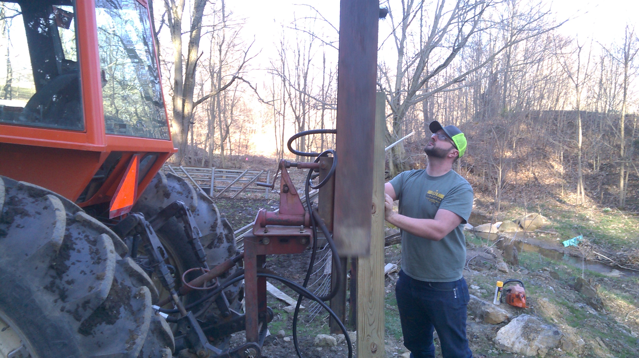

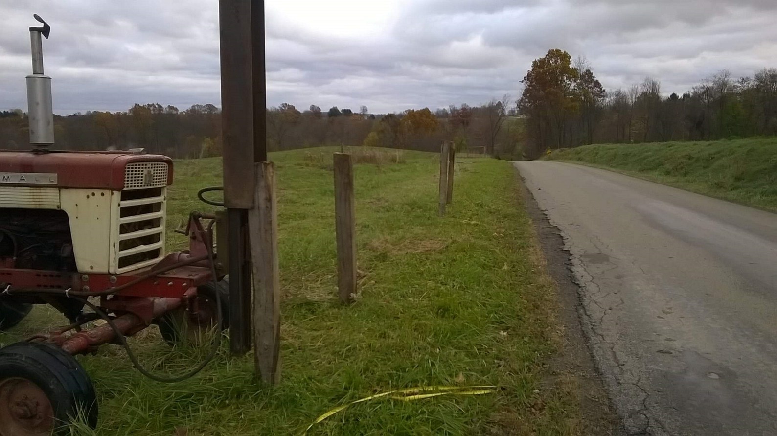

I run the same driver on my Farmall 560 and now on my 7010. My return line is big but it's still plumbed into the return port like any other piece of equipment. No problems yet. You do have to open the valve full on the downstroke. It seems to be more effective on the larger tractor. More inertia I think. I had it on the front of the 560. Handy but it would bounce the front a mite. I'd load pics but apparently this site doesn't like them today.
