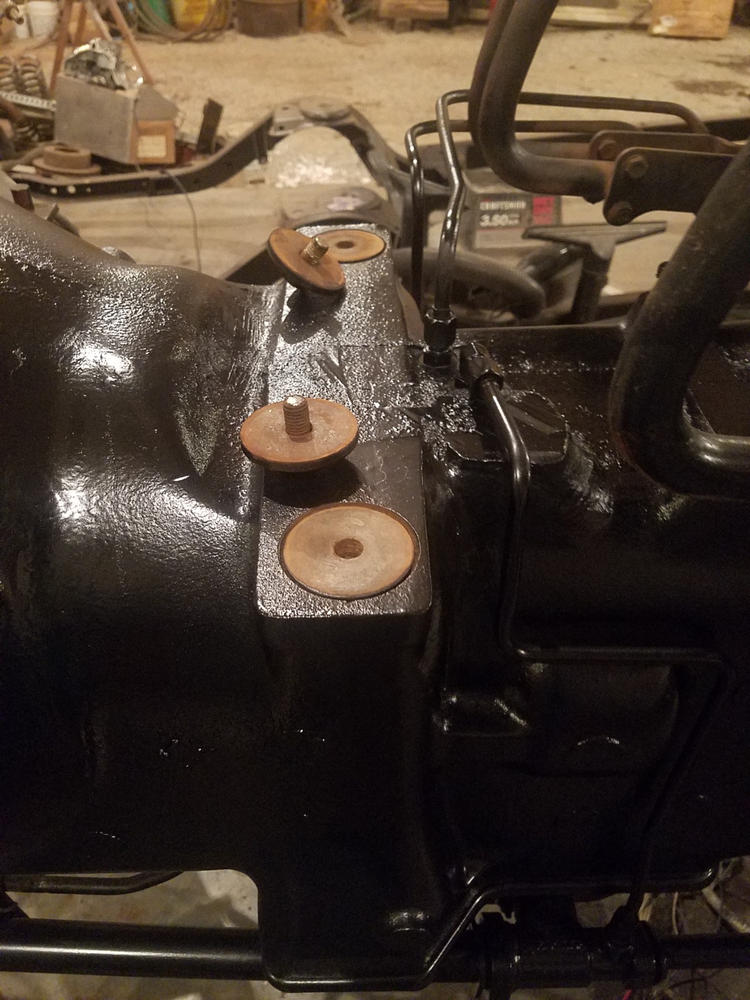

On this bracket on a 7000 there are 2 large washers between it and the housing. I would think these washers should have rubber between them as a vibration dampener. Mine just has the 2 large diameter washers together.
This is between the engine and the steering column.
Any help is appreciated.

Is this the bottom of the cab?
Are you thinking it is the cab isolators?
I need a better pic to know where you are?

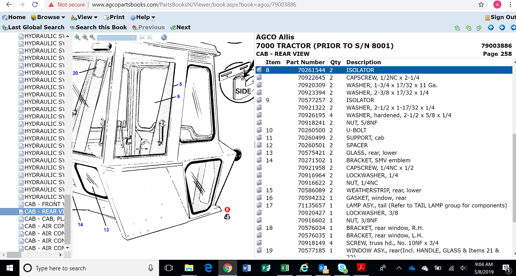

On a 7000, all I can find for an isolator in the parts book are the isolators for the steps. The 7050 parts book shows isolators where the front of the cab mounts on the channel irons.

It looks to be part 70261544.  It is quite well hidden in the Cab-rear view page of the parts book.  Almost need a magnifying glass to find it!

If it is a black belly, it looks like the same part number.  It is located in the Cab-platform page of the parts manual.

Yep there the little sucker is

This is on the bracket that the floor pans bolt to. No cab. Just behind the engine. 76 model. Originally maroon.
