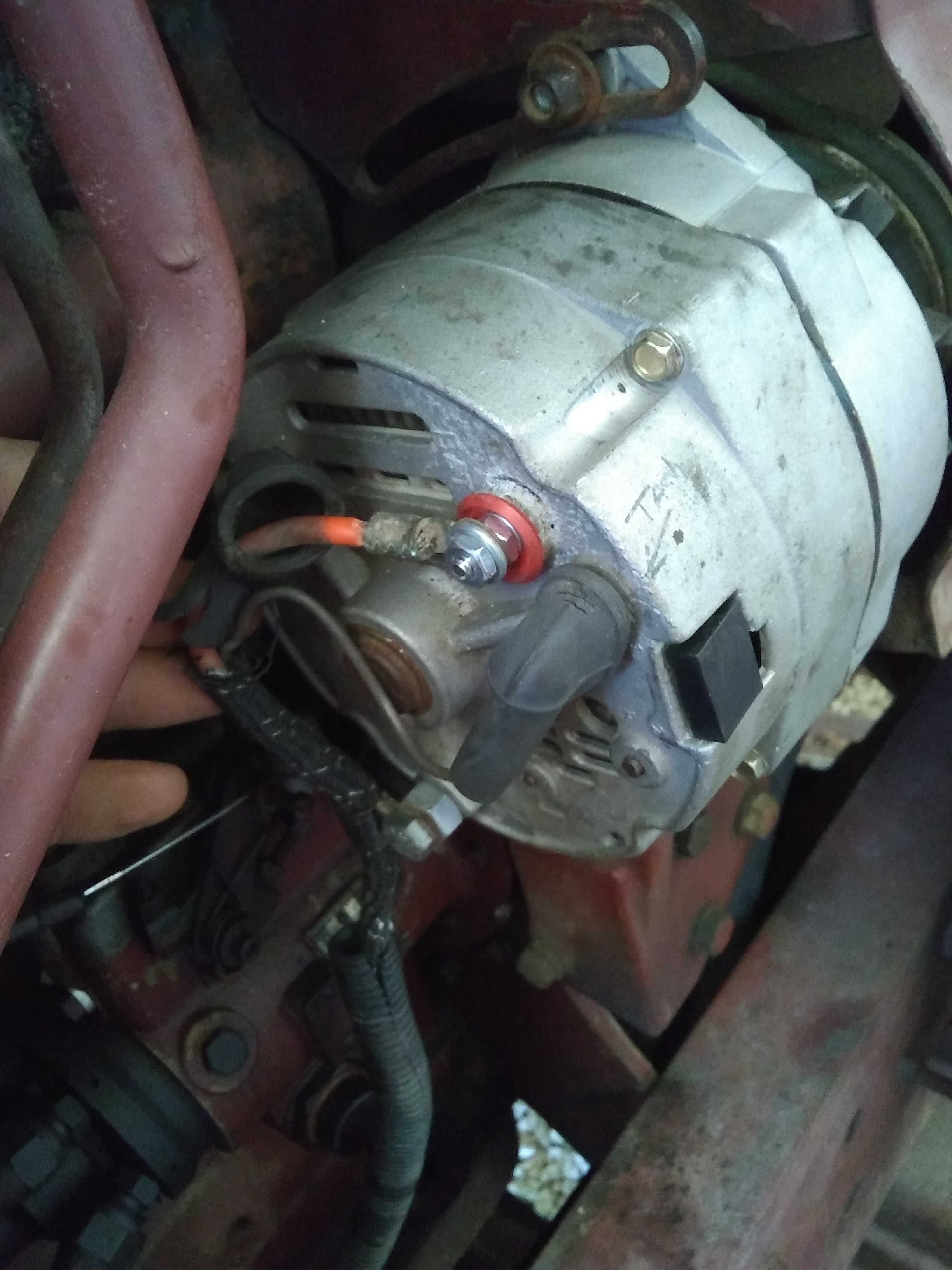

Post Options Post Options   Thanks (0) Thanks(0)   Quote Blustery Knoll Farm Quote  Post ReplyReply Direct Link To This Post Posted: 19 Apr 2019 at 4:31pm
Here's what I have for wiring. My wiring diagram indicates brown goes to tach and orange to a circuit breaker, then the battery.

Post Options Post Options   Thanks (0) Thanks(0)   Quote Lynn Marshall Quote  Post ReplyReply Direct Link To This Post Posted: 19 Apr 2019 at 6:17pm
You have a one wire Delco there. If the alternator is charging,the wiring is good,and the tachometer head is good,it should work. The engine speed may not read right if the pulley is not the right size. The harness appears to be from an early Niehoff set up.
