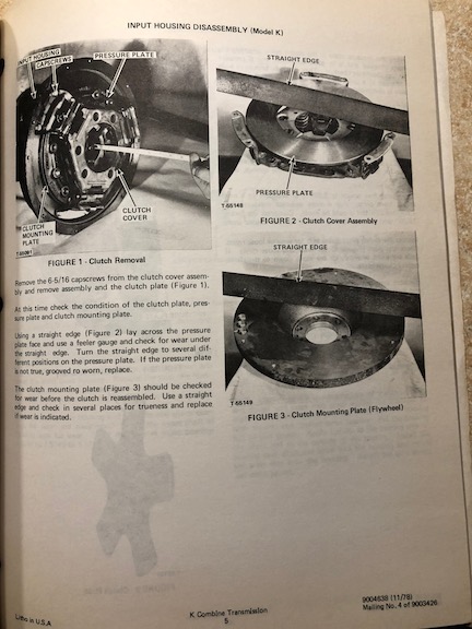

So, I gave you most culprits to inspect (temps, trueness, bearings, & wallowing) other potential while you’re doing repair.
AGCO usually has all parts or can get them thru AI-parts. Flywheel can be resurfaced if 1/16”-3/32” or less wear. Wear above that makes it difficult to adjust linkage enough to accommodate loss. I have had 1/8”-5/32” wear resurfaced, but it’s nearly impossible to get clutch peddle linkage right which can cause pre-mature clutch failure.
Edited by AC7060IL - 06 Feb 2019 at 6:18am

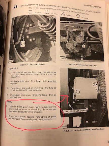

Inner hub should get about half a pump of grease daily. Too much grease can push by worn/flattened o-ring at inner end of inner hub, then grease ends up inside spring canister, collects dirt, & can ruin inner hub bearing, let alone gum up & restrick spring movement.
Also, don’t over grease input shaft’s 2 bearings which reside inside it’s housing. These two roller ball bearings have no inner grease covers(their balls are partially open to grease). So if that housing is half full of hot liquified grease, it’s usually happy. Too little grease is bad. Too much grease allows it to run between the bearings inner races & input shaft. When that happens the bearing’s inner race starts slipping on shaft. Have replaced several input shaft’s where both housing bearings have cut into shaft. These two bearings require press fits onto both the input shaft & outer housing. Shaft needs to be tight fit with absolutely no play.
Number 1 denotes the inner hub grease zerk. This is the one I referred to that may require a half of a pump per day. As noted in the OM photo (hub may not take much grease after initial greasing.) That translates to a new tight inner hub equipped with a non-flatted oring. In time though, the o-ring wears in some & becomes somewhat flattened on it's shaft side. When that happens, then it usually requires a little grease(half a pump of grease gun) each day.
Number 2 denotes the input clutch housing zerk. It says, "One stroke of grease gun per week. Over greasing may damage clutch," This is the zerk that greases the 2 partially open faced input shaft bearings. You can't see it in this photo, but if you view the parts picture of this housing (item 7), these 2 bearings (#8 & #5) are spread apart(maybe 4-5") by spacer (item 6). So there is a small cavity between the bearings. Both of these bearings have seals to their outsides, but are partially open to their insides as they face each other. During new assemply or a rebuild, you pump a minimum of 10-12 shots of grease into this cavity. Heat from the variable speed belt/sheaves, transfers into the input shaft which in turn goes into this housing area where these bearings reside. That heat liquifies the pumped in grease within this housing. In other words, it becomes like a liquid grease bath for the 2 bearings. During operation of machine, don't grease this cavity everyday.
Edited by AC7060IL - 06 Feb 2019 at 5:14am

I added a photo & more discussion to that prior post.

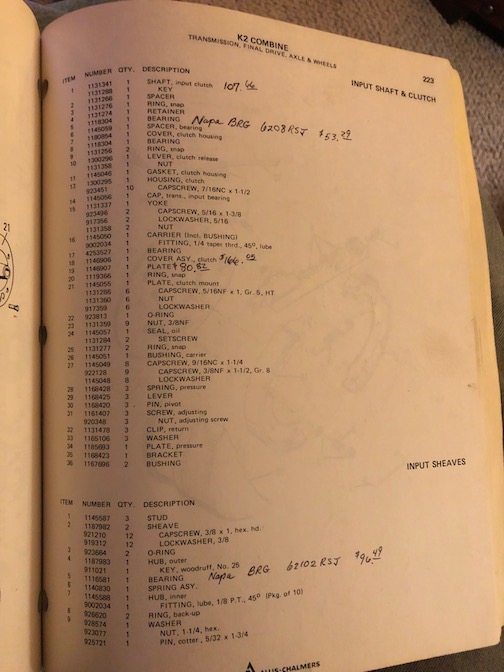

I also edited my prior reply about replacing throw out bearing. The dis-assembly process is involved, but some items can stay intact if all are in good standing. Please re-read that post to see those edits.
If you view the names of items in the part's numbers, quantity, &  description page, you'll see the term "plate" used quite a bit. For clarity with the AGCO parts counter people, we usually referred to things a little differently. Terms we used were as follows:
"Clutch Pak" is number 18, which book calls it "COVER ASY, CLUTCH." It contains a pressure PLATE. In all my years I never replaced a pressure plate. Instead a whole new Clutch Pak is used in a rebuild.
"Clutch Disc" is number 19, which book calls it "PLATE". I think AGCO only offers a 4 button disc, but you can ask for a 5 or 6 button. AI's might be a 5 button? I would always take a 5 or 6 button over a 4 button cause I felt they grabbed better.
"Flywheel" is number 21, which book calls it "PLATE, CLUTCH MOUNT". It is keyed & pressed onto the input shaft & held in place by a very thick snap ring. To remove flywheel from input shaft, start by removing snap ring. Then arrange, kinda in a circle, 3 6"x6"x12" wooden blocks on concrete in such a way to support only the outer round lip of input shaft housing. Using gravity & inertia, grab the input shaft with both hands & lift it, along with it's housing & flywheel, about chest high. So with flywheel facing the floor, drop it onto the 3 wooden blocks so as to allow the flywheel space to move when the outer edge of housing stops on wooden blocks. Done successfully, the flywheel will usually just slide off the input shaft in about 2-3 drops.
Edited by AC7060IL - 06 Feb 2019 at 6:32am

Thanks for the photo in your updated post, as well as the term explanations in your last post. I'm beginning to think your operator's manual may be a little newer than my transmission, as my manual only lists what yours labels as #1 (for greasing), the input sheave hub, and it says lubricate every 10 hours, where yours says every 40. Mine takes grease very well (even though everything seems tight), and the book doesn't offer any clues as to how much to pump in, etc. The only advice it offers is to set the variable speed in full low range to gain access to the zerk. I've looked it over in person, and I can verify there are no other zerks there. Could be a production update later on? If so, I'm beginning to wonder if the grease I'm pumping in is able to work its way into the housing and grease the 2 shaft bearings. I guess it would have to travel through the spring canister then? Looking back at the 860 parts book and the Gleaner EIII/K/K2 parts book verifies most of the parts are the same (same numbers). But the K2 book DOES show that grease zerk on the transmission clutch housing.

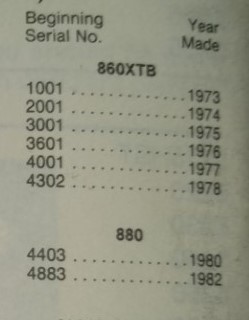

I have zero experience with any of the AC cotton machines. But just viewing your latest “still stripping” video, your 860 appears to have a Gleaner series II cab & 8 bolt wheels on drive tire’s final drive. So that tells me it’s production year should be 1977. Here’s why I think that. The Gleaner k produced from 1969-76 & the short back 1977 K2, all had 8 bolt final drives. The 1978-81 K2s had 10 bolt final drives. The earlier k only had a flat windshield. The curved windshield was used in all the k2s(series II). So a combination of curved windshield & 8 bolt final drive should be 1977??
No #2 grease zero on your 860? Maybe AC just packed the input shaft’s housing with grease at factory?
CrestonM View Drop Down
Joined: 08 Sep 2014
Points: 8454
Post Options Post Options   Thanks (0) Thanks(0)   Quote CrestonM Quote  Post ReplyReply Direct Link To This Post Posted: 06 Feb 2019 at 10:31am
I can understand your thinking on why it would be a 1977, and I know it's a little confusing (I've wondered why they have the later-style cab myself) but I know for sure it's a 1975 model, as I have a serial number list. Also, in 1976/77 they changed the design of the basket a little bit and made a few other changes on the machines.
Swinford's book shows two early 860s, and they are either 1973 or 74 models, and they have the curved windshields.
My serial number is 3091, making it 1975, and my parts machine is a 1974 I believe.
Only thing I've thought was maybe the cabs were from an M/L (hence the curved glass) and not actually a K? It is built on a K/K2 chassis, though.
As far as the housing not having the zerk, however...I've noticed the spring assemblies between the 860 and K2 (serial 24201-27200) have different numbers, but virtually all other part numbers are identical between the machines, and the 860 book is from 1978, the last year of production, so I guess they didn't add the zerks like they did on the K2? You may be right about the housing being packed with grease. The book doesn't mention it, but I may find out on disassembly.
Edited by CrestonM - 06 Feb 2019 at 10:52am

[QUOTE=CrestonM] Swinford's book shows two early 860s, and they are either 1973 or 74 models. My serial number is 3091, making it 1975. Only thing I've thought was maybe the cabs were from an M/L (hence the curved glass) and not actually a K? It is built on a K/K2 chassis, though.
My thoughts exactly. Yes, the M-L were introduced in that era.

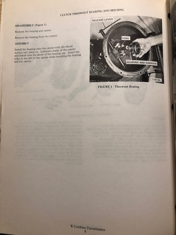

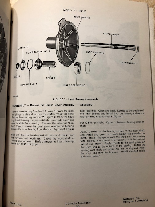

Ok then... We're dealing with a model K. The K2 is slightly different on a few items. Here is what you probably need. It covers the repair of a model K's clutch. Does any of this look familiar?
Edited by AC7060IL - 06 Feb 2019 at 2:56pm
AC7060IL View Drop Down
Joined: 19 Aug 2012
Location: central IL
Points: 3516
Post Options Post Options   Thanks (0) Thanks(0)   Quote AC7060IL Quote  Post ReplyReply Direct Link To This Post Posted: 06 Feb 2019 at 2:55pm
Heres a few more service pages for the Model K trans clutch.

I have several different year Gleaner K OMs. Early models (prior to 73’)show these 2 grease items;
- traction drive sheave hub(hub may not take much grease after initial greasing).
- clutch throw out bearing.
There is nothing else mentioned.
Joined: 08 Sep 2014
Points: 8454
Post Options Post Options   Thanks (0) Thanks(0)   Quote CrestonM Quote  Post ReplyReply Direct Link To This Post Posted: 06 Feb 2019 at 5:25pm
Thanks for the pages from the service manual. I'll print those and keep them for reference. Those photos do look like what I have on the 860, at least they correspond with the parts book diagrams.
Only thing I'm left wondering now is why the K book says grease the input sheave hub every 40 hours, and states it may not take much grease, but the 860 book says grease every 10 hours. It'll take as much grease as you want to pump in. Never seen any come out anywhere, so I don't know where it goes, unless it's into the spring canister some way.
