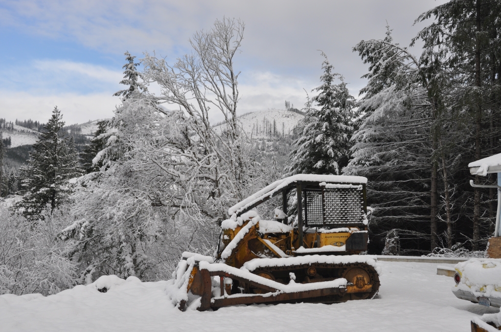

I am finally an owner.  My 1965 HD-6B / AG mutt came home today.  We knew going in that it had a problem on the left side.  Initially the clutches were stuck a couple years ago so my friend soaked them with diesel and eventually got them loose.  Sometime in the meantime now the left side won't drive at all.  The adjustment feels like there is normal freeplay, not much on the steering levers but you can tell it isn't over adjusted near as I can tell.  It runs and shifts fine otherwise, just difficult to maneuver and took a push to get it on the trailer.  It does run and sound good.  Smokes a little when cold and at idle but with temps and rpms in more of the operating range really not much smoke to note.  My plans are to initially see if there is some troubleshooting I can do but expect I am probably looking at rebuilding the steering clutches unless there is some things I can look at beforehand.
Start up of the 7000 engine.

Get the cover off and see what is broken. Has a Spool type bevel gear drive so will be either in the clutch pack or bull gears outside the clutches.

Getting it open is part of the plan.  A week ago it was working..kinda.  Then just sort of gave up.  The drums had been filled up with diesel for a long time to free them so possible the friction disks have given up entirely or are just slick.  Going to try and put some solvent in to see if that will flush out any oily residue.  The plan is to pull them out and rebuild them with new stuff but was expecting them to show some signs of working at least a little.
