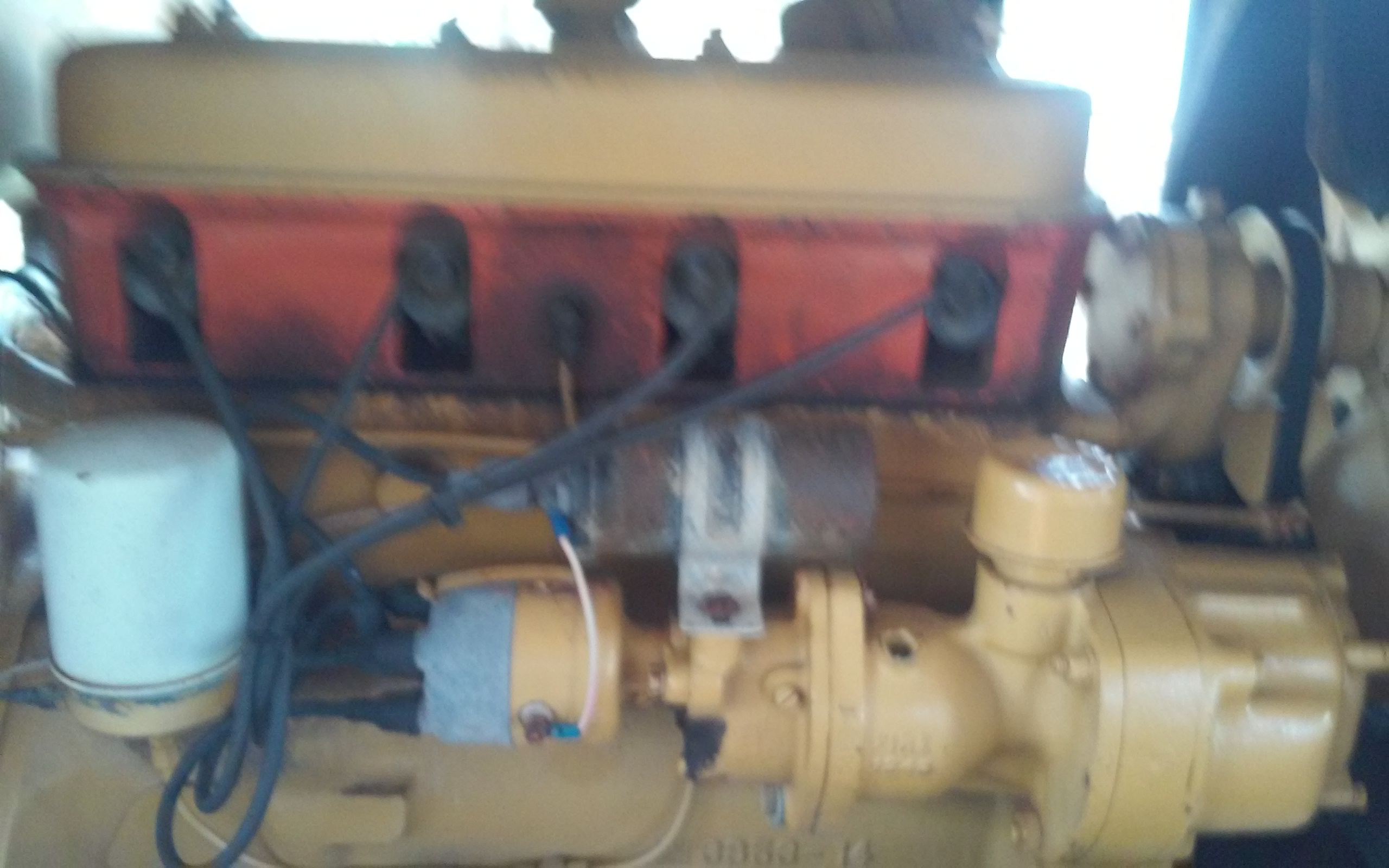

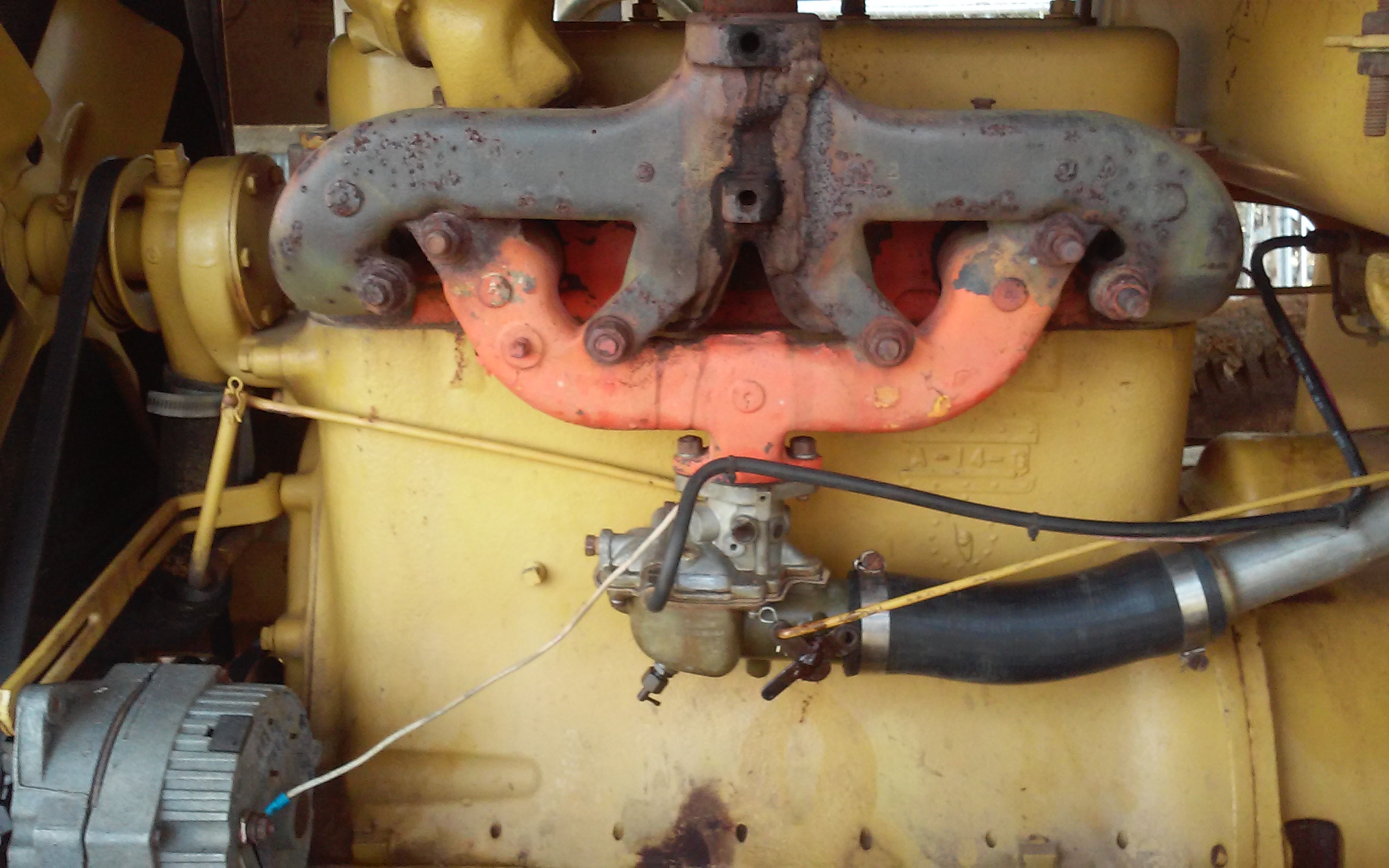

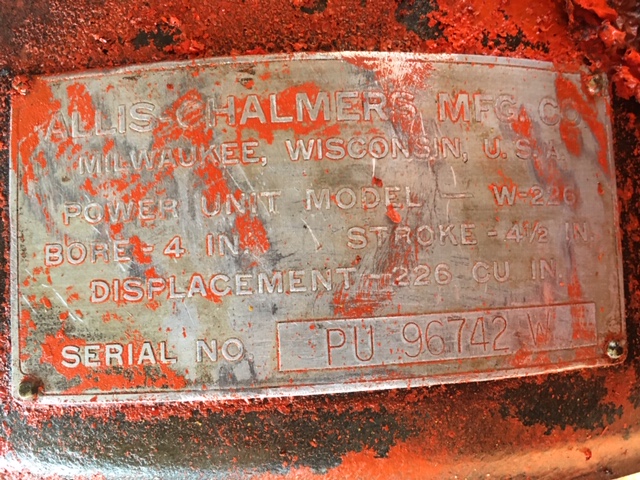

Motor graderD, ser.# D1547, 4 cyl gas engine ser.#21549. Any information on the model of this engine? Raised numbers on block behind carb A-14-G, other side of block AM 3853-14 with 4 underneath. I have searched high and low on the internet trying to determine the model and year of this engine but have had no luck. I don`t think this is the original engine for the grader. Also have another engine that the seller included. Tag on that one indicates Power Unit Model W-226, Serial # PU 96742 W. I`m wondering if this one is interchangable with engine now in grader. Any help on this is appreciated.

Good photos of the engine would likely help. The casting number you posted looks like it might be a 226, possibly like used in a WD45.
Points: 90746
Post Options Post Options   Thanks (0) Thanks(0)   Quote steve(ill) Quote  Post ReplyReply Direct Link To This Post Posted: 04 Mar 2019 at 1:20pm
willis , the D model started to be built in the 1940s and used the same engine that the WC tractor used at  that time... 4 cylinder 201 cubic inch. Later in the decade the tractors had been upgraded to the WD and WD45 and the motor was also enlarged to 226 inches.. You can use either motor in the tractor, the larger motor would obviously have a few more HP.. If you get a motor that was in something "special" like a power unit or generator unit, etc.. it "MIGHT" have a different governor, lube system, etc... but the basic motor would fit.
DonBC View Drop Down
Location: Courtenay, BC,
Points: 947
Post Options Post Options   Thanks (0) Thanks(0)   Quote DonBC Quote  Post ReplyReply Direct Link To This Post Posted: 05 Mar 2019 at 11:53am
That same 226 engine was also used in the D17 gas farm tractor. The transaxle of the D grader was also used by Galion graders and they used IHC engines in their graders. The engines are mounted to the transaxle by a adaptor plate so it is possible that the transaxle served a variety of purposes and a variety of engines. When I made some upgrades to my D grader I shifted the hydraulic pump to be driven off the end of the crankshaft as I could never get the belts to the hydraulic pump tight enough to stop the pump from stalling now and then even with new belts.

From from what I can determine from the grader serial number the grader was built  in 1952. I could be mistaken. From what you told me, the power unit motor  that I have must have been in the machine at some point, and replaced with the present one. The PU shows 226 on the I'd tag. Thanks to everyone who replied  to my questions. You have been most helpful.
