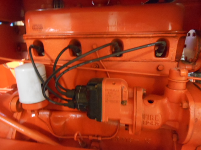

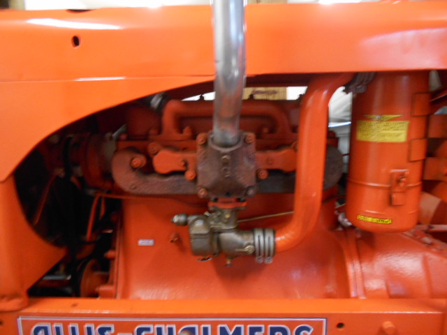

Diptick and BEK Would it be possible to provide a photo of each side of the engine and a close up of the front wheel/rims?
Orangeman
BEK View Drop Down
Joined: 05 Nov 2017
Location: Wilmington, NC
Points: 216
Post Options Post Options   Thanks (0) Thanks(0)   Quote BEK Quote  Post ReplyReply Direct Link To This Post Posted: 29 Dec 2018 at 9:40am
Orangeman
Hope this helps you out Orangeman.

BEK - Thanks so very much for the extra efforts to post the photos.  I have a 37 that needs a good going over.  Are the rims on the front 6 bolt 17"?
I see your 37 has the kerosene engine as the hood is set up for the auxiliary fuel tank.
Again, appreciate the nice photos!!!

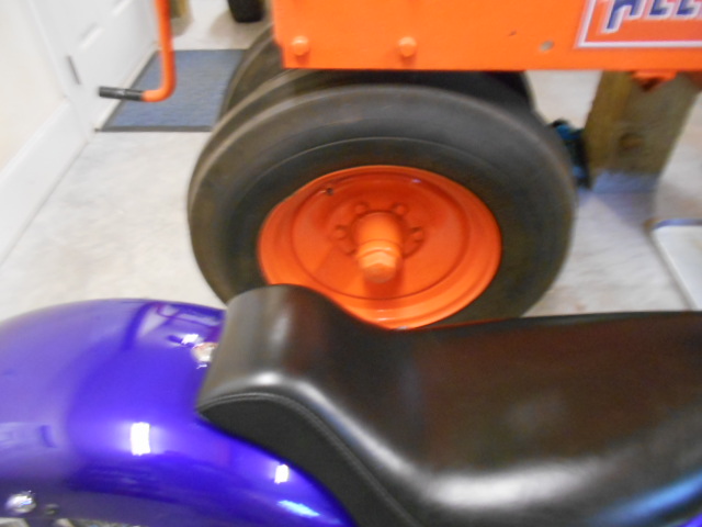

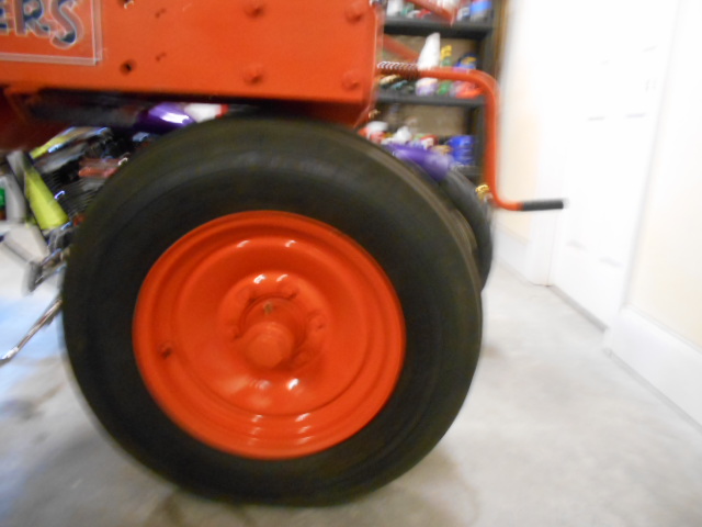

BEK View Drop Down
Joined: 05 Nov 2017
Points: 216
Post Options Post Options   Thanks (0) Thanks(0)   Quote BEK Quote  Post ReplyReply Direct Link To This Post Posted: 29 Dec 2018 at 12:27pm
Orangeman
6 Lug 16" Rims.

BEK's carb and mine on my tractor are bothe dual-fuel carbs, where they are are started on gas,,,,,,,,,,,,, warmed up and then switched from gasoline to tractor fuel,(normally kereosene but it couls also be one of several others depending on ambient tremperatures.
They both are 6 hole rims which is correct.
that never made sense,,,,,,,,,, 5 hole in 35-36,,,,,,,,,,,, 6 hole in 37,,,,,,,,,,,, and back to 5 hole from then on forever thru the models...................
Always wondered what the reason,,,,,,,,,,,,,,,,,,,,,,,,,,,
