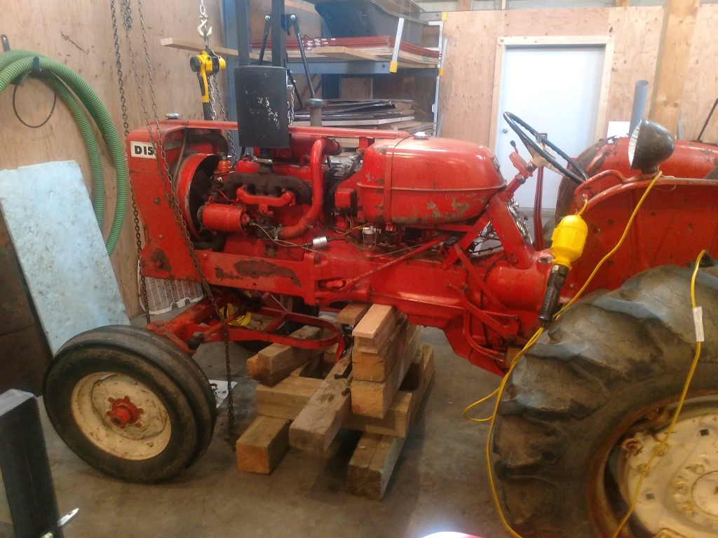

While I was working on the steering box of the D15 I cribbed up under the clutch housing, so I could drop the wide front out of the way.  Had a bottle jack in place to lift using the cribbing as a base.
Worked well.   Used 8x8 and 6x8 with some smaller boards for fine adjustment.

That picture brings back memories of helping dad swap out narrow front /wide front on the D-17 every fall. Dad ran a NI mounted picker for harvest and the '17 was the tillage tractor in the spring and wanted the wide front on for smoother riding. Right or wrong, that's the same jack we used-right down to the color of yours LOL!!
