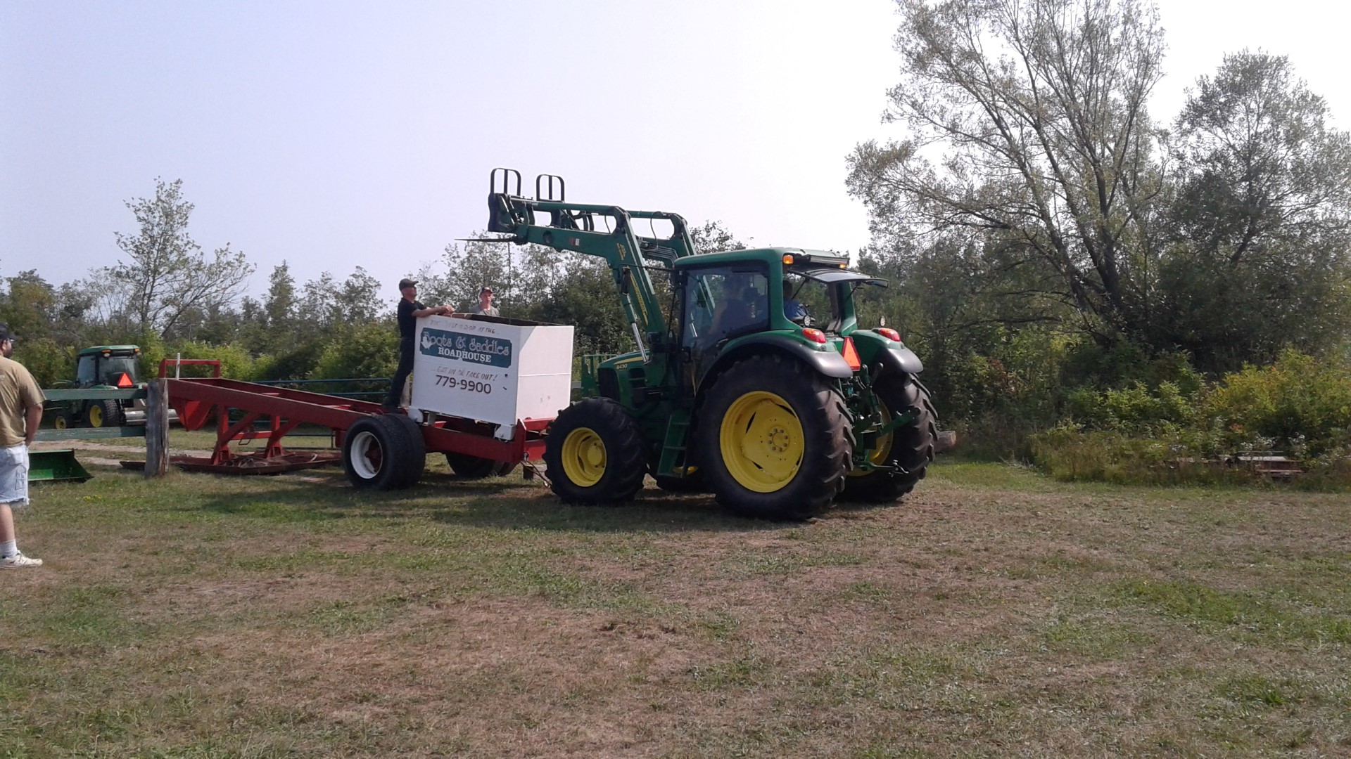

I wanted to watch the last pulls to try and learn something, but I got recruited to run the pullback tractor, LOL.

Sometimes the view from the pull back tractor is not too bad. Spend some time in the pits with other tractors and drivers. Most will help you just enough! Then your on your own to learn. Take some pictures of draw bar hitches and set ups. another good place to spend some time is art the scales. Volunteer to check hitch heights a couple times and you will get to see a variety of styles. If I wanted another tractor a CA would be up there near the top of the list. We need some pictures too!

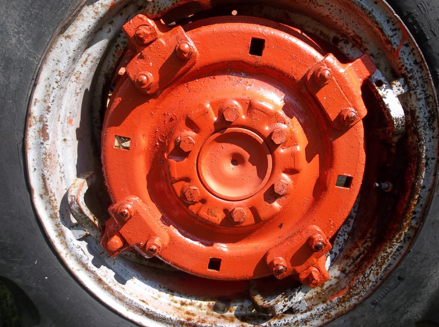

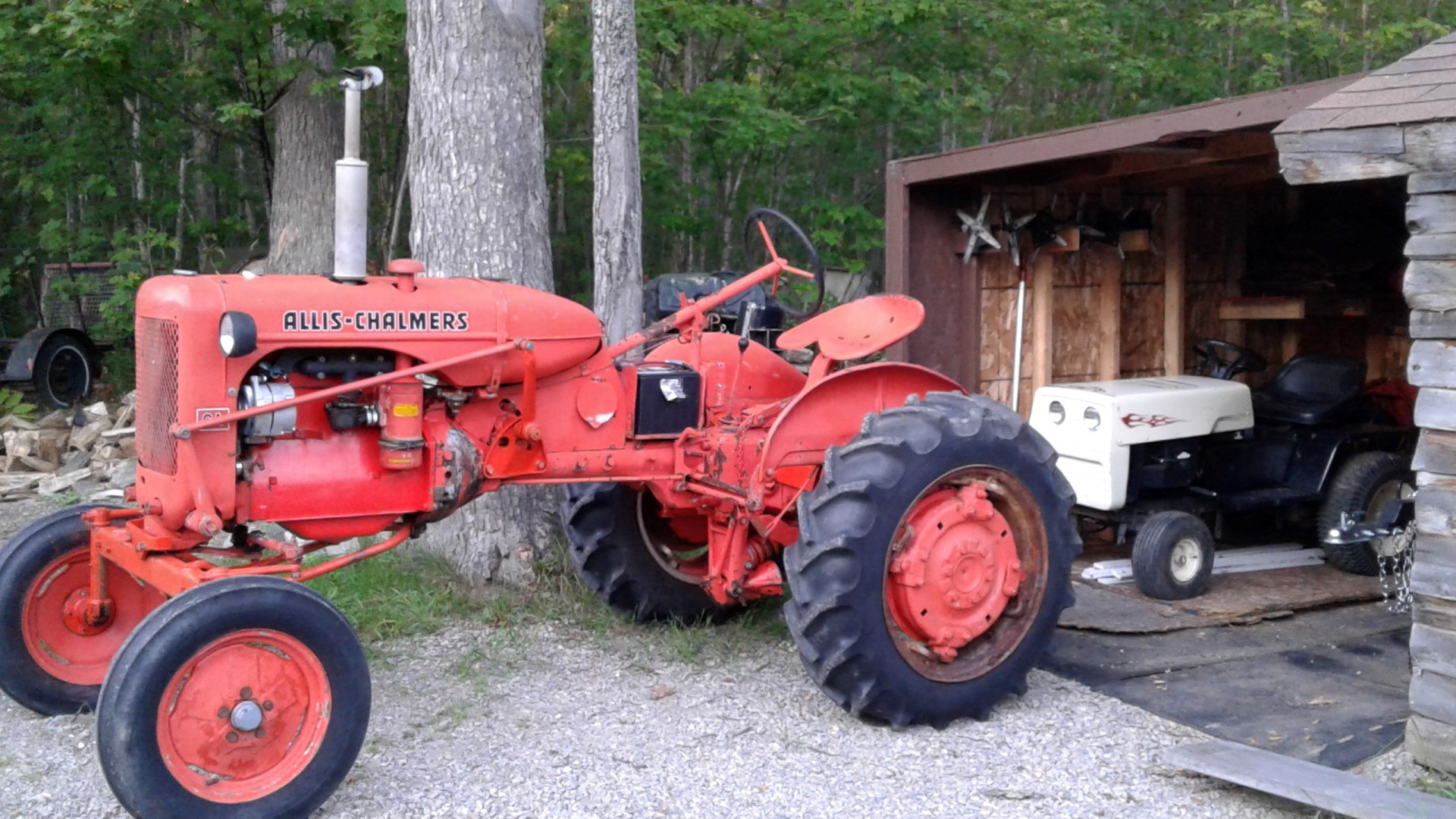

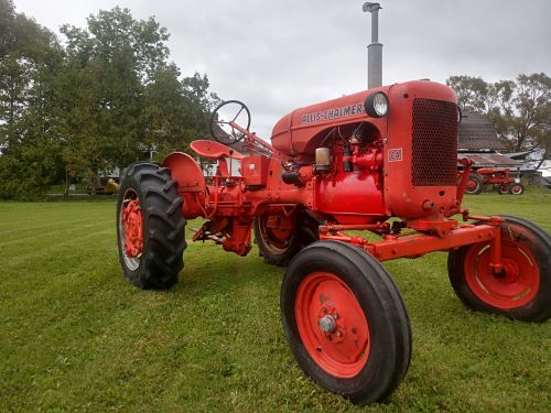

Here's mine. Like I said right now I have just been ordering all the stuff to make it right and look better.
Changing all the fluids and filters, new gauges, some new sheetmetal, and I have to address my rear rims where they are rotten around the valve stems.

Good looking CA! In nice shape too! Yes the rear rims on a lot of vintage tractors need work. After repairing 6 rims it doesn't seem as bad. Your rubber looks pretty good! That will save you some money too.
I like the Bolens too!

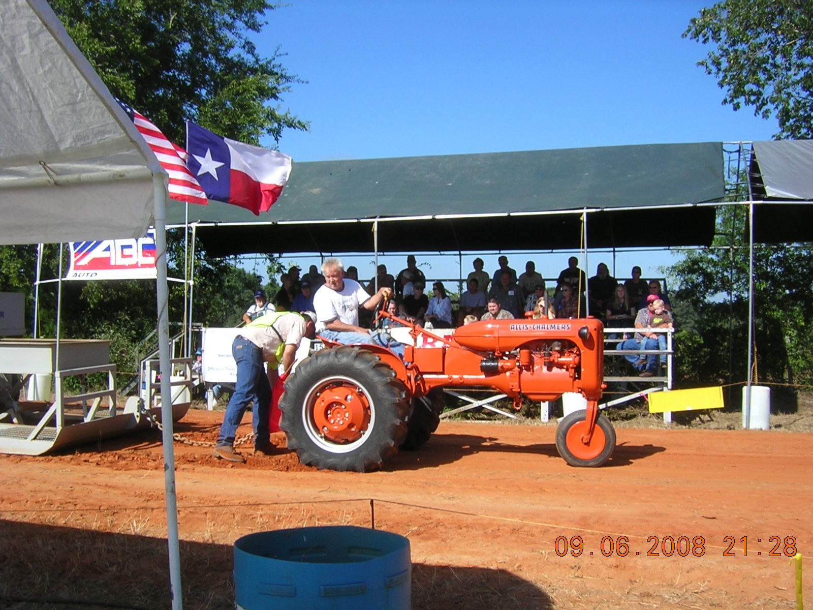

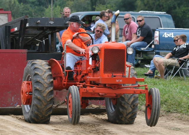

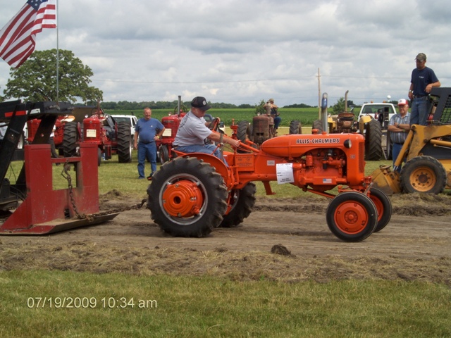

My CA running 13-6 24s on Farmall A wheels and 11"wide  MF plain 4 loop rims. Note the Farmall rear wheel weights.
Edited by Ken in Texas - 09 Oct 2018 at 1:15am

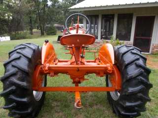

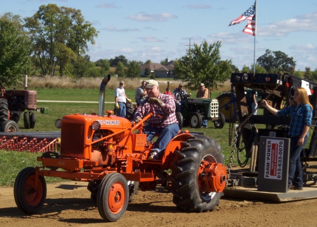

Plain and simple drawbar setup using a long pin hitch drawbar and angle iron to add suitcase weights .

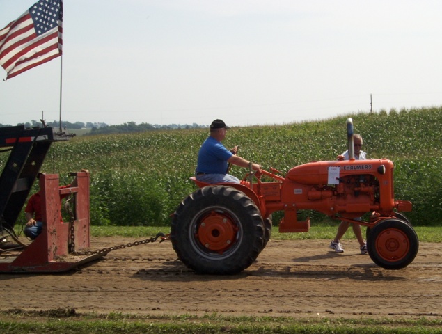

I just looked at all the pics I took at my local pull where I could see the rear of the tractors and it seems everyone has a different style hitch. Some are flat plates with a hole, some are straight clevis, some twist clevis, etc.
But as Ken has shown....I was wondering if I could just start out using the drawbar.

Here's some better pics of what I am dealing with on my rear rims.

Yes that rim needs fixed. Probably before you try pulling it much too. Find a donor rim to cut out  good patches/pieces and weld in, or look at new rims. Depends on your comfort level with fab work. If your going to fix them I would recommend taking the rim and have it sandblasted first. then see how good/bad it really is.

If you have/find an extra rim, they can cut out a patch from it to fix the valve stem part.

And the good news is, is that any 24" tractor rim can be the donor, for patchesWink
