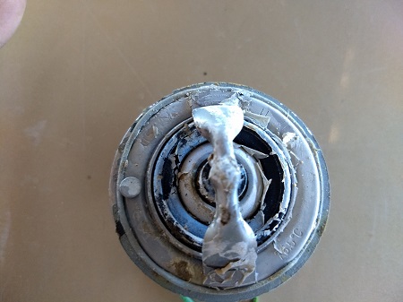

   I've always heard that you cannot mix the red and the green antifreeze's,,,and by golly here's some proof of what happens when you do mix em. When I picked up the trk,,a 1998 Nissan Frontier, I noticed two jugs of the red and the yellow antifreeze in the bed and asked him why,?? He tells me a dude at the parts store had told him it did NOT make any difference which one you used cause engine did not know the difference. In almost the same breath,,,he mentions,,you know the engine had started to run hotter that normal but then the timing chain gave out before he had a chance to look into trk running hotter than normal,,,???
  Well,,I got the bent intake valves replaced and lapped the intakes and the exhausts all in and all chambers held the gasoline test for 5 mins,,,,,,Clap When installing the intake manifold on the head,,,I notice this gookie lookin stuff around the thermostat opening. I remove the thermostat and you can see all the dang gookies just about plugged the thermostat opening,,!!!
I;m gonna try circulating some cooling system cleaner thru the radiator til I'm sure it is not plugged, then do it again when I get engine running and circulate till clean,,,,

LOT of stories about mixing GM DEXCOOL with standard green or long life yellow antifreeze.. DONT DO IT... your photo is exactly the  results I have read about.

What do you suppose caused this? Maybe the same thing?

Yep it gets real gunky real quick. I always make sure I get the universal stuff.
