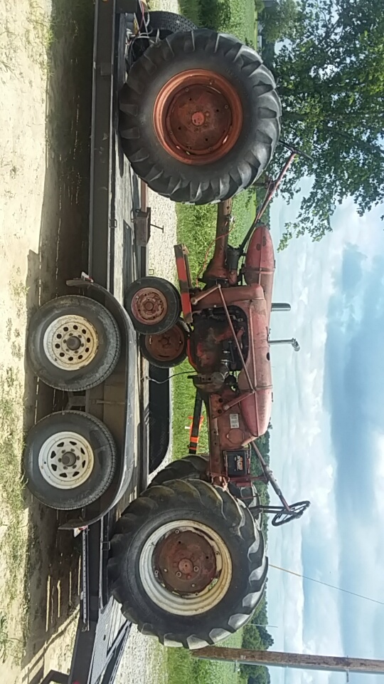

I weigh 260 so that's where most of the problem comes from that and my 8 ply 26s weigh about 150lbs more than 24s. I haven't figured out how to load pictures yet. I will keep trying.
1955allisca View Drop Down
Joined: 27 May 2014
Location: Ohio
Points: 133
Post Options Post Options   Thanks (0) Thanks(0)   Quote 1955allisca Quote  Post ReplyReply Direct Link To This Post Posted: 26 Sep 2018 at 3:10pm
Joined: 27 May 2014
Location: Ohio
Points: 133
Post Options Post Options   Thanks (0) Thanks(0)   Quote 1955allisca Quote  Post ReplyReply Direct Link To This Post Posted: 26 Sep 2018 at 3:11pm
I think I got pic loaded. It's the closer CA.
Points: 5460
Post Options Post Options   Thanks (0) Thanks(0)   Quote PaulB Quote  Post ReplyReply Direct Link To This Post Posted: 27 Sep 2018 at 4:36am
I have to wonder how heavy you drawbar arrangement is. Those tires are probably much heavier than say a set of 13.6 or even 14.9x28’s would be. Other than that, like you say the overload is in the seat😺
