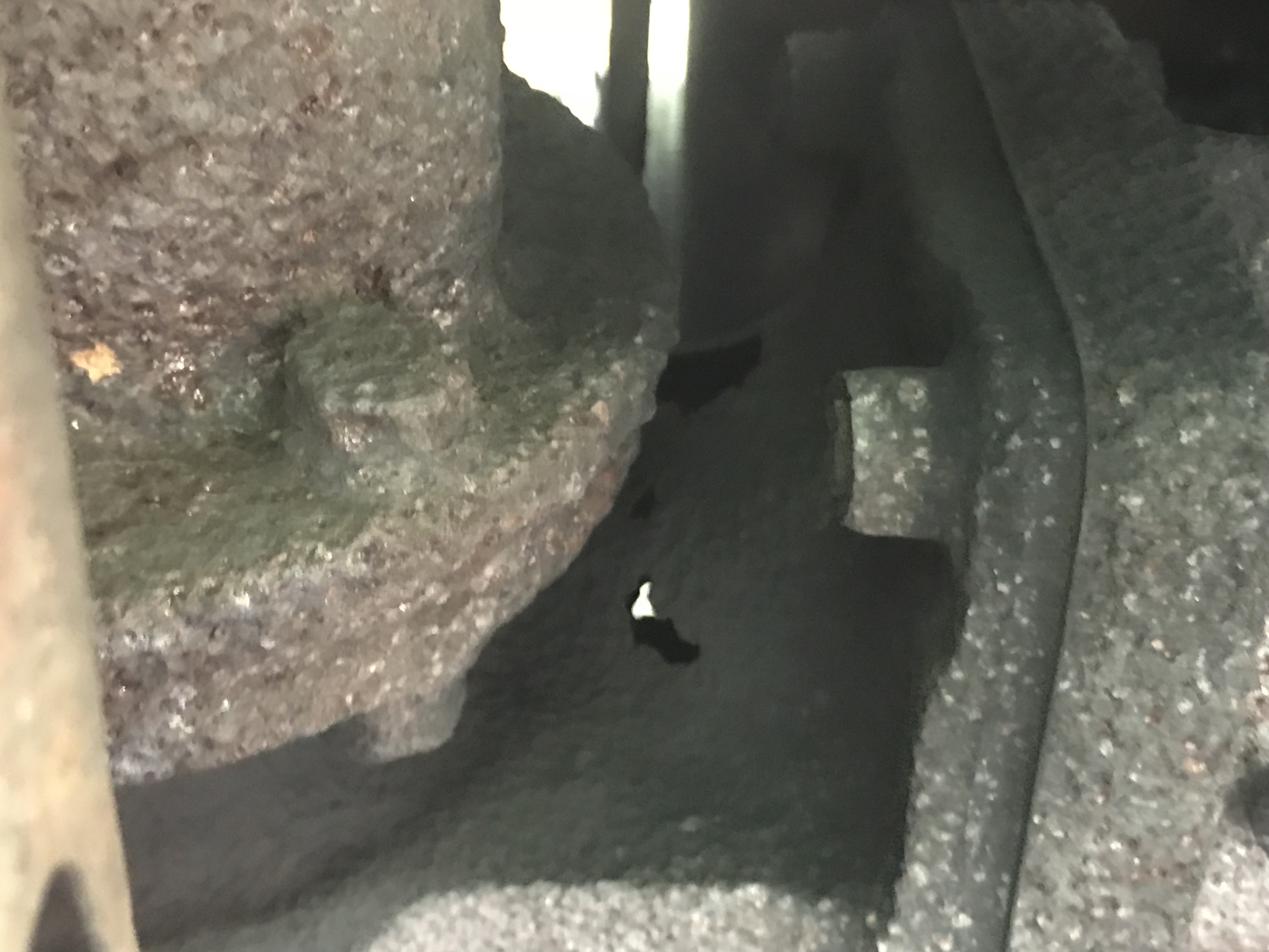

Looks like I am in need of a Turbo as the mounting flange is falling apart.
Need Exhaust Manifold and Elbow
My turbo has a TRW tag on it, but I can't read the numbers that good. I would like a direct replacement so my oil lines all work.

You can replace the housing? Where mine bolts to the manifold is getting holes that I have epoxied.
Along with that I am trying to trace where I am getting oil from, it seems to be coming out of the manifold? So the turbo is leaking?
The Valve cover I can't see a leak there.

Hi I had the same leak on my 190xt I though it was the turbo leaking oil. It wasn't , it was a bad tip on a injector and was running fuel in and not spraying it and what I thought was oil was unburnt fuel .

The oil from the manifold is likely oil coming past the valve stems at low idle. This usually clears up under boost and higher temps... the oil is burnt plus there is positive pressure holding the oil back..
