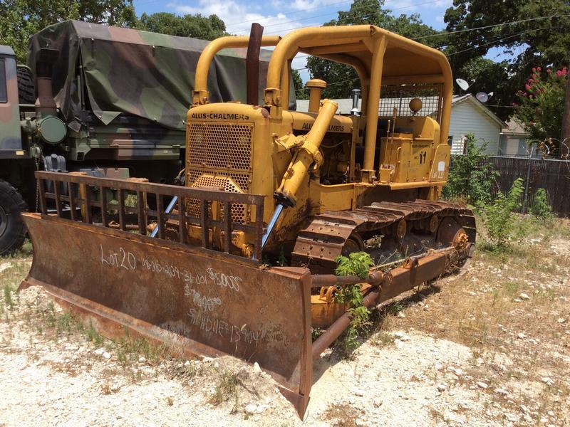

Anyone have any rails and 20” grouser pads for HD11E

Thats a nice looking HD11E.

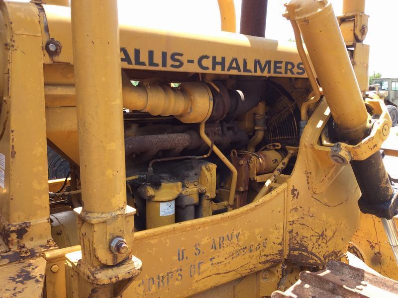

Is a late one too; as has the later air cleaner assembly.

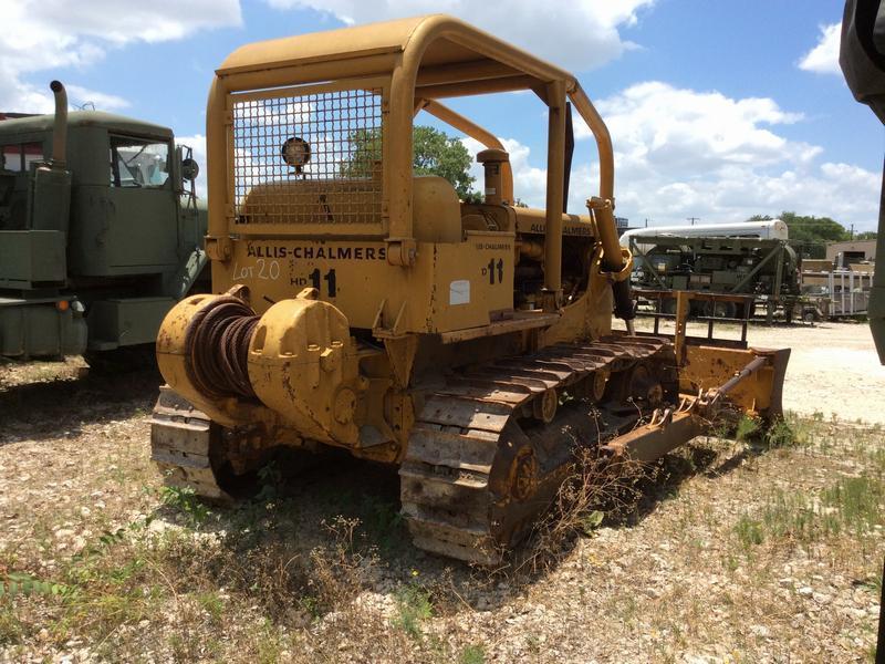

F50 winch too; very nice .

A quick look at the head on photo shows the same wide spaced set of track shoe bolts, this one may have already been converted.

from the look of the grouser height  on your dozer you don't need track shoes  Shoes last several times through track chain replacement  Have a local construction eq dealer measure your  u/c which they usually do for nothing for the opportunity to sell you the u/c.  You may not even need track chains.
