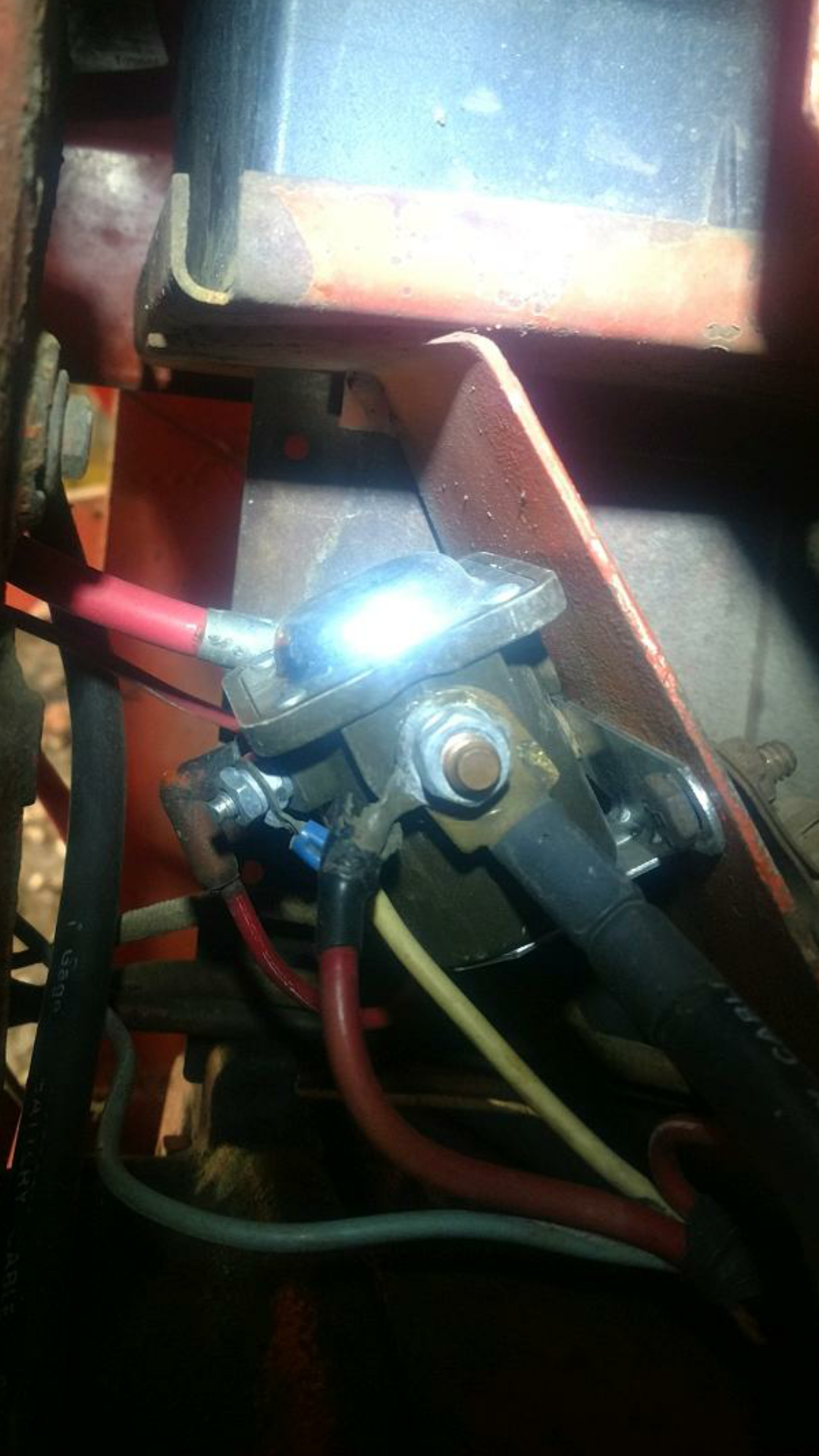

I can't see a part number on it but it was Napa brand and is different from a solenoid that would be considered a "normal automotive" starter solenoid.
Jim Hancock View Drop Down
Location: EL Reno, Ok.
Points: 1112
Post Options Post Options   Thanks (0) Thanks(0)   Quote Jim Hancock Quote  Post ReplyReply Direct Link To This Post Posted: 14 Aug 2018 at 1:33pm
Well Tony, as soon as read "remote" solenoid, my first thought went to a mid 80's Ford.
Wife had an 86 Ford Grand Marquis with a remote solenoid.
How blessed we are by HIS GRACE!
Brian G. NY View Drop Down
Location: 12194
Points: 2259
Post Options Post Options   Thanks (0) Thanks(0)   Quote Brian G.  NY Quote  Post ReplyReply Direct Link To This Post Posted: 14 Aug 2018 at 4:22pm
Sure looks like your typical mid-60s and 70s Ford solenoid.
One of the small terminals probably reads (I) for ignition and the other (S) for starter.
I parted out a dozen 60s Falcon/Comets and a half dozen 60s to 70s Fairlane/Torinos and I still have a few of those solenoids around somewhere.
I used at least 4 in converting WDs and WD-45s to 12 volt negative ground.
Maybe they would work with a positive ground system as well?
