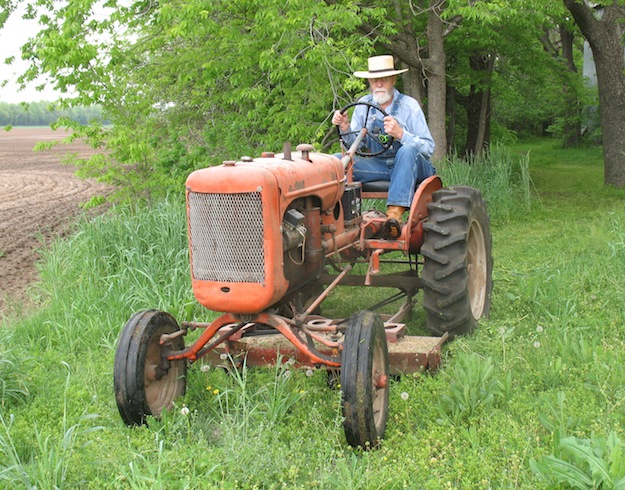

I hope somebody can tell me the correct belt size for this L-59 mower on a Model B. I laid out and measured the old broken belt and bought a 220" replacement. Too short. So I sent it back and bought a new 228" belt. Still too short. Not even close to fitting. If someone can tell the correct length, maybe I can avoid a couple of months of buying and returning belts that don't fit.

I have one, but have not had to change the belt.  I always though it was 226" around the outside.  What hole are push the arms in?  Could the deck be moved back?

I agree with HoughMade. I just bought one 2 months ago and it is 226 inch belt.
As he said...it depends on how you have it set up...what holes you have it on as far as the front and back setting is.   Den

woods # 3652 on ac B  5/8x228 for l-59  check if if the adjustment is front the whole way

 B228 is the right belt. If it is too short you need to unpin the frame where it pivots at the rear and move the deck back until it is long enough and stick the pins back in.

The picture looks as though you have yours set forward farther than I set mine.

OK, I'll see if I can move the deck back. Apparently the old belt was oversized. Thanks, all.

Looks like mine is further back, yet.
