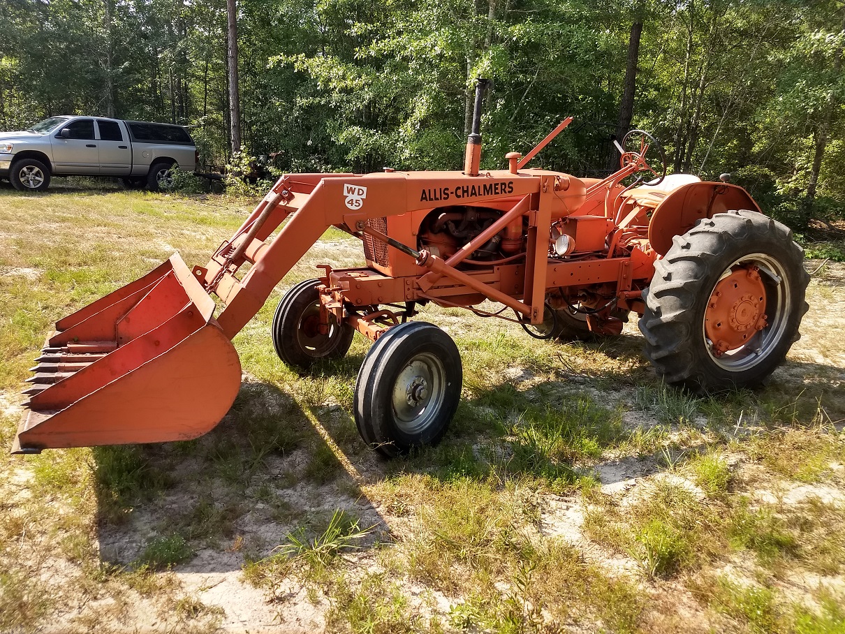

Thank you everyone for the information and advice.   I think I'll just rebuild it. Steve, is there a 12 volt kit online anywhere?
Also, I have pictures of it on my phone now. I'll try and get them uploaded. She's a beaut.
