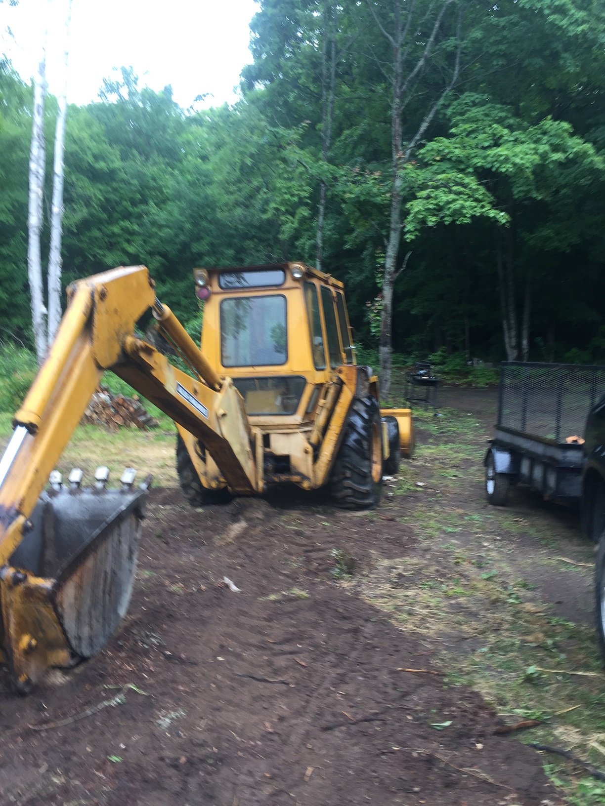

I hate to spoil the party but what you have in the picture is an early 715 from the late 70's. It will have the Perkins 236 engine. The rear end is Ford. 715B had the self leveling bucket and loader control a floor mounted long stick. I've owned both and currently have a 715B. The 715C was the same with the Allis 200 cu.in engine with a turbo. Late 715C were branded CDS, A 715D with have a Cummins engine and be a CDS.
copperhead1971 View Drop Down
Joined: 28 Jun 2018
Location: canada
Points: 24
Post Options Post Options   Thanks (0) Thanks(0)   Quote copperhead1971 Quote  Post ReplyReply Direct Link To This Post Posted: 30 Jun 2018 at 9:13pm
but front bucket lifting cylinder positions don't look like the B or C and pics I have seen would have the 2 one on top of each other this one has one in front of the other.. plate looks like somebody sand blasted

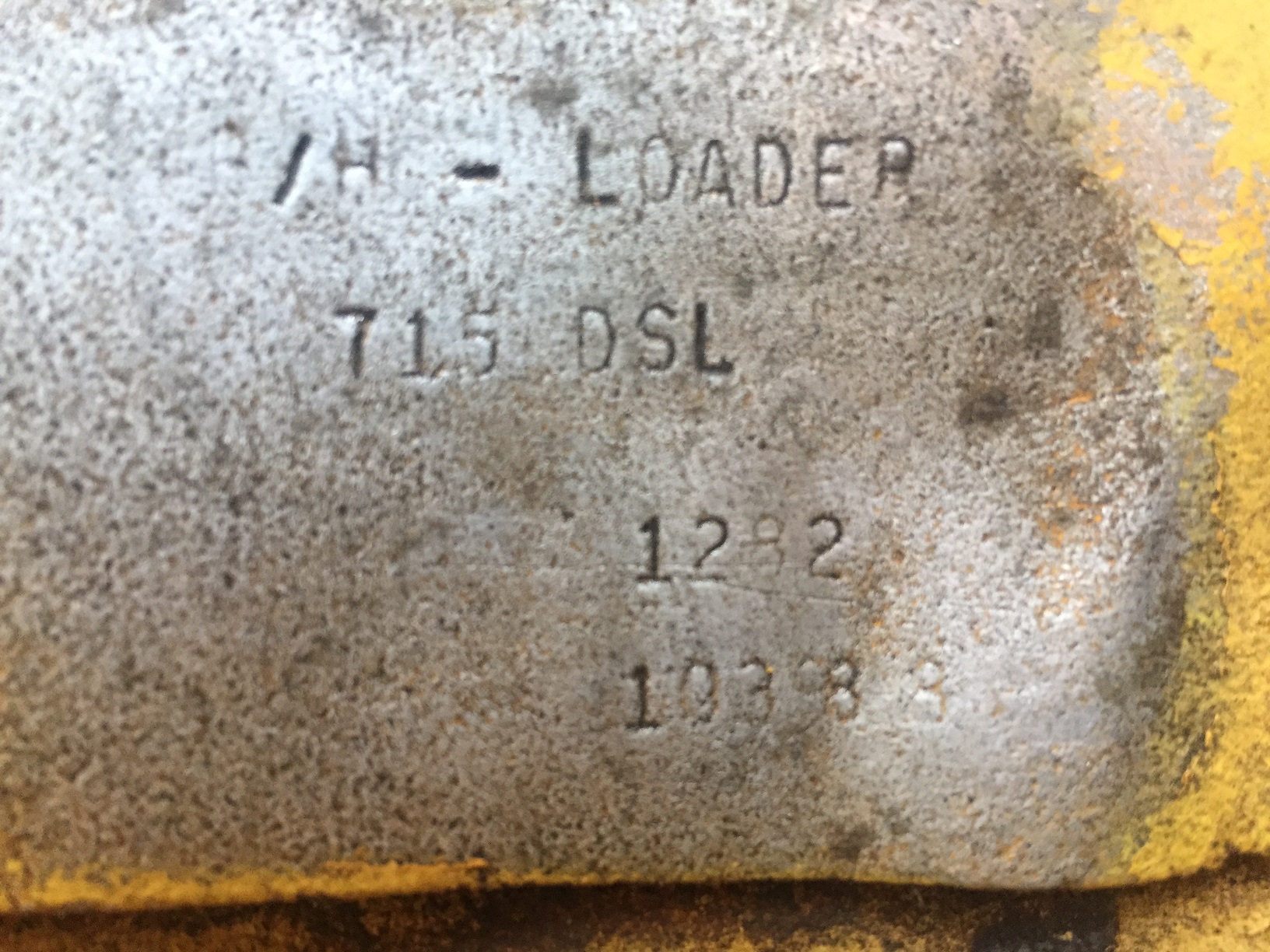

does the plate or id plate i posted make any scents to you?
Calvin Schmidt View Drop Down
Location: Ontario Can.
Points: 4577
Post Options Post Options   Thanks (0) Thanks(0)   Quote Calvin Schmidt Quote  Post ReplyReply Direct Link To This Post Posted: 01 Jul 2018 at 1:02pm
Serial 1282 will make it a 1974 model.
