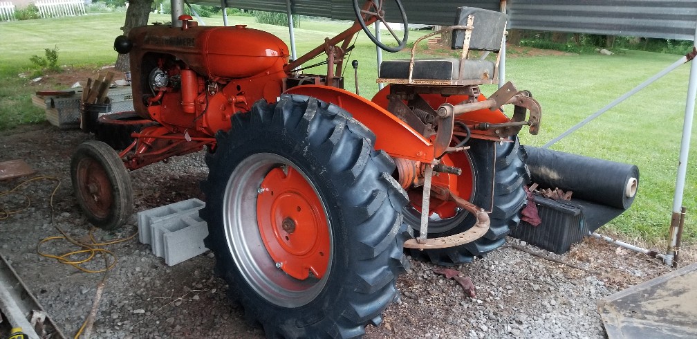

Working on restoring my father-in-law's father's 55 B. So far we have it converted over to 12v and running. Thought we would take it for a short spin today and it wouldn't go into gear. It would just grind. Is there anything we can do, check, clean, lube, etc before breaking it apart?
