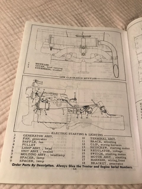

Question, restoring a D10 Series II tractor which had been converted to an alternator with the wiring and such.  I have purchased a new wiring harness but am at a lose for where the original voltage regulator was mounted on the tractor.  I have a Series III which has the voltage regulator mounted on a plate under the generator.  I have a rebuild generator ready to go, but would like to mount the voltage regulator in the "correct" location.  Anybody able to supply / share any pictures from a Series II model.

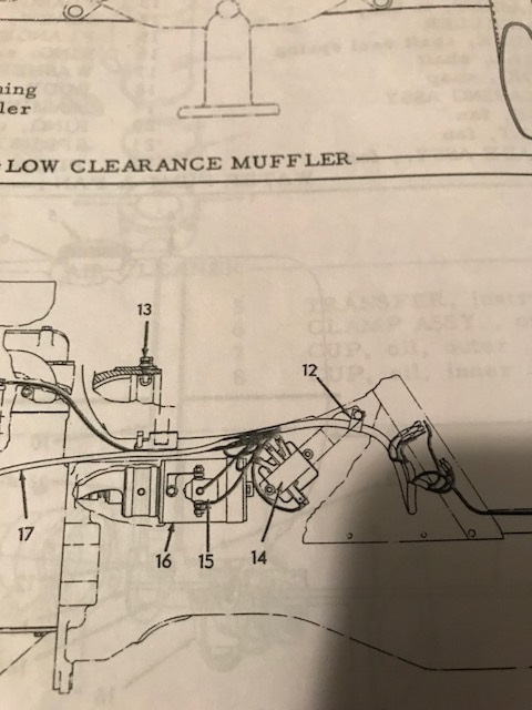

I hope this helps. I've got the book and I can't tell what its attached to.

Thank you, I will start looking in that area as to where the original was mounted.

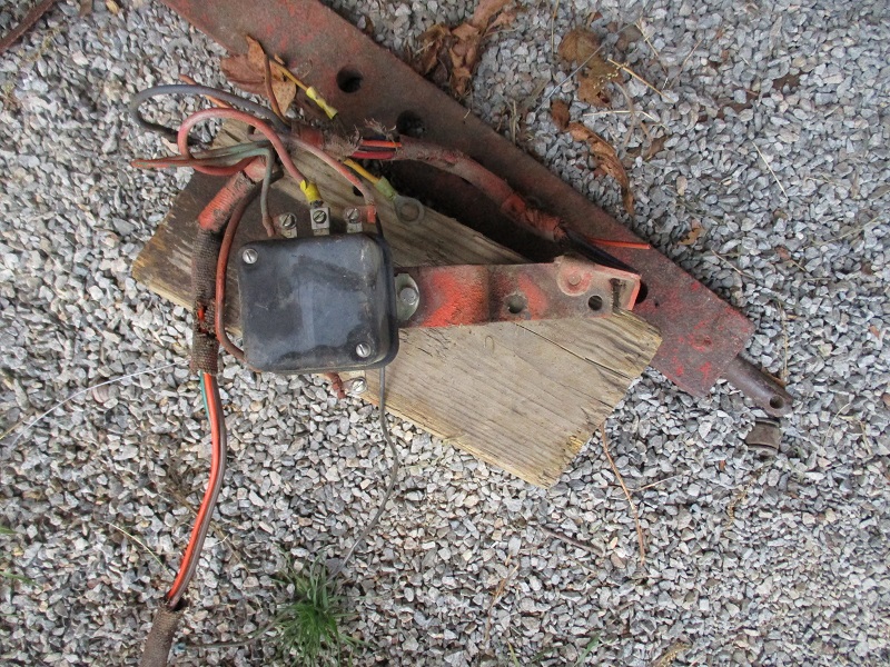

The regulator bolts to the rear gas tank mount.
