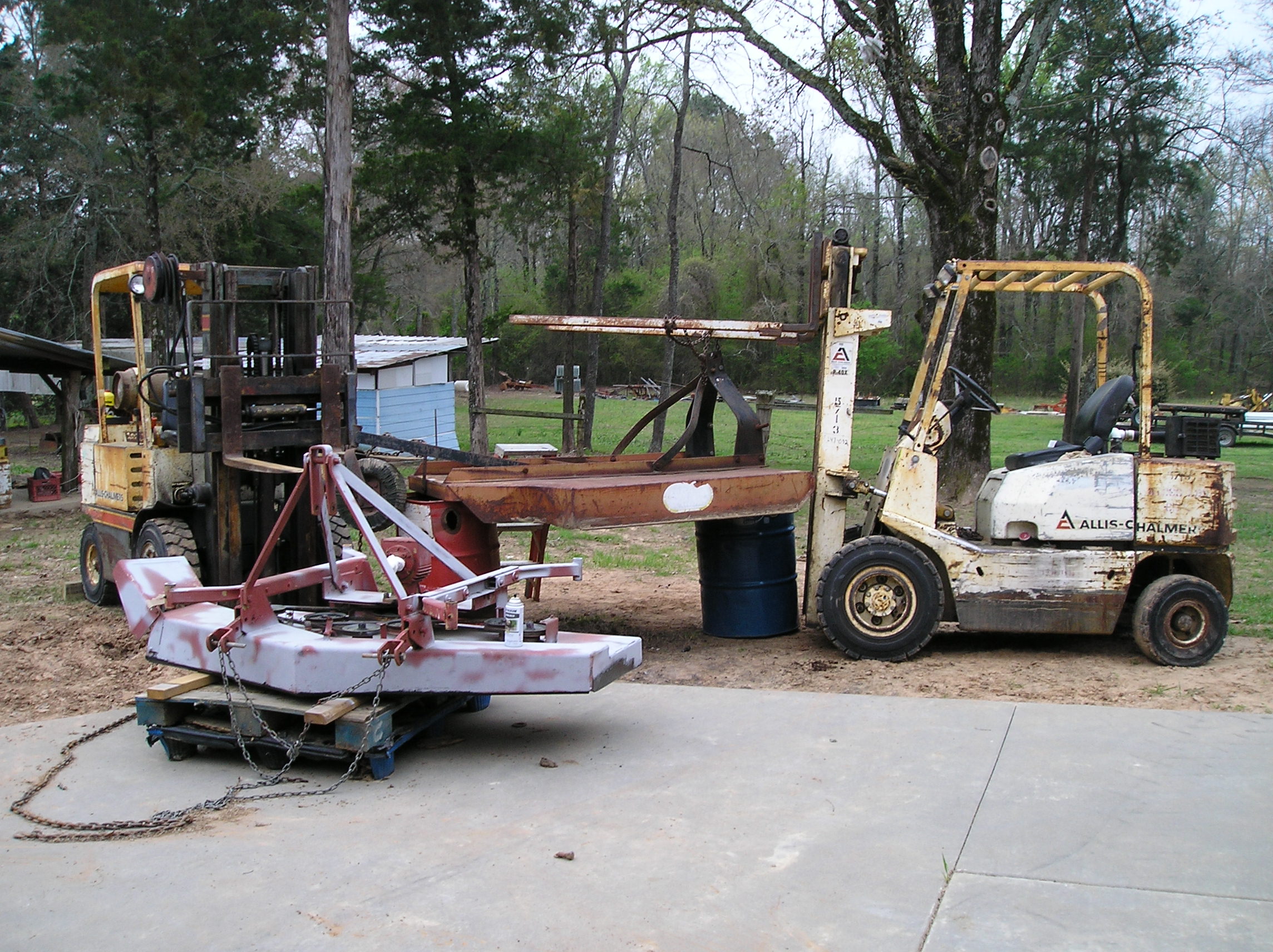

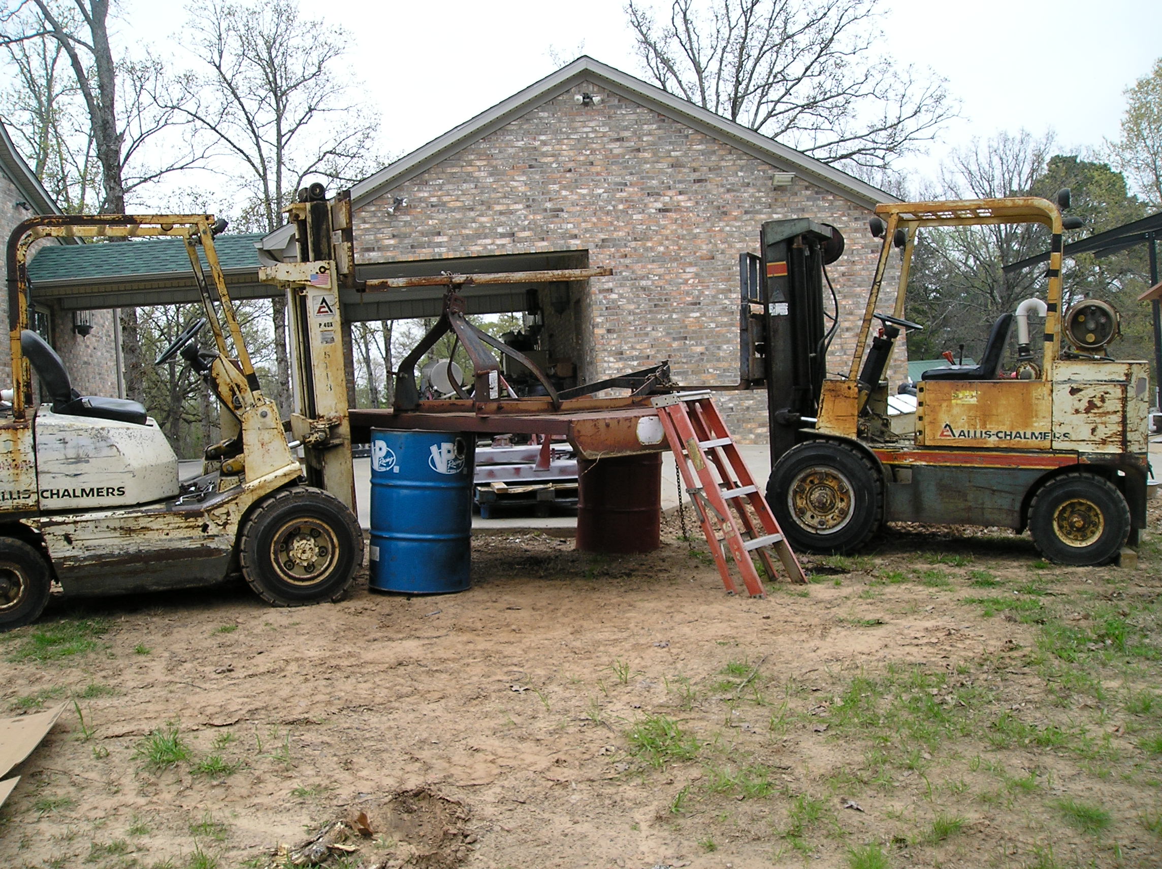

changing bush-hog blades best way I know how

We change them at the farm by lifting the mower from the front and standing it up,with the payloader.  since its a Woods 21' we use the loader to lift the blade assemblies on and off the spindles. it goes pretty fast but you need a 1" impact to get the bolts out. once the blade assembly is on the bench swapping the cutting edges is real easy. my little L306 I stand up with the tractor loader set it on the front edge that way I can stand up pulling the blades and cleaning the bottom. I do it every fall before hanging it on the wall for winter.
