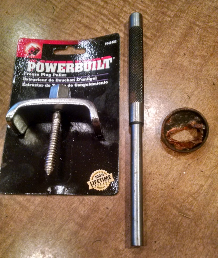

2) Drilled a hole in the center of core plug and tried to use a core plug uninstaller that "screws" into the plug, then pulls it out.  The plug was in so tight, the screw stripped and the uninstaller tool was useless.  Don't spend $9 to buy one.  In theory, it should have been the way to go.  See below pic.
3) Now that I had a hole in my core plug, I had to install a block heater or reinstall a new plug.  I wasn't going to let this thing whip me, so onward with the block heater.
4) I tried prying the plug but the hole had to be elongated to get a pry bar into it.  I eventually made a huge hole and it still wouldn't come out.  I stuck a heavy duty punch into the hole as a pry bar and used a small sledge to hit the top of the punch towards the engine to force the bottom of the plug out.  After many, many strikes, it finally came loose, even though I almost cut it in half.  You can see the result in the picture below.

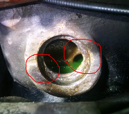

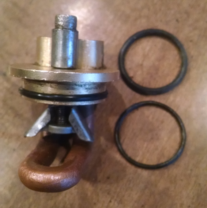

1) The outer diameter of the casting hole is not 1 1/4 inches, but not quite 1 3/8 inches.  This is why the 1 1/4 versions don't fit tight.  This is also why a larger diameter O-ring must be used and sealant.  I purchased a 1/8 inch cross section thickness O-ring and replaced the 3/32 O-ring used on the Zerostart.
2) The inside lip of the casting hole is oblong on my engine.  The wing nut could not be inserted into the opening of hole, it was too small.  I had to carve out two spots in the casting hole slightly below center because the wing nut is not in the center of the block heater either.  I used a drill and chipped out two notches for the wing nut to slide by.  See picture below.
3) As a pre-test, I removed the wing nut and pressed the block heater into the casting hole to make sure it fitted flush to the outside.  Only the Zerostart would fit flush.  The Katz would "rock" in the hole which is why it leaked, even with sealant.  I believe that the rocking occurred because of the thickness of the plug part of the heater.  Also the heating elements seemed to touch the sides of the hole on the Katz, particularly when tightened.

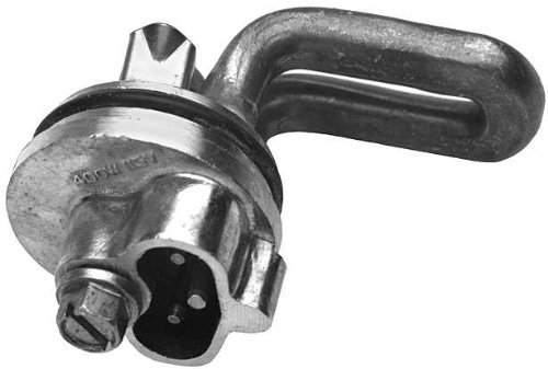

1) The Katz and the Zerostart have the heating element oriented a full 180 degrees in difference.  See below.   For my engine and oblong casting hole, the Zerostart fit better.   For my 190XT, the Katz wasn't a good fit, but it could be a better fit for some other models.  Both are 600 Watts.  I don't want to knock Katz but in my situation, it didn't work.  Katz never claimed to work on my early 190XT either.  Without the bigger O-ring and sealant, I don't think the Zerostart would have worked because it had too much movement side-to-side when inserted in the hole.  The thinner plug body allowed it to sit tight against the block though.  I forgot to take a picture of the Zerostart before installing but here are the two.  First picture is the Katz.  Notice the thicker O Ring I used.
