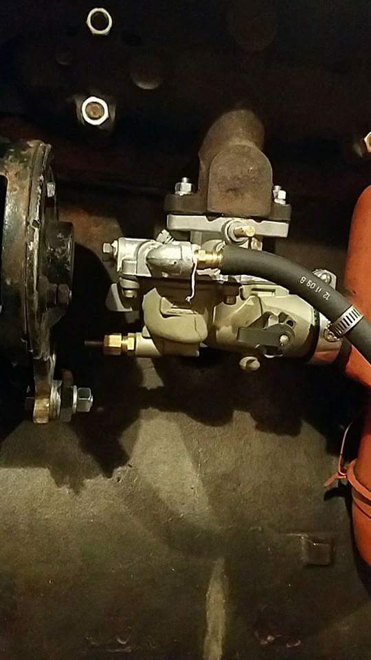

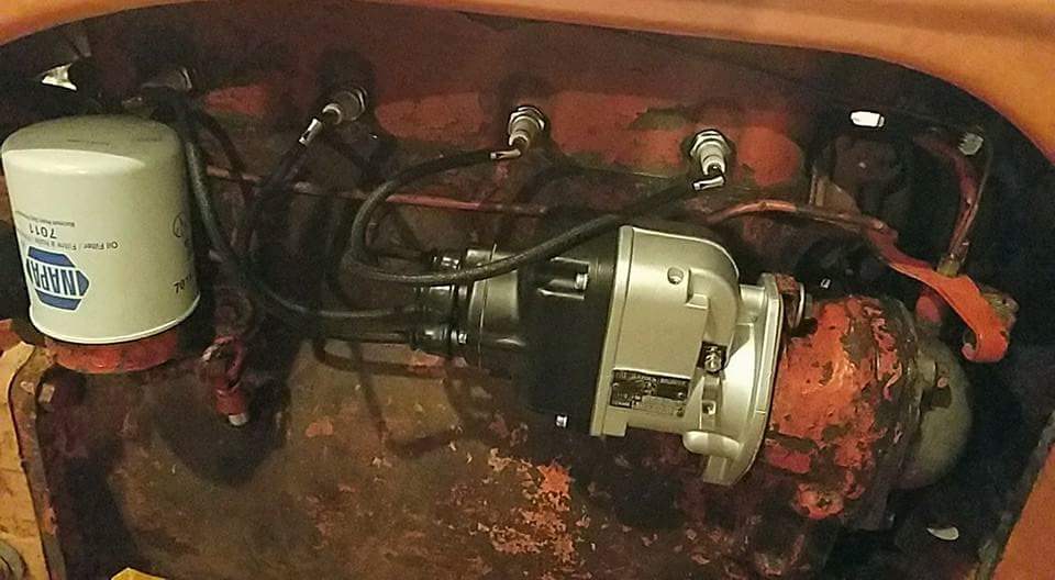

Getting flustered. Got this b back together. Started hard by hand. Checked mag, had somewhat weak spark and was ugly so I bought a reman and put on. Carb was missing, so bought a new zenith and adjusted according to instructions. Engine/mag are in time. Adjusted valves, even swapped out rocker assembly. One I had was in better shape than what was in it. Thought it would start better with the starter. Had that rebuilt. Nope. New plugs and copper core wires.
I have had it running a few times and runs great once running. Quite sure it isn't the mag. Acted the same way with the old one. Maybe the new carb? Ideas? Gas is running out of the carb. I've tried choking/not choking. Stumped. Not a mechanic by any means, but thought I had a basic understanding until now......

Also, had good gas flow from tank/bowl and can smell gas when cranking. Gas will run out of the bottom of the carb after cranking a bit.

'gas running out of carb'... NOT a good sign, great clue...
she's royally flooded ! I suspect a sticky needle valve or binding float( won't close). The B guys will know the specs..since it was running idle + mixture screws should be OK, but best to confirm( +- 1/2 turn is OK for starters...). maybe look for a burr or 'something' that won't allow float to shut off the gas.
I'd blow out all the accumulated gas in the manifold, pull plugs, either turn over or blast compressed air into plug holes. blow off plugs if wet.
My one D-14 will flood..even with the sediment bowl valve 'off'...so you're not alone...lotsa help here !

I really didn't want to open up a brand new carb, but guess I should. I just kind of assumed/hoped the new stuff wouldn't need tinkered with lol

My advice would be to take the wooden handle of a hammer and gently tap on the bowl of the carburetor before you start cranking. Sometimes if carbs sit on the shelf in inventory, I've had the floats stick. Sticking can cause gas to run out, like you observed. Most of the time, a good tapping will loosen things up, and the carb will continue to operate well. If that doesn't work, report back and the next step may be removing the bowl and inspecting the floats.

I had problems with a new carb as well, and didn't have the sage advice of Creston (thanks buddy, learned yet something else new from you here) to gently tap, so I took it off, separated the two halves and just diiddled with the float.
put it back together and it ran fine.
but with another one, what I found was the little shut off needle that the float assembly pushes up was what was stuck,
so I just shook it loose, wiped it off, put it back in and verified that it would drop and also slide up freely.
no problems since.

Also, get rid of the rubber hose between the tank and carb.  You can buy a 1/4 inch brake line at NAPA and corresponding fittings for the sediment bowl and carb.  This is what I have always used.  I agree that it sounds like you're flooding it.  Float is either stuck or improperly adjusted.  We've all been there.  Good luck.  Keep us updated.

How is your compression? How did you time it?
It takes proper mix of air and fuel, compression and spark at the proper time to start and run.
To check your time you can slowly crank by hand and the instant impulse snaps and you have spark at number one plug you need to have the TDC or CENTER line in the center of the inspection hole on the compression stroke.
If you have a timing light and the tractor is running at high idle you would need to see the FIRE line in the center of the inspection hole.
I don't know what your carburetor setting instructions are but when setting your carburetor after you are running you need to first set your idle. The idle speed is set with the stop screw on the back of the carburetor at the throttle lever. The idle screw sets the fuel air mixture to cause the engine to run smooth at the speed setting. The stop screw and idle screw needs to have slight changes as you slow the engine speed.
After you have the idle screw set you then open the throttle to full speed. You then adjust the power jet to get the fastest RPM's the engine will run. At that point you turn the power jet screw in until you notice a slight slowing of the RPM's. That will give you the best setting you will get without using a dyno.
The above settings worked in the 1950's when I was instructed and it still works in the 2000's

Quite sure timing is fine. #1 Is tdc when center mark is in the window. Also checked the valves to make sure. I'll play with the carb a little more. Hopefully it's something that simple. Will also double check plugs.
The timing is where the spark jumps when #1 is at TDC.  My suggestion is to static time the mag so that the rotor arm is pointing directly at the contact for #1 spark plug wire when #1 is at TDC.  It's not just piston to flywheel...infact those should always be lined up.  the key is mag to piston timing.  Once you get it started, you can twist the mag a bit at a slightly fast idle to see where it runs the smoothest (tuning by ear), or run it up to operating speed (so the advance is all in) and use a timing light to set the spark to the "Fire" line.

Pointing the rotor as you say works on a distributor. Not with a magneto. The clock spring spins before the rotor points to the terminal and then the rotor goes past the terminal. It happens quickly and if you move the rotor a tooth or so yo get it to point at the rotor at TDC the spinning of the armature would make the power after the rotor was past the terminal. Clear as mud I bet.
