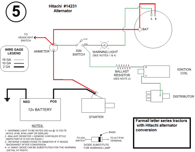

Assuming you have an original 6 volt coil, add an ignition resistor between the ignition switch and the coil. Not all ignition resistors are the same. The resistance values vary greatly. I usually use a resistor with about 1.4 ohms. The proper resistor should give you about half the battery voltage at the coil with the distributor wire grounded.
I prefer a 3-wire alternator which insures alternator "turn on".
A 1-wire should work as well, but you may need to rev up the engine to get the alternator  to turn on.
In an automotive application, the alternator operates at a much higher RPM which gives a quick alternator turn on. In an Allis G, the alternator RPM will be much lower.
Not all alternators are the same. Some alternators are equipped for a lower turn on threshold.
I prefer the 3-wire because the ignition switch provides the turn on for the alternator. In tractor installations, it is usually really a 2-wire installation. One wire on the alternator determines the point of regulation in the circuit. This is often just jumpered to the alternator output terminal. The other wire to turn on the alternator is excited by the ignition switch through a diode, idiot light or resistor. If wired directly, the alternator will back feed after the ignition switch is turned off and the engine will keep running.
If using an idiot light or resistor, the amount of resistance will affect the alternator turn on. The more added resistance, the higher RPM to excite the alternator. IH tractors used a 25 ohm resistor. If using a light, select a bulb which is used as an alternator idiot bulb. A diode will provide the most optimum alternator turn on.
