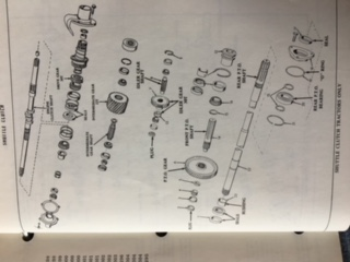

With the shuttle clutch the PTO will spin backwards when you use reverse, also it will not run at the standard 540 RPM.
Incorrect, the PTO runs the normal direction without respect to the position of the shuttle clutch lever however it does run at an odd RPM
Fred in Pa View Drop Down
Location: Hanover Pa.
Points: 9210
Post Options Post Options   Thanks (0) Thanks(0)   Quote Fred in Pa Quote  Post ReplyReply Direct Link To This Post Posted: 17 Jan 2018 at 9:11am
Butch , that is correct ,these 3 shaft's  (top  hollow  and solid ) (lower PTO Drive )never change direction when moving shuttle leaver forward or backwards
nonetheless ,still dead.

Here are a few pics from a 615 manual
Edited by JoeO(CMO) - 17 Jan 2018 at 9:57am
