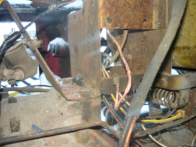

hmmm should this wire be like this?

had a bad wire to the ingition switch on the d17 so I thought I'd replace it. in single digit temps?  when I pulled the crap off the wires I found this bare copper wire going from the selnoid to the alt meter.....it's bear for about 8 inches....glad the old gal didn't catch fire!!! every wire I touch the insulation just cracks, looks like I'm fixing more than one wire...

If that wire is bare because the insulation hardened and cracked off, I’d replace all the wiring. That doesn’t look like OEM wiring.

OEM, nope, the one piece I replaced already was old cloths line.  the green stuff with metal wire in it?

Looks like it's more than time to order a new wiring harness from Steve at B&B.!!
Points: 24778
Post Options Post Options   Thanks (0) Thanks(0)   Quote jaybmiller Quote  Post ReplyReply Direct Link To This Post Posted: 27 Dec 2017 at 11:27am
gee it's only 50,60 years old ! should be in better shape, though at 64 I have to admit I ain't as flexible as I once was.....
yes, replace 100% of the wiring, she'll purr like a kitten and be good shpape for the grandkins to fight over !

Hooo weee! There's a fire ready to happen. As the guys said, better change all the wiring in the Tractor. Its overdue.

When I put a battery on the WC after swapping the motor out I saw an orange glow under the fuel tank where all the wires ran to. Pulled off the feed wire to the starter that went to the gauge. When I took the tank off and looked at the wires there wasn’t any insulation left on any of the wires. One big short. As stated above it doesn’t take much wire for the old tractors. To replace every wire.

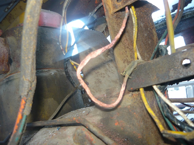

spent all day yesterday going out to the tractor, take a wire off, into the garage and cut the apropriate color/gauge wire, run into the house warm up, put ends on wires, back to tractor, install wire, take off another wire....over and over again!!! as I said it was single digit temps...today 10-15 below with wind chill....most of wires are replaced, probly ain't doing any today...
the d14's wiring is really good condition, I guess it musta had a better life...2 years must make a huge differance...lol the d14 is a 1960, the d17 is a 1958
edit:  2 of the wires were black taped from one end to the other, no insulation at all.. bit off topic, but funny. A friend bought a dodge demon that was rewired...all with the same color wire...lol

That looks like household Romex wire.  Certainly not what you want on a tractor. Get a spool each of several colors of automotive wire. #14 should be good for everything other than the alternator/generator circuits.
