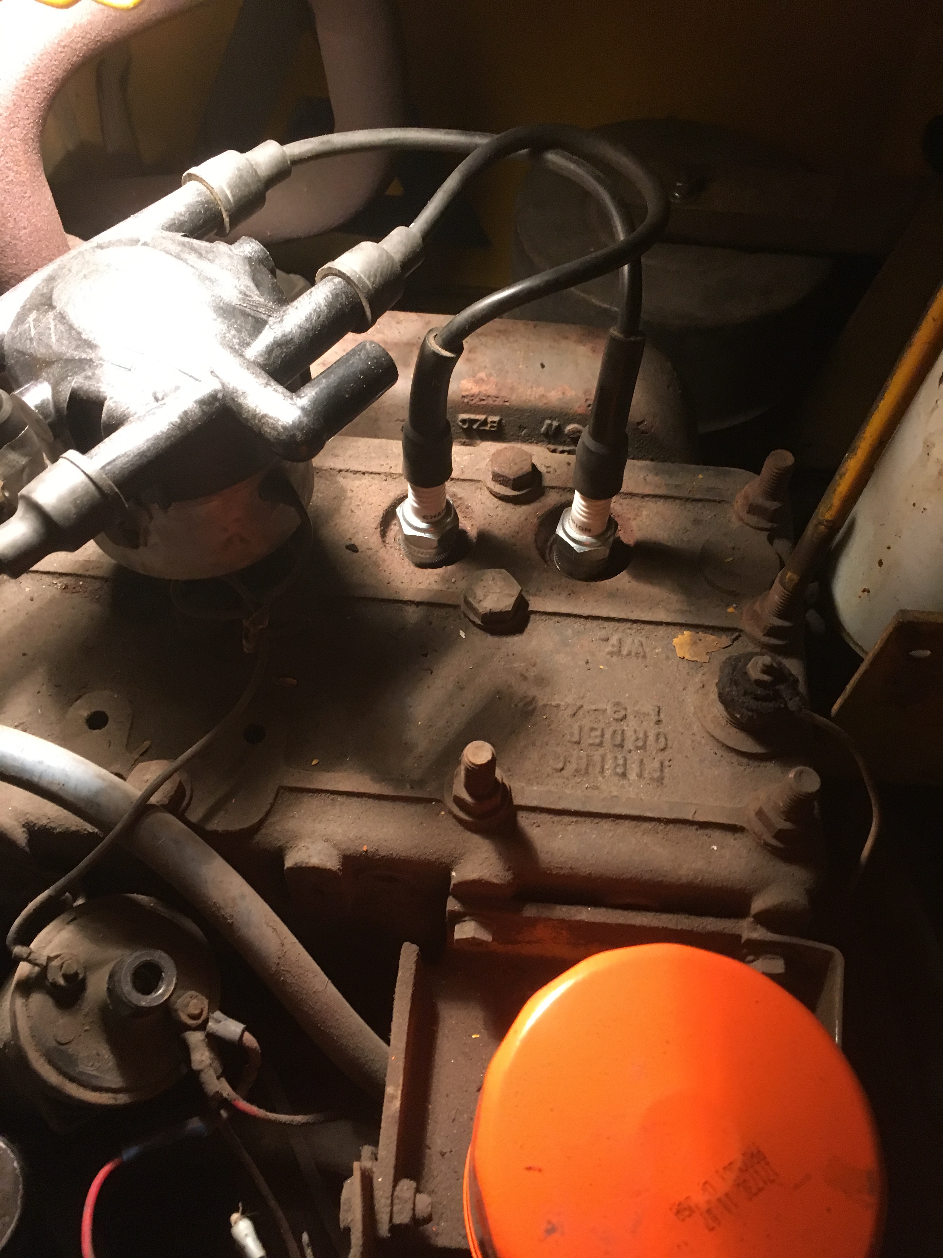

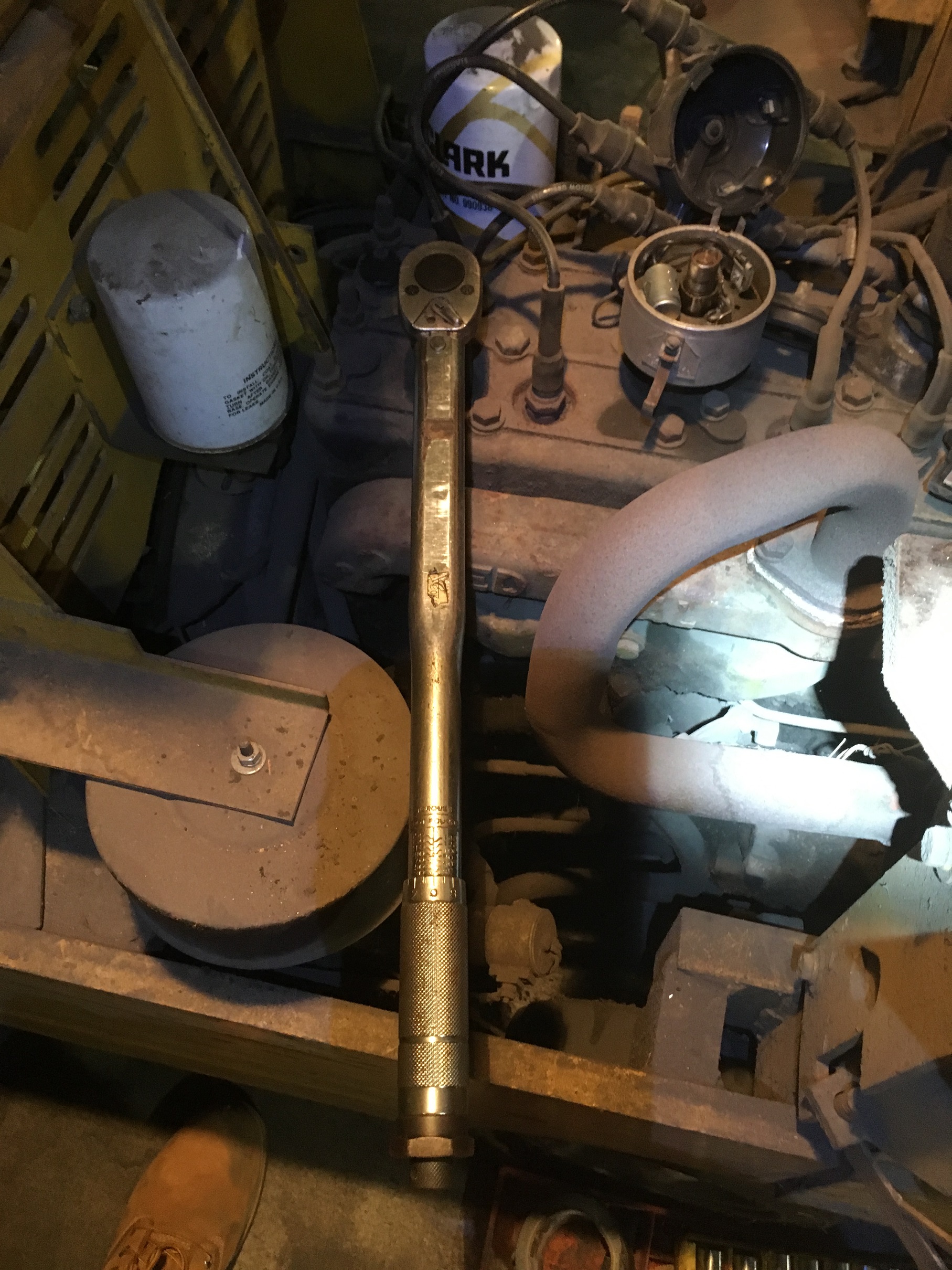

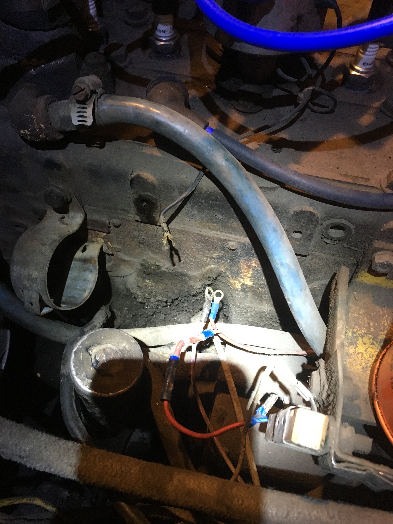

Thank you, DMiller. Let me try uploading some. I only have partials of the engine, as I worked on it over the last couple of days.

Oh, there is no side play on the shaft. It is rotational play; I can advance the cam to almost fully open the points with its tip with the ignition. Then, I advance the shaft by hand a tad (rotation-wise), and the tip of the shaft's cam gets right under where it is supposed to go to give me maximum points' gap.

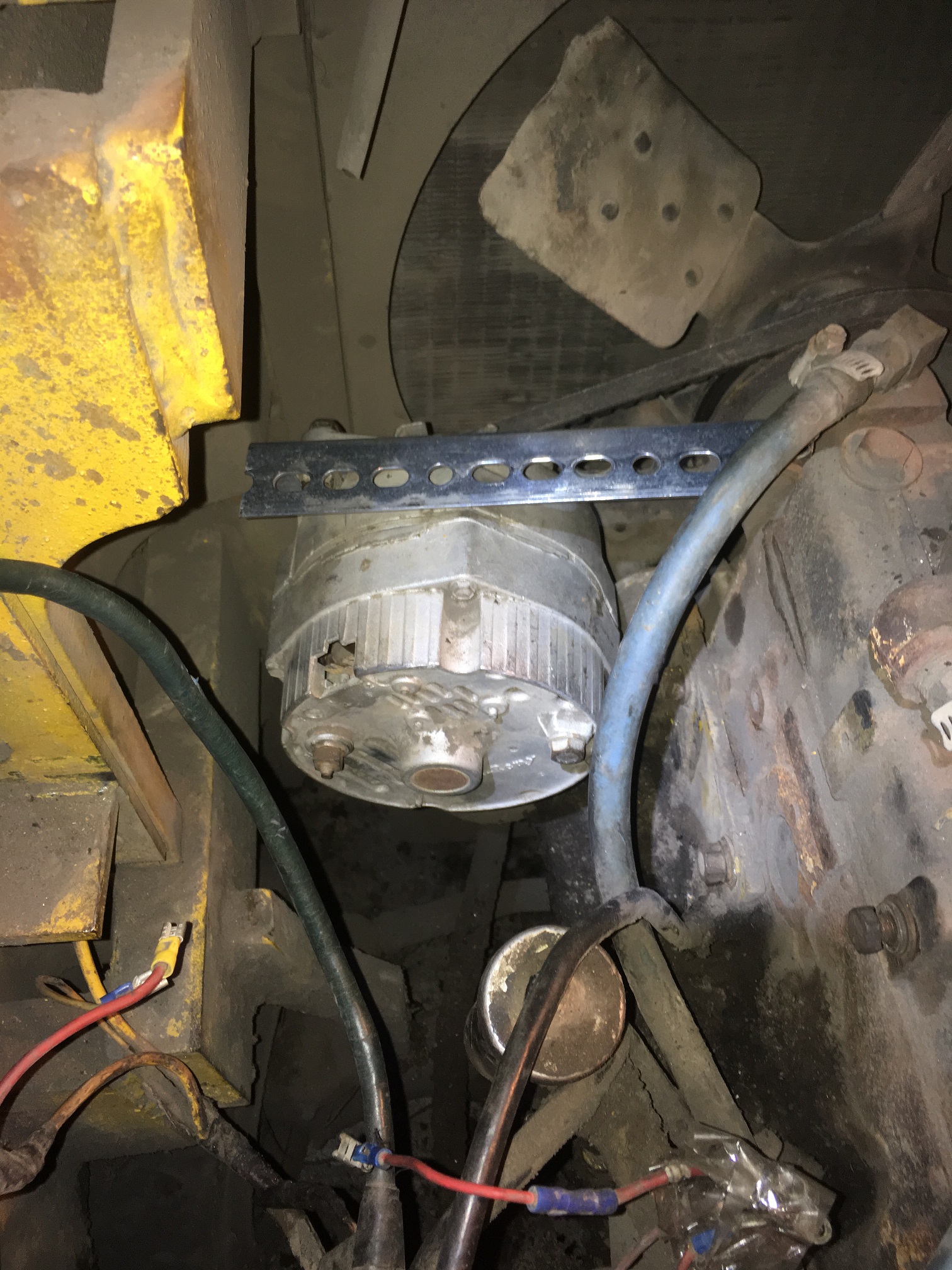

Here is one looking toward the back. Also, that is the alternator's top mounting bracket I had to fabricate, since OE was not anywhere to be bought.

Never mind, finally got moved over on the first photo. That style distributor first remove the points and condenser, there will be two or three retainer screws for the points plate to the dist. body. Remove that plate and then take a photo, will be obvious once is opened up. When you put the photo on your computer resize it to 1/4 of the existing size and save as an (A) behind the original number, then you have two photos but will fit better in here.
