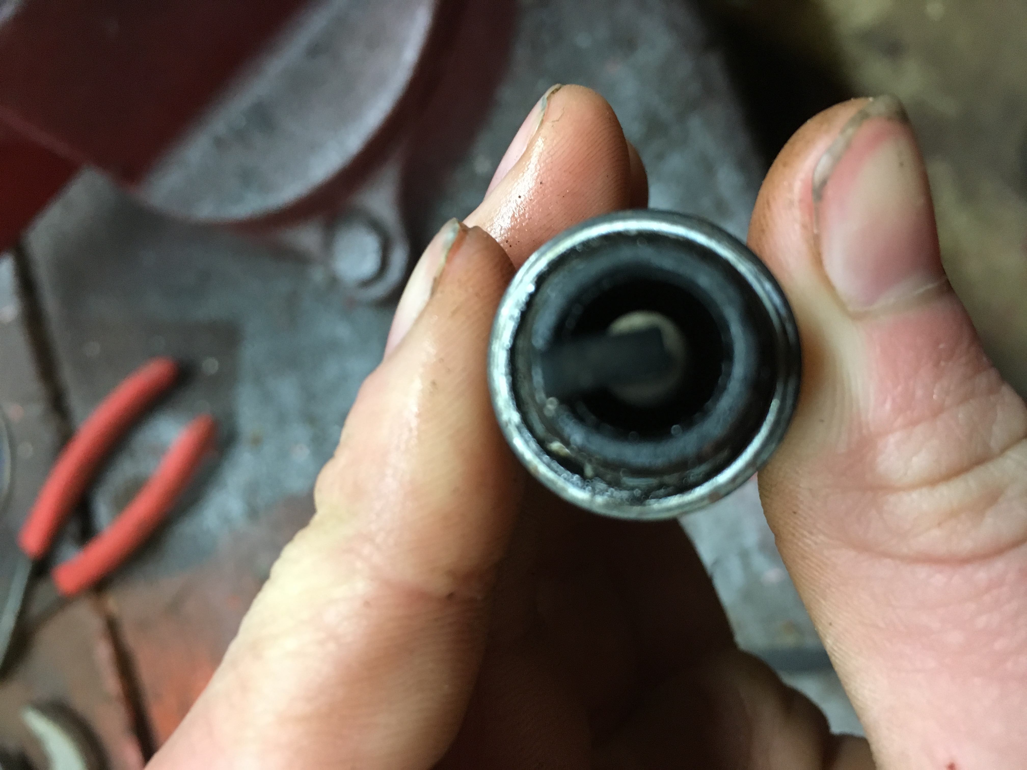

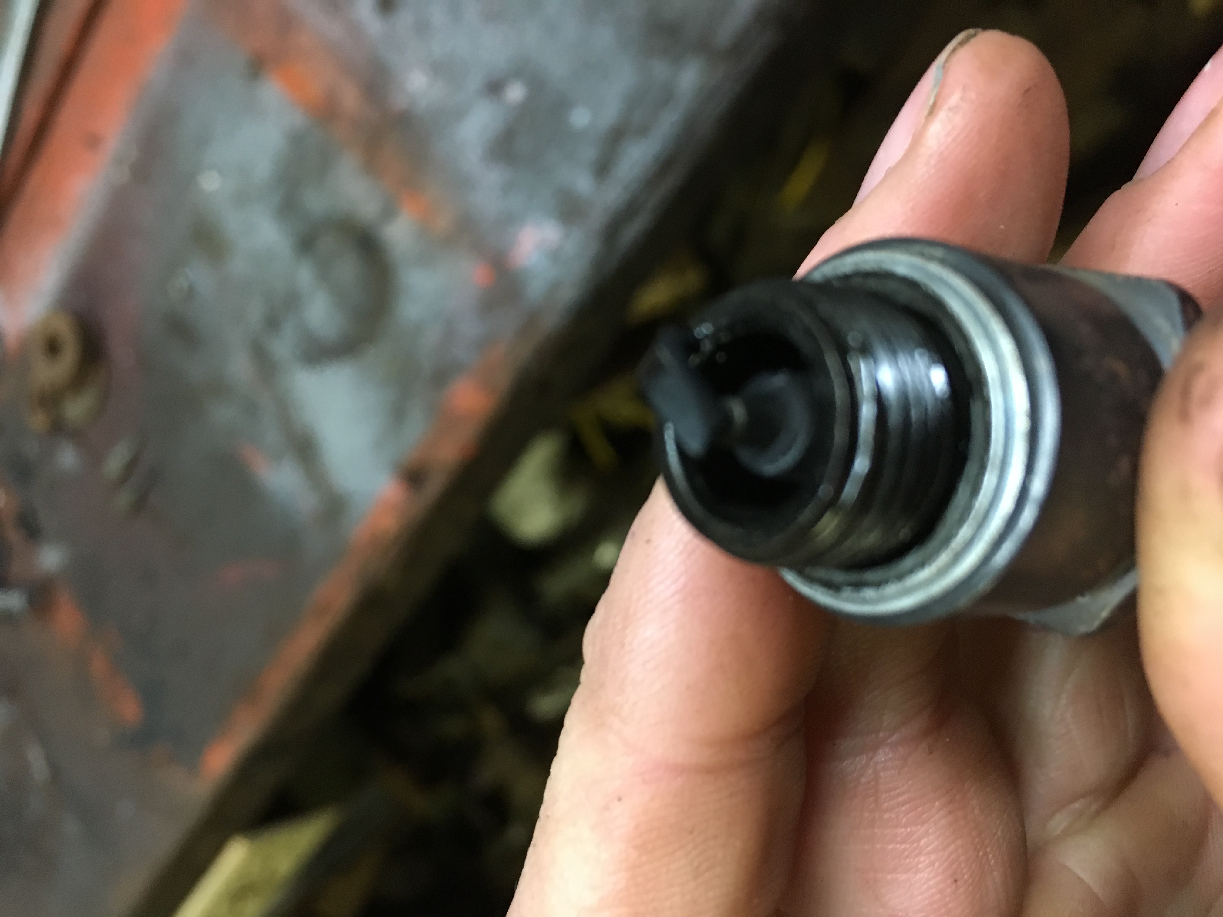

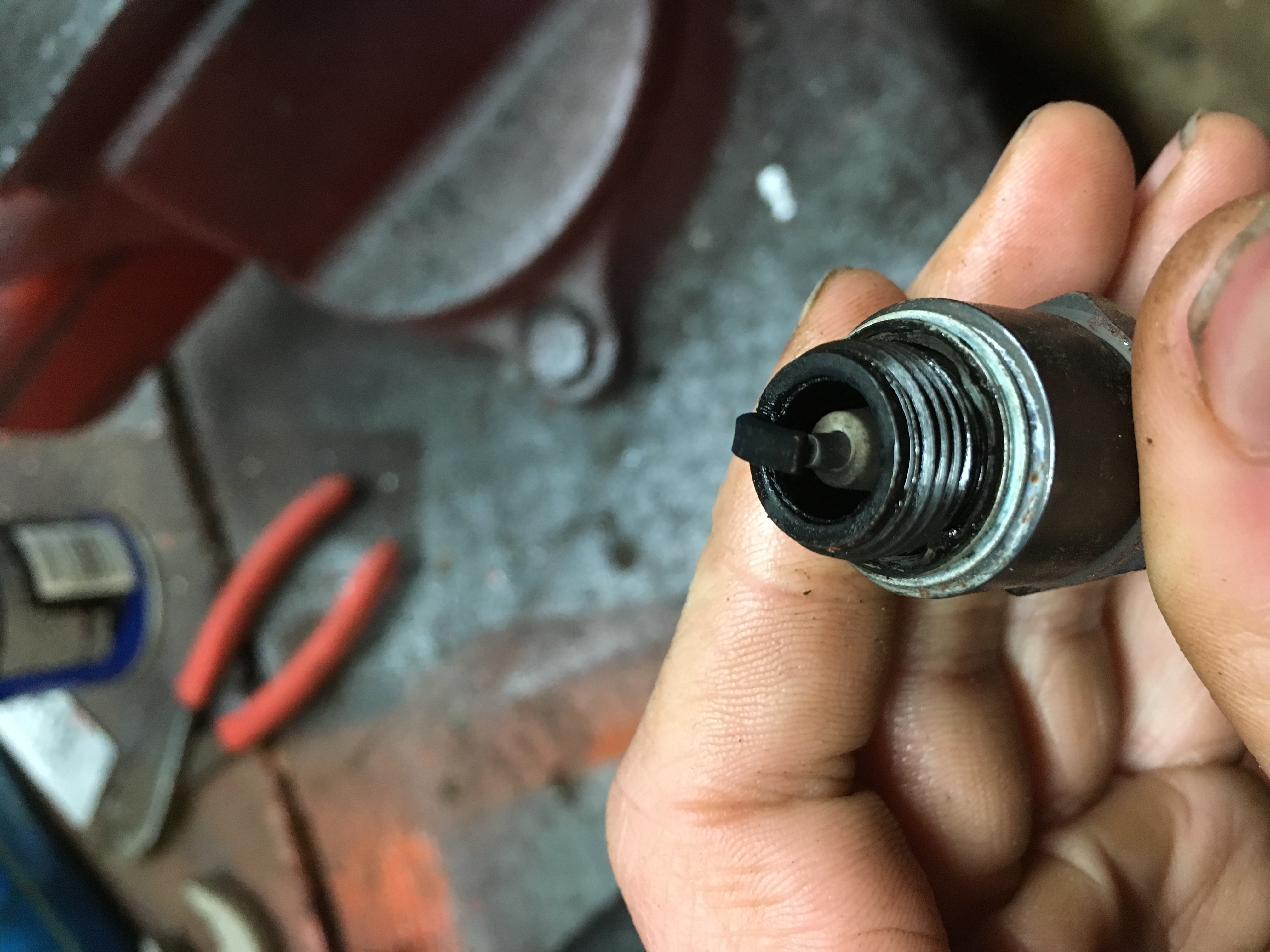

This is proubley a dumb question. But I moved my wd45 inside tonight and it was popping faintly out the exhaust, and I thought maybe the plugs were fouling. Do these look like it’s running too rich or oil fouled.

If they are dry then it's running rich.  If wet then it's oil.

There pretty much dry they weren’t soaking wet in oil.Tractor runs fine though and don’t smoke could it still be rich.

If they are dry then probably not rich. Color is important. Should be sort of tan color. If sort of dark or black then could be a bit rich. many of these units now don't do much except idle around or pull small trailer so spark plugs may not look the same as when the motor is worked hard all day. Very hard to see on those huge pics - what I can see looks okay.

Look normal for a occasional use machine.

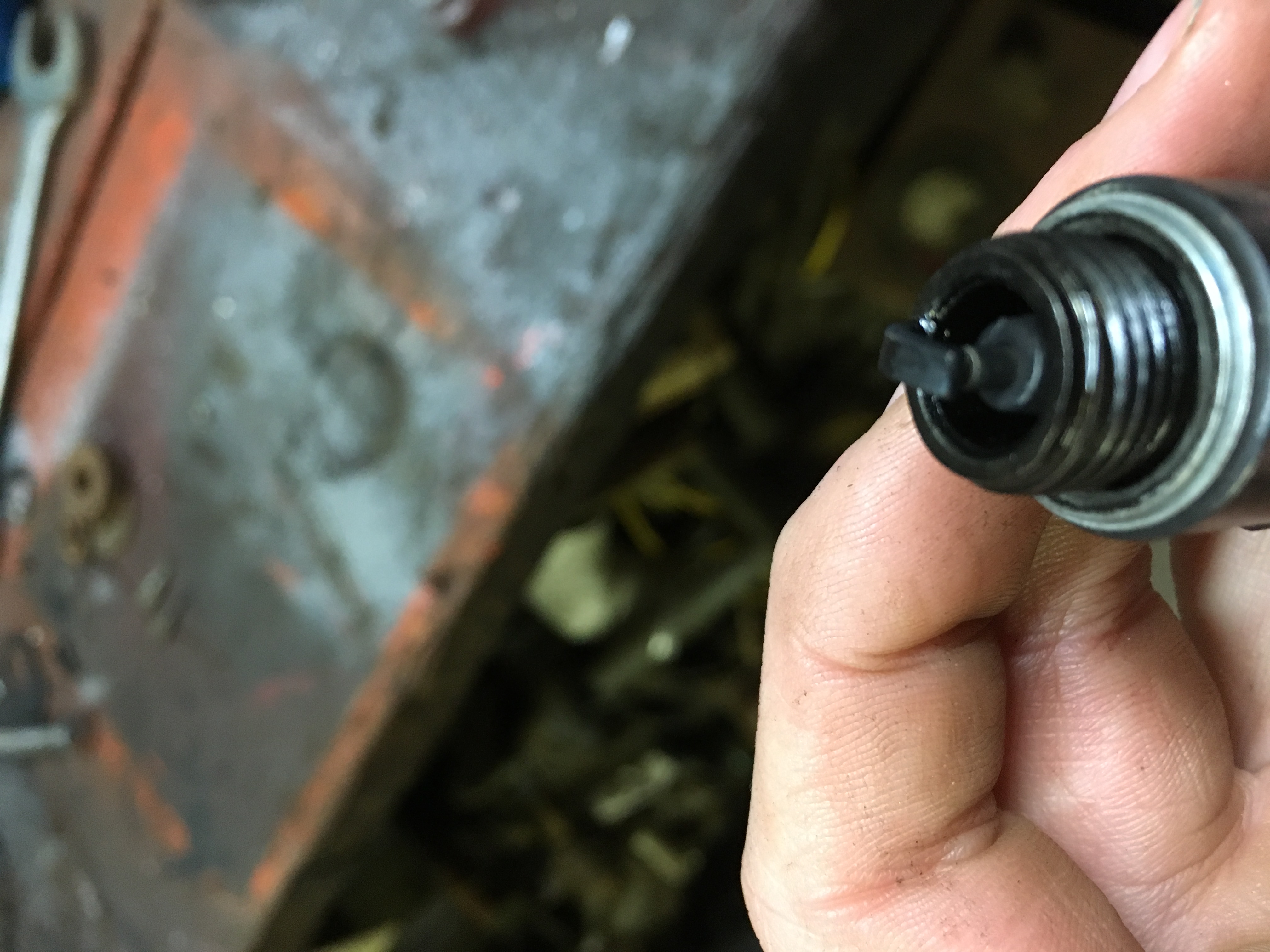

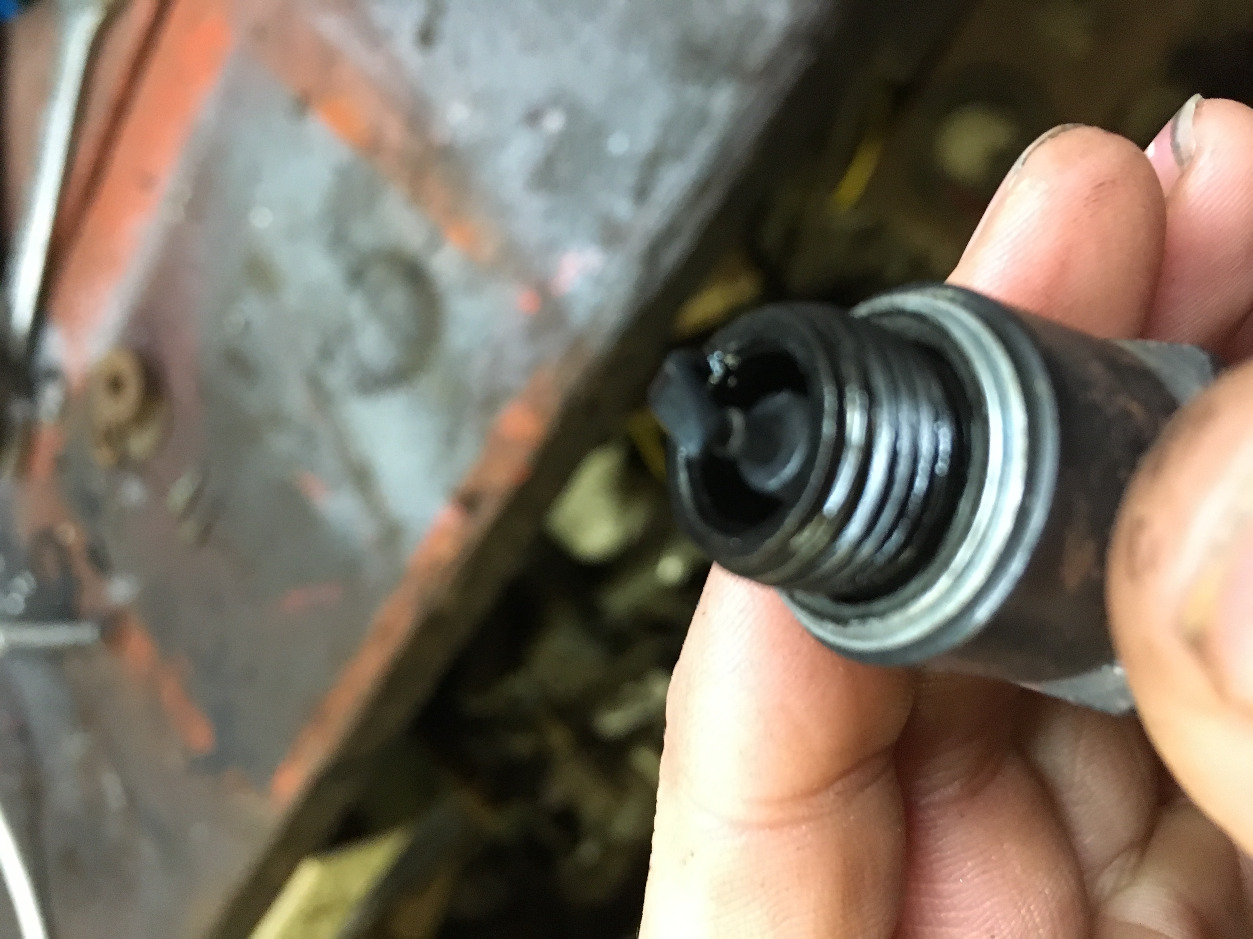

Yea those huge pictures were not good. The resized one looks about normal. These old tractors will run when lots of things are bad, worn, dirty, missing, wet, corroded, rusty, and oily too. :)

Sorry about those huge pictures I didn't realize that until I logged in on my computer I've been posting from my iPhone and they looked fine.
