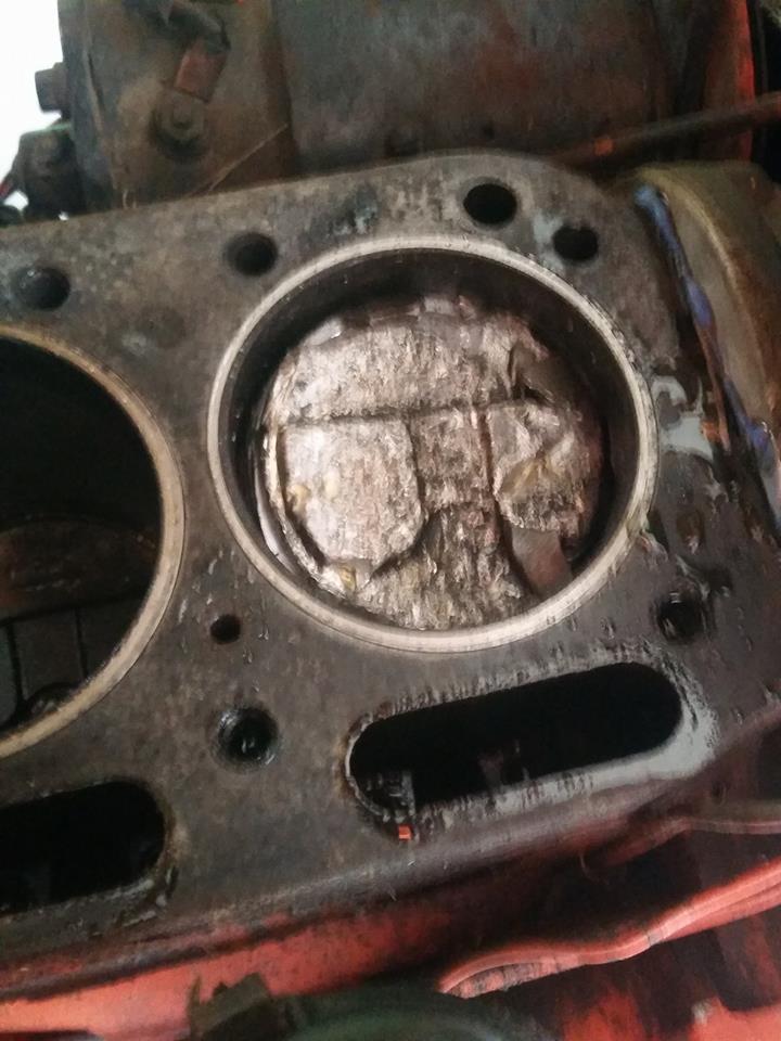

Well...it was a good run.
I rebuilt the D-14.  Had it running great!  Bush hogged my property twice this year.  Moved stuff around the farm, etc.  And then it happened....
Yesterday, I shot a deer back in the woods.  Took the tractor down the hill to get it.  When I got to the bottom of the hill, it sounded like it was "missing" out.  Maybe a fouled plug, but then it quit.  I had been having issues with the spark plug wire grounding out on the block, so I didn't think much about it.  Loaded the deer on the back, and went back up the hill.  Again, started sounding like it was missing, and quit running half way up the hill.  Odd....
So I sat for a couple seconds, and started it again.  It fired right up, only this time it belched out a HUGE cloud of white smoke out of the stack.  Not good.  I got it to the top of the hill (20 yards) and I shut it off.  When I went to start it back up, it wouldn't even turn over.  Almost like it's locked up.
Fluids all checked good.
It looks like another rebuild is in the books for the ole girl.
Sure wish I knew where to start.
That's my luck though....
Edited by squirt239 - 18 Dec 2017 at 1:45pm
Points: 24767
Post Options Post Options   Thanks (0) Thanks(0)   Quote jaybmiller Quote  Post ReplyReply Direct Link To This Post Posted: 20 Nov 2017 at 2:19pm
white smoke generally means some water in the cylinders...maybe a blown head gasket , busted sleeve ??
 won't turn over , it could be 'hydraulic lock'. That's when water FILLS a cylinder and you cannot compress water(piston tries to get to top of cylinder with both valves closed and 'slug of water' stops it HARD.
I'd pull all 4 plugs and blast some compressed air into each cylinder. I'm betting 1 or 2 will soak you....sorry.

Well...it's a little worse than I thought....

Wow that's not looking good
thendrix View Drop Down
Joined: 04 Feb 2013
Location: Fairmount GA
Points: 5106
Post Options Post Options   Thanks (0) Thanks(0)   Quote thendrix Quote  Post ReplyReply Direct Link To This Post Posted: 10 Dec 2017 at 6:56pm
Eewwwwww.

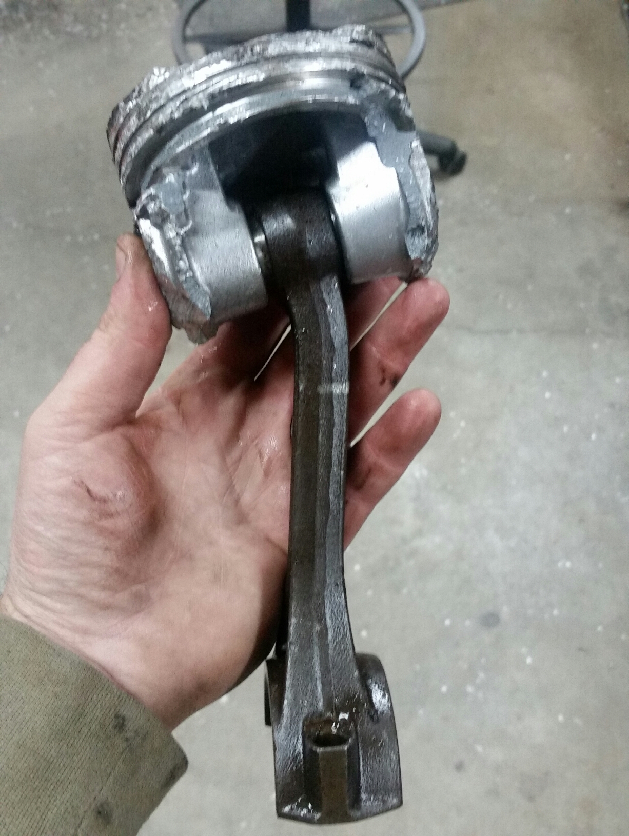

Post Options Post Options   Thanks (0) Thanks(0)   Quote JohnCO Quote  Post ReplyReply Direct Link To This Post Posted: 11 Dec 2017 at 11:38pm
That piston looks a lot like the #i on my Ford 555 backhoe.  Cracked cylinder (no sleeves),
It now has a sleeve and a new piston.  Haven't gotten around to getting it back together. Hopefully this next month or so.  Your engine looks nasty but a couple hundred bucks of parts should make her good as new!

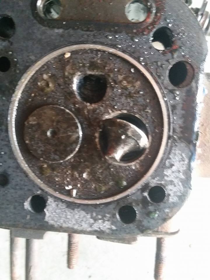

With this valve stuck sideways, it gouged the metal.  Is this something that should be welded, then machined again, or should I be looking for a new head?
Is there anyone you would recommend to do the work?
If I need to replace the head, where should I look?  I've been looking online, and haven't found much...
Post Options Post Options   Thanks (0) Thanks(0)   Quote CTuckerNWIL Quote  Post ReplyReply Direct Link To This Post Posted: 14 Dec 2017 at 9:04am
It appears to me , there is a hardened insert for the valve seat. They can be replaced if needed and done properly.
 Full engine kits come with all new valves. Probably be a good idea to replace them all with new springs. Maybe even new guides would be in order if the old ones are noticeably wore .

1st question, did the broken valve cause this?
or
did the piston coming apart cause the valve to break?
I've NEVER seen a piston come apart like that before!  Maybe your best bet would be to contact Don(MO).  He's our expert here on these old engines.  He'll guide you down the path to having her up and running in no time.  I'll PM you his phone number.  He'd be the first place I'd start.

I would guess the valve dropped (or broke, but likely dropped, then broken by the piston) and caused everything.

I'm guessing it over-reved going down the hill and the valve floated and was hit by the piston. Block, head and crank should all go to a good engine machine shop and be checked out.   At least thats what I would do to start with.

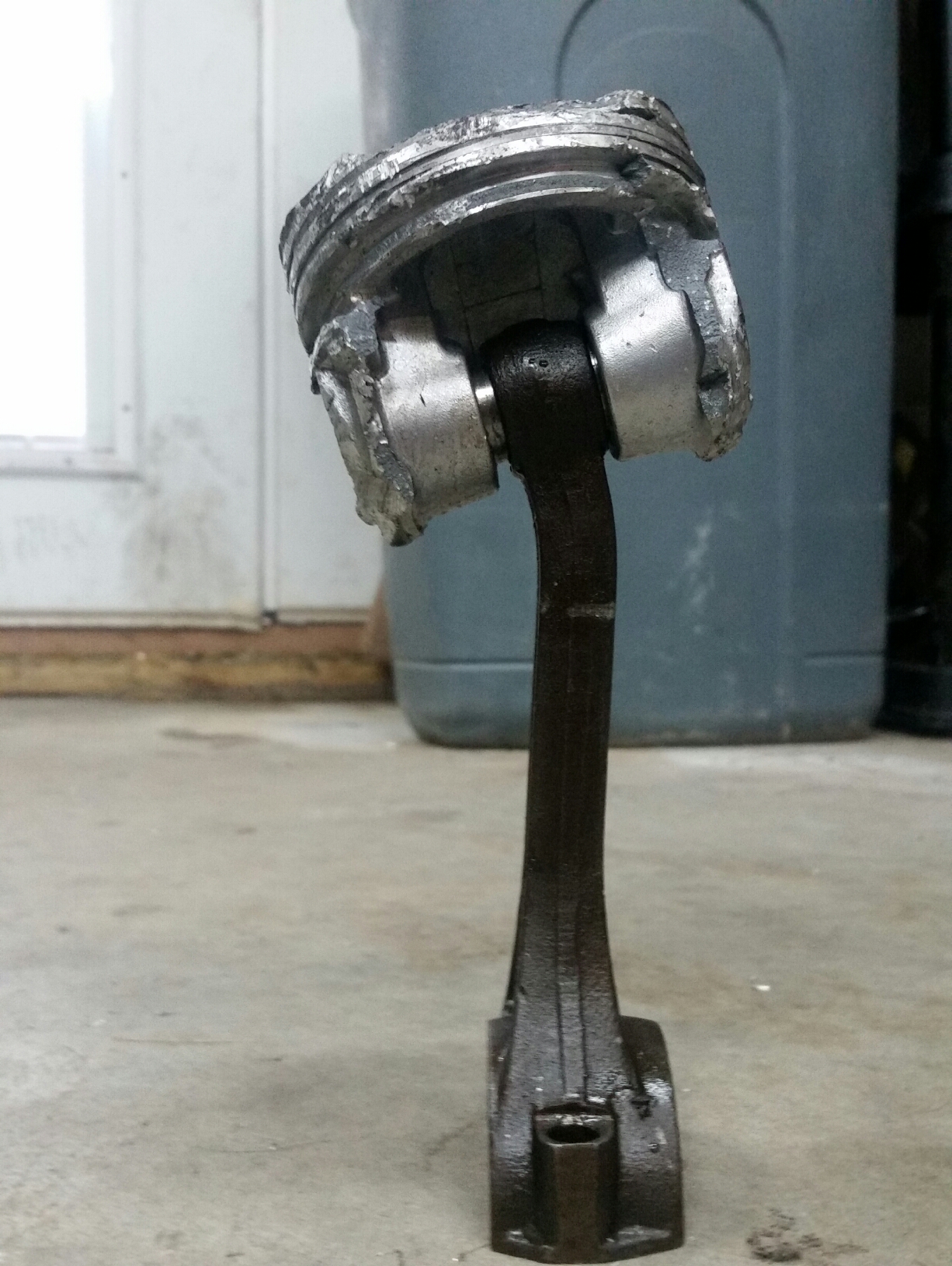

I believe rod bolt may have came loose and started the chain reaction. Dropped valve usually just beats the crap out of piston and head. Never seen dropped valve cause rod bolts to break and or bend the rod sideways.
Was the rod still in tact on the crank or are my assumption correct ?????

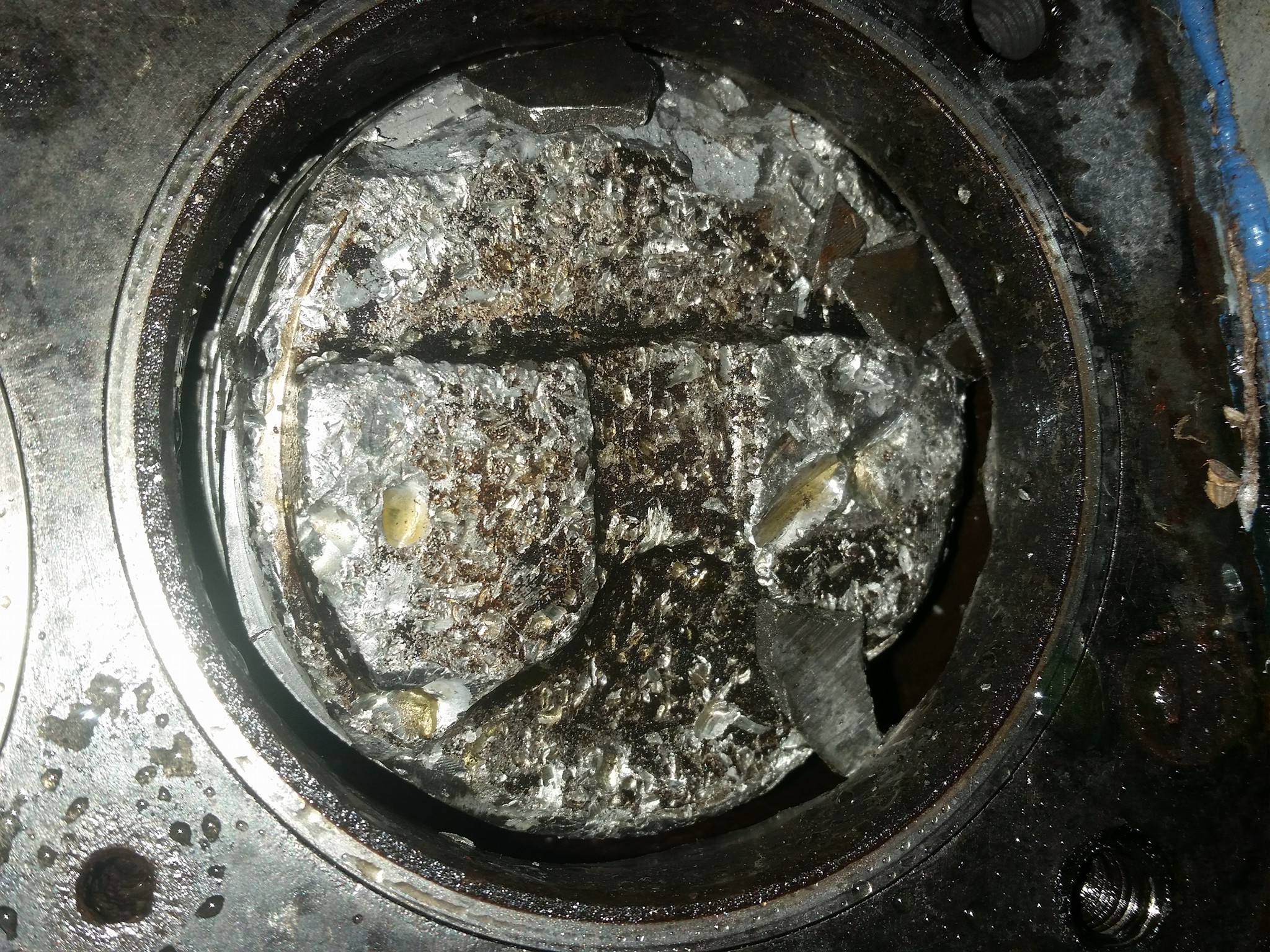

Based on the damage to the top of the piston - it looks like the valve danced on top of the piston for a while.

Sorry for the loss--but thanks for the pictures.  They are indeed impressive.  Could the sleeve have been shattered by the dropped valve?

Head don't look too bad, I'd take the valves outa that cyl, and grind the dents til the surface us relatively flat (4" hand grinder).  Then take it to be magnafluxed and pressure tested, if its OK, there, then have the head rebuilt, or DIY, if you feel equipped and experienced enough to take it on...

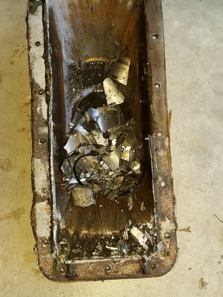

Wow! Nothin' worst than an oil pan full o' parts. Looks like the valve broke, beating the piston to death, breaking the sleeve and allowing the rush of coolant into the cylinder. Hence the bent rod. Coolant doesn't compress well. I would have that block magged to make sure its not cracked. Might have cracked the block with all that damage...
