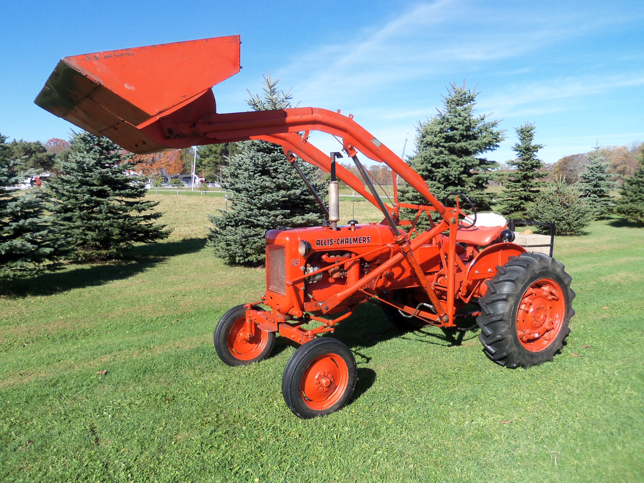

I restored a '51 CA Allis 35 years ago. At that time I installed 149 cu. in. engine I understood came out of a combine. I've never had my fingers inside this engine. Always ran real good until about a year ago when it began to start hard. Once running it ran good. Had to pull the throttle down past idle to get it to start so I thought it was a carb problem. Rebuilt it with no luck. Then new points, condenser, plugs and wires. No luck. Then compression check, all cylinders at 140 pounds. Pulled the plug out of the intake and had good vacuum. Starting to run out of ideas! Pulled the magneto out and bench tested it and the spark was somewhat weak. Installed a rebuilt mag. No luck, but now I found another problem. The mag is timed right, #1 TDC and FIRE line in the hole, I could only get 10 degrees advance with the slotted adjustment. It should 30 degrees past idle. Now what? Scratched the head for a while and decided what do I have to loose. I pulled the mag and front governor cover and turned the governor gear 1 tooth advanced and guess what, runs great! 30 degrees advance with the mag parallel with the block. Tractor runs great but I'm still wondering what's going on inside this engine???

Nice tractor and loader!
