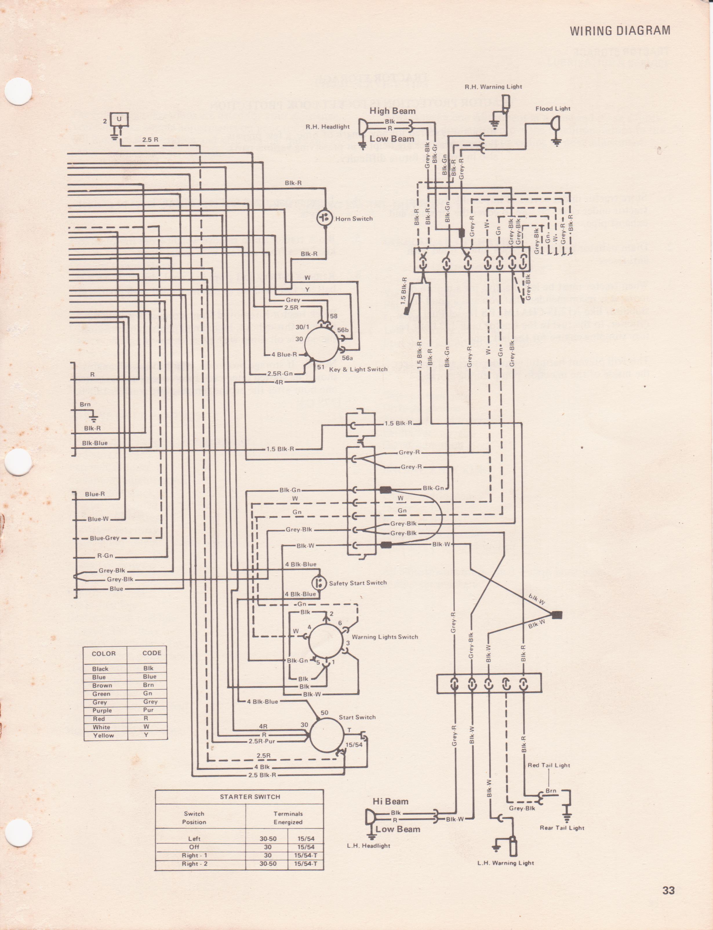

Does anyone have a diagram for how the ignition switch for a 5040 should be wired? Picked up an old 5040 that had the switch removed, ordered a new one and need to install it right. Thanks in advance.

I have operators manual with wiring diagram, now if I can figure how copy and post. I will send on another post.

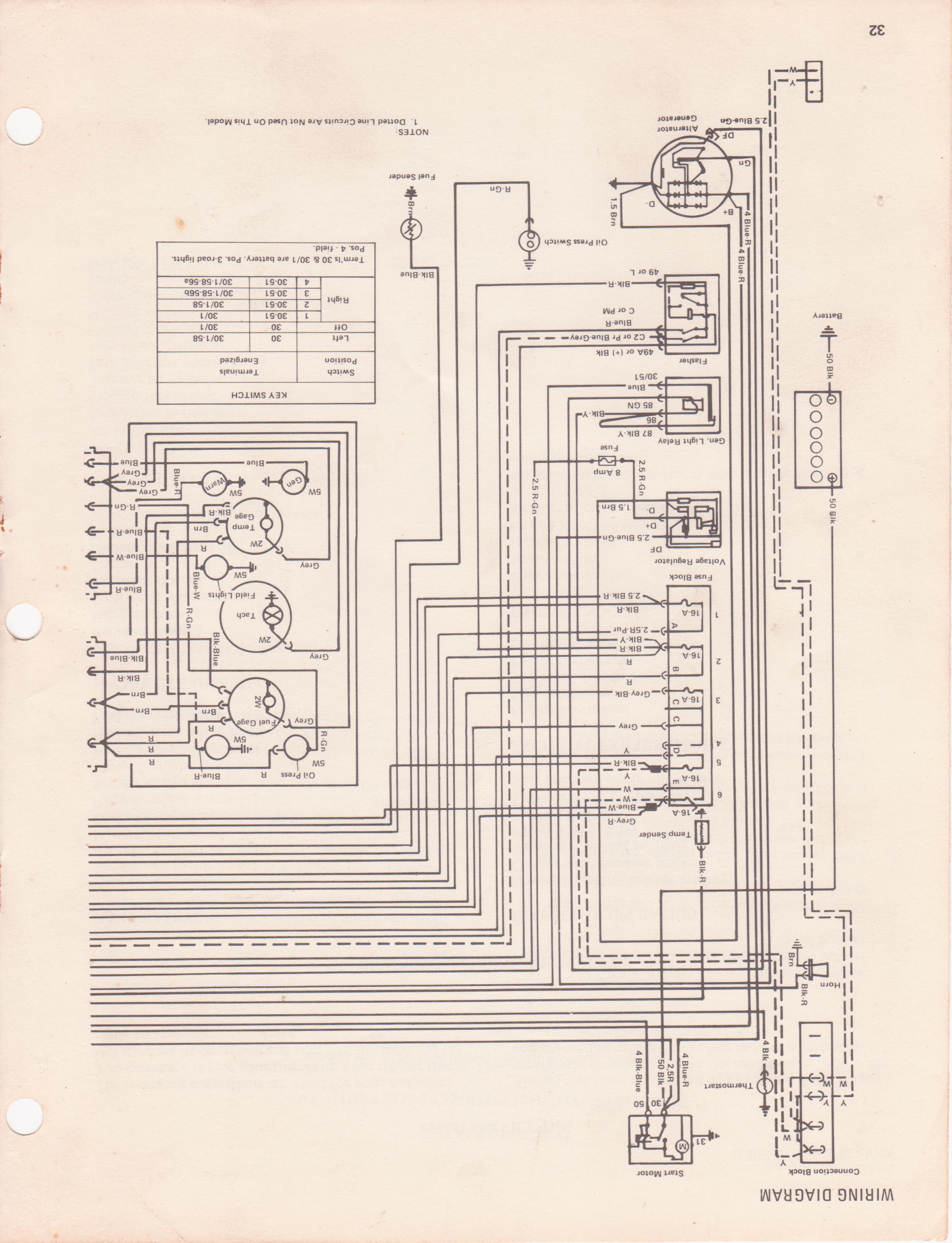

Well I did get it on here. You may have to turn your computer upside down to look at the last.  It was the center pages in operators manual. The key switch is also the light switch.

Did these help?
