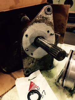

Had to go out of town for 4 days. Top sightglass now has oil in it and the tranny dipstick is down half an inch. Hmmm. The range tranny cover under the suction screen has a drip so I pulled it off to reseal. It wouldn't stop dripping so I got a good light and sure enough the shaft seal had a nice steady flow of oil coming from the rear end side of things. It finally stopped and no oil in the top sightglass now.
So I orderd a seal today. It looks pretty straight forward to pull the three pump assembly off. The manual says to remove the axial piston pump and then remove the other two pumps as a unit. Replace seal and reassemble. If anyone has done this and want's to offer any advice I'm all ears and would really appreciate it.

I use a slide hammer with metal screw to pull seal. Make a long driver that will just slide over shaft to drive shaft straight and long enough to hit it from out side of housing. Not a good place to drive a seal in.
Any time you have the pumps out replace that seal.      MACK

The pumps cannot come out as a unit. Have to pull one and then the other two can come out. Got the seal out and it was rock hard.
Now the bad news. I ordered the wrong seal. The old seal has a number on it. What's everyone's experience with going to someone like Motion Industries for a seal? I don't want to wait four days for a seal but I sure don't want to do this job over either.

Any seal that # should be ok. MACK

Mack I took your advise on the piston pump gasket. Have that and the correct rear end housing seal for the shaft headed my way.

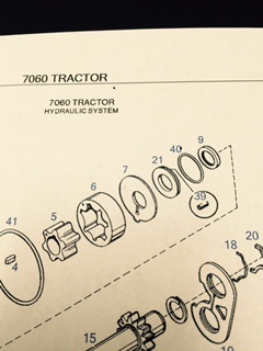

I was reading my manual and it mentioned the 70265398 seal in the adapter housing can also cause oil transfer problems. I have this seal so I thought lets take a look. It looks pretty simple to change. Am I missing anything here?
Also I don't have parts 21, 39 or 40 in my assembly? My tractor according to the serial number is like the 103rd one produced.

Finally had time to get the seal in yesterday. Used three 7/16 long bolts to slide the first two pumps on. Worked real slick. So far as I can tell it is not transferring oil anymore between the tranny and rearend. Thanks for all the advice.
