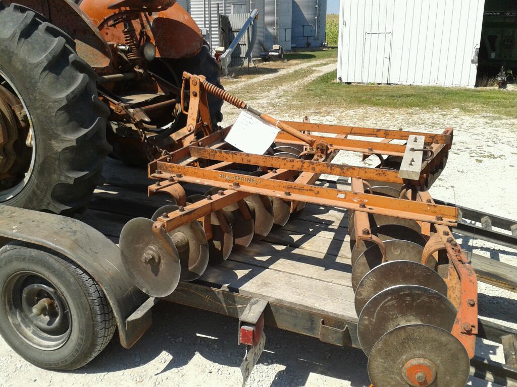

Post Options Post Options   Thanks (0) Thanks(0)   Quote Brian F(IL) Quote  Post ReplyReply Direct Link To This Post Posted: 05 Jun 2017 at 8:05am
Yes, it should work but I'm sure the front end of the CA will need more weight.  I've got this #109 that I pull with my WD-45.  I've got front wheel weights and I still can get the front end in the air if I get too aggressive (aka stupid) if I take off too fast with the disc raised.
