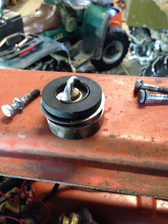

So with my new engine in I was determined to get it to run at the proper temp. Here is the existing tstat housing:

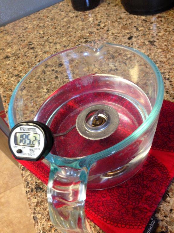

I tested the new thermostat:

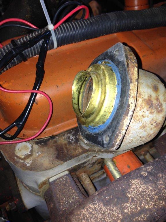

I found that the thermostat was not completely sealing against the rad side of the housing. There is a rubber ring, but it looked like there was an 1/8" or so gap between the tstat and the rubber ring. Fellow forum member Carbonite and I looked around the shop and found a piece of exhaust pipe the right size, so we cut a ring and after some experimenting on height, we seemed to hit on the correct size:
So installed it and tightened everything down filled up the system. There was a bit of an interval (2 months) before I could check it out as work and other things got in the way.

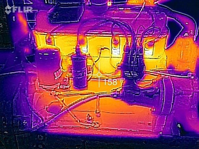

So last weekend I got the IR camera and fired up the engine. Here it is cold:

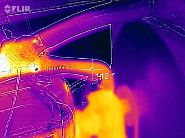

The engine is warming up, but no flow is going to the rad. Mission accomplished? I rad it for a few minutes until the temp gage hit 180F, you could see the stat open up and vent water to the rad, then close, open and close until it reached an opening that held the engine at about 175F. Haven't put it to work yet, but will try it this weekend. here is the engine hot:

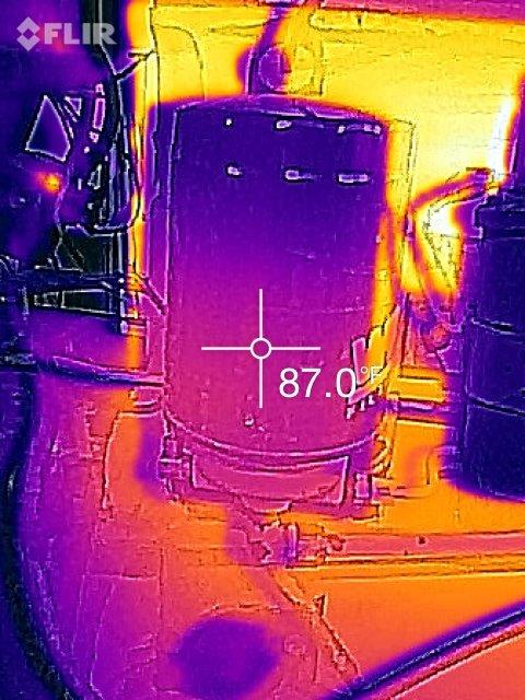

One thing I noticed that even though the oil pan read 80 - 90f, the oil filter was only getting flow in the bottom section. This new engine is the full flow style, so it looks like the cold oil in the top of the filter is not moving. I imagine if I ran it for more than 20 minutes the oil would eventually warm and flow through the entire filter. I'll have to check that when I start plowing later this month I hope.

Oil flows thru the path of least resistance. As the lower section of the filter accumulates "debris", flow (temperature) will move upward. Also, their is some level of cooling on the upper section of the filter (but "cooler" oil flows).
