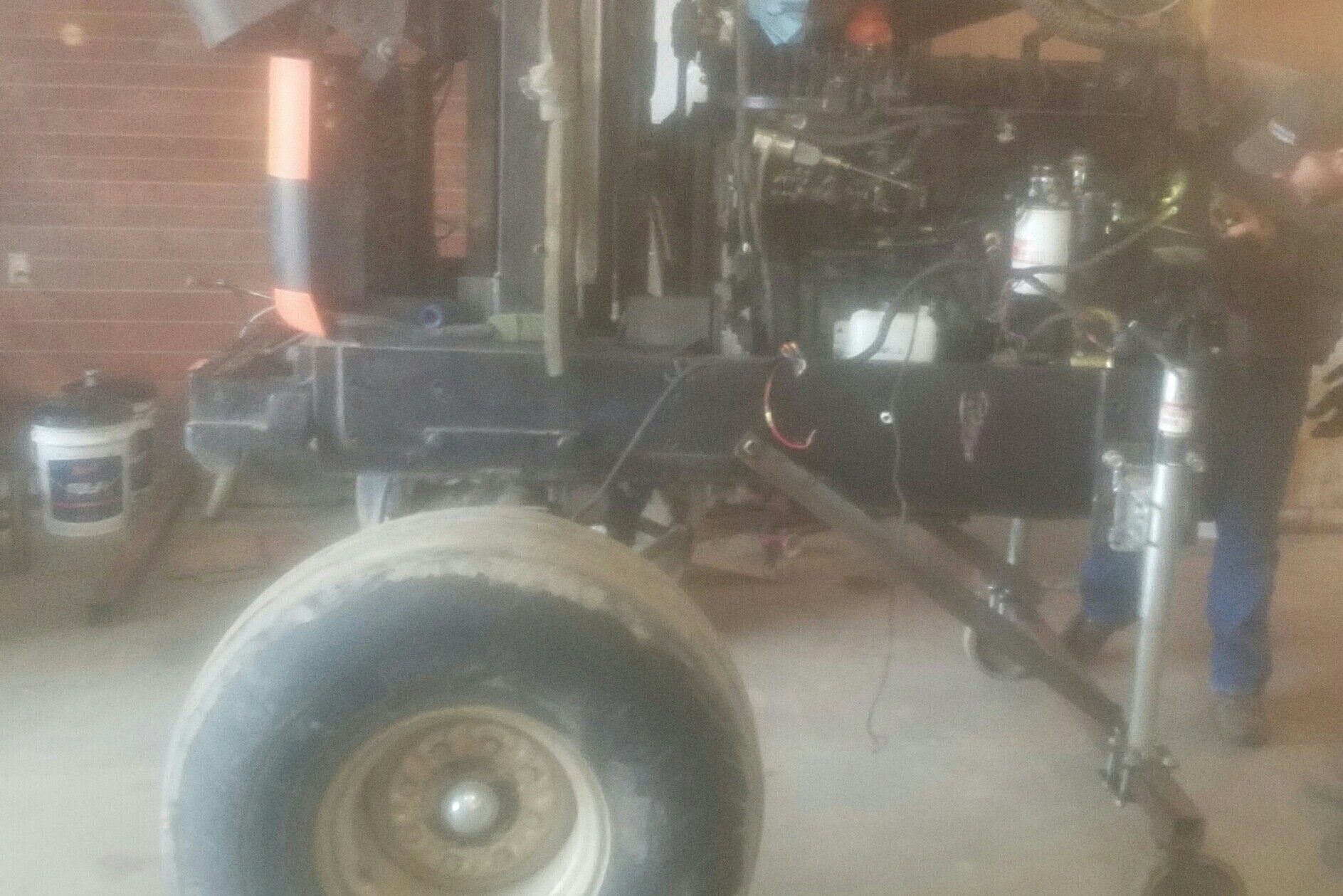

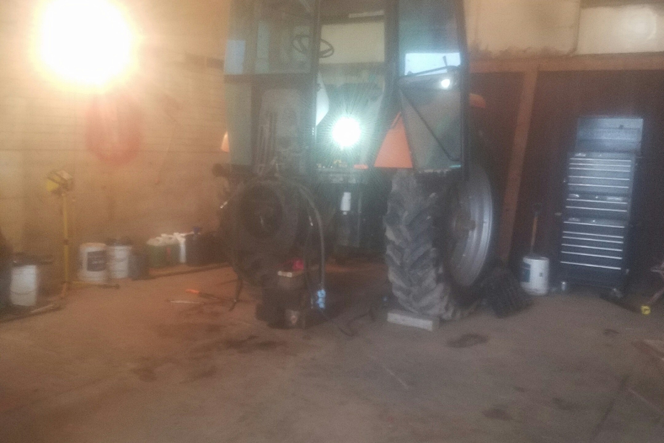

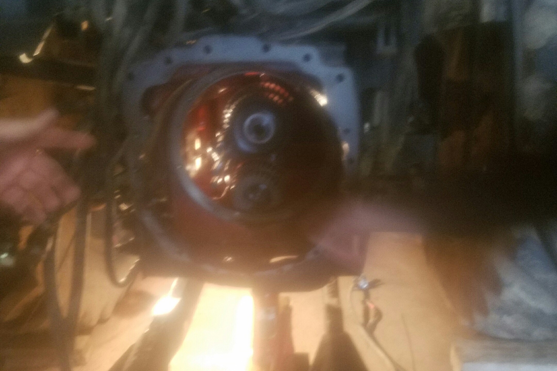

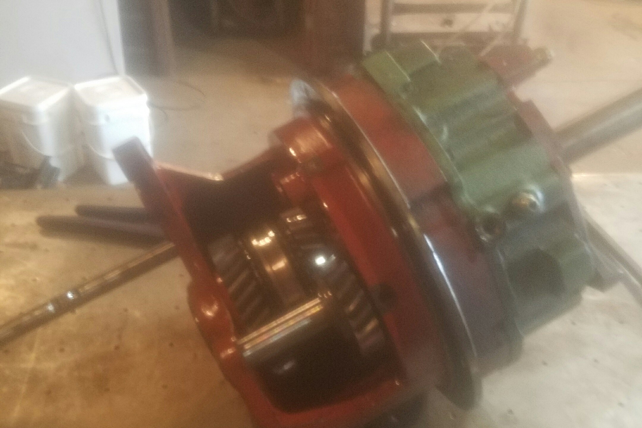

I posted earlier n the week looking for advice on my tractor that lost forward and reverse. Well we finally found the problem. The shift fork is just plain wore out. The only problem was we had to split it. Take the bellhouseing off and pull the four Speed power shift out. Turned out to be a long weekend.
