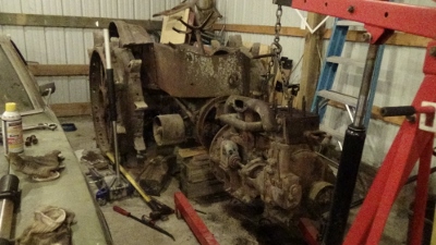

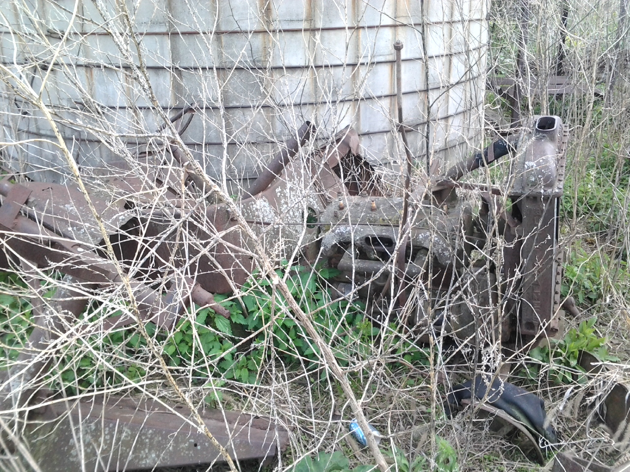

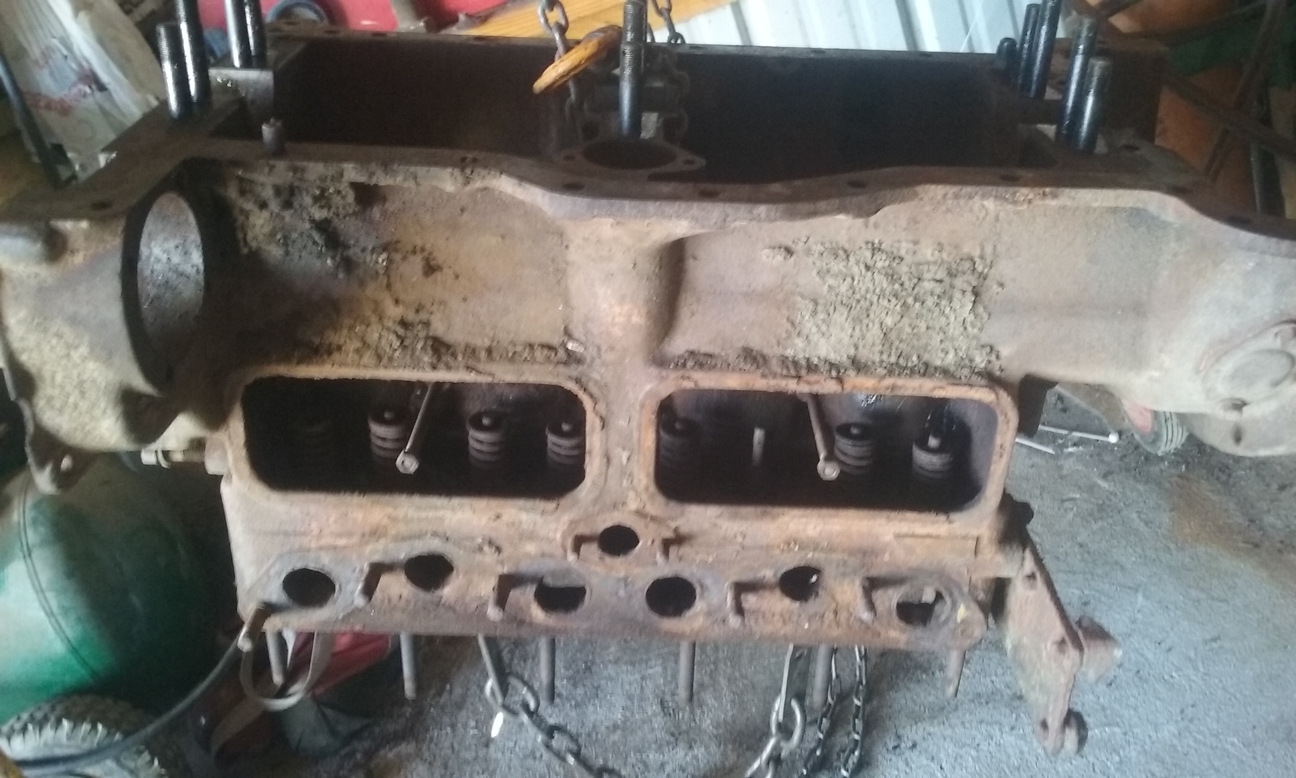

i finally had time to start tearing apart my model u continental motor. took of water pump and go out governor. broke a couple things. the thing i was worried about the most was getting crank out. i took out soft plug in the back and used a brass bar to pound out crank. but there was not enough room to get crank past the lifters and they are frozen. i was going to give up for the day but noticed since i took the bolts out that held the windage tray that the casting that held the lifters had moved. low and behold the whole things casting and lifters come out. so then i was able to get the cam out. now the only thing is to get the valves and guides out. but they are the worse rotted thing in the hole motor. do you guys have any ideas some of the valve heads are rotted off along with the guides. need to find guides and valves and seats that can be made to fit in there. im going to get crank polished and use old pistons and new rings and just hone the cylinders. i do need one piston though. im also going to have to learn how to babbit the rod bearings. will be awesome when i get done. but as you can see its a mess

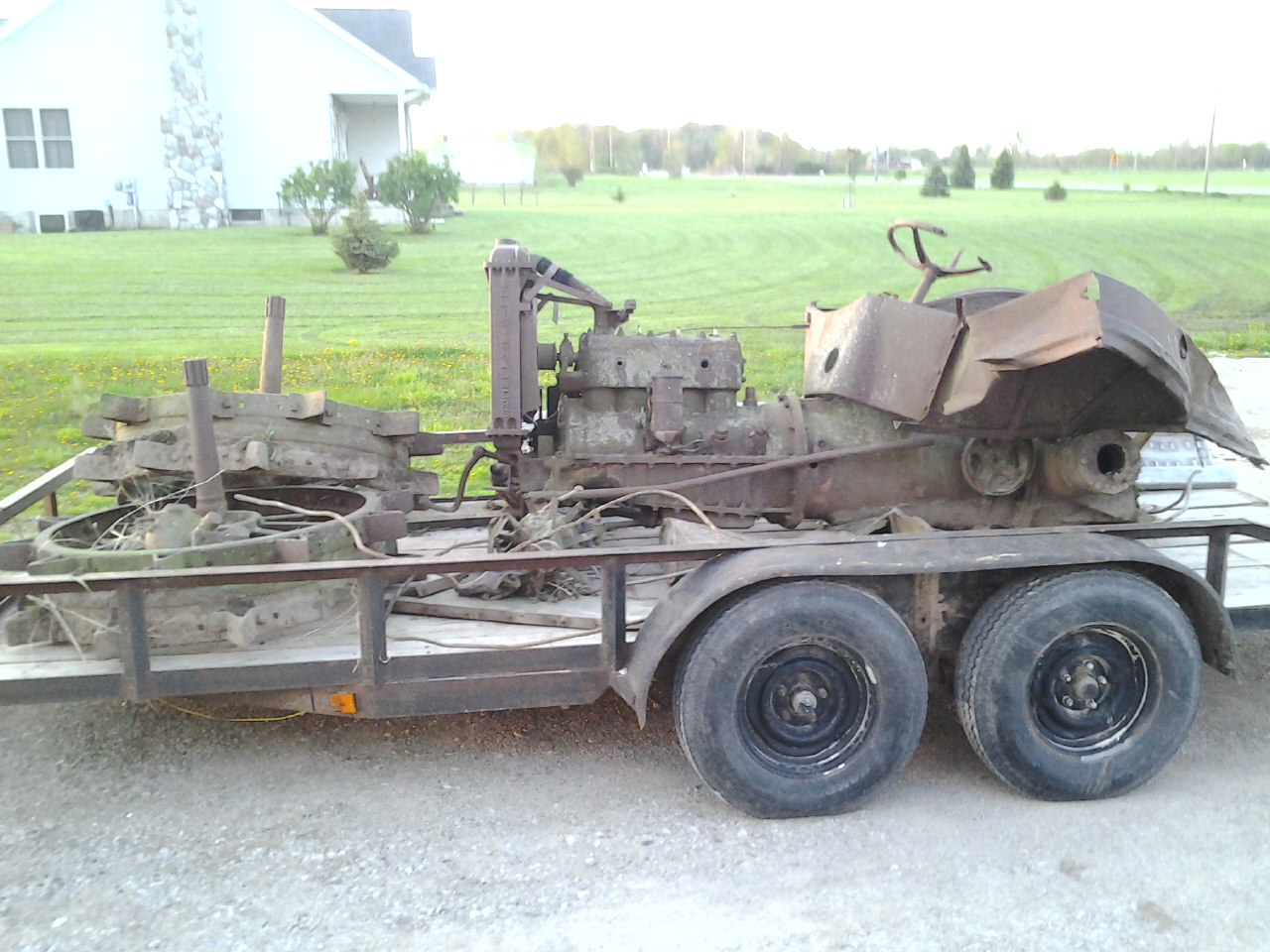

this tractor has not ran since 1959 when  neighbor borrowed the carb off it. also the first time its been in a barn and thats been over a year now

Looks like you've got a lot of work ahead of you but when it's done you will be a proud man with a great machine.

That looks like it's going to be a big undertaking. But should be a gem when finished. Good luck! Darrel

Yeah, looks like a big project, but that is what makes it lots of fun! Clap I like these kind of projects, I'm a sucker for basket cases!  Keep us posted please, I need to learn about U's yet, as I don't know very much about them.

I pulled axles out of rims with giant 200 ton press. And installed new bearings and seals. That was a huge undertaking. But rear end is all good now. Just being a continental motor and no parts is the bad thing.but will be rare when done. Worst part will be valve guides I don't think anyone makes them. Those and the seats are rotted beond hope. So I'm liking for something similar that I can have machined to fit.

That is an interesting manifold. Quite different that any of mine.

I have had a lot of people ask about the manifold setup it is wild like some kind of after market one no onehas seen one before.

That looks like a Robin manifold. They made gas manifolds for many makes and models. Quite common here in western Canada.

Manifold barely says robin I thought rorin'. Cool learned somthing new.I'm also looking for steel front wheels and a piston
