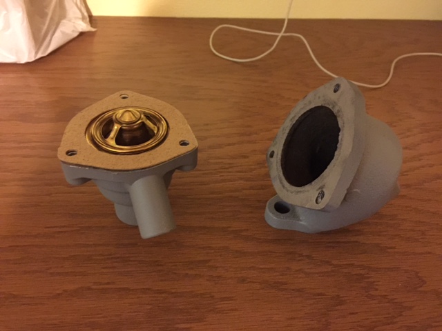

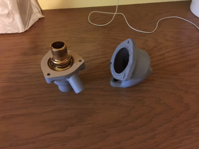

My D17 did not have a thermostat in it when I opened it up, not sure which way it needs to go in the housing. Appreciate any help on this. Thank you

Bottom picture is WRONG. Never saw one like top picture.     MACK

The top pic is of the other side of the same thermostat as you see on the bottom pic. this 160 degree stat came from DJS.

Another vote for top pic correct, bottom pic NOT correct.
