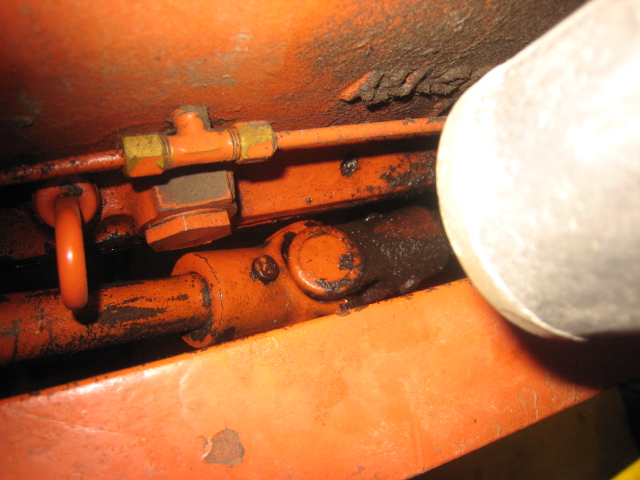

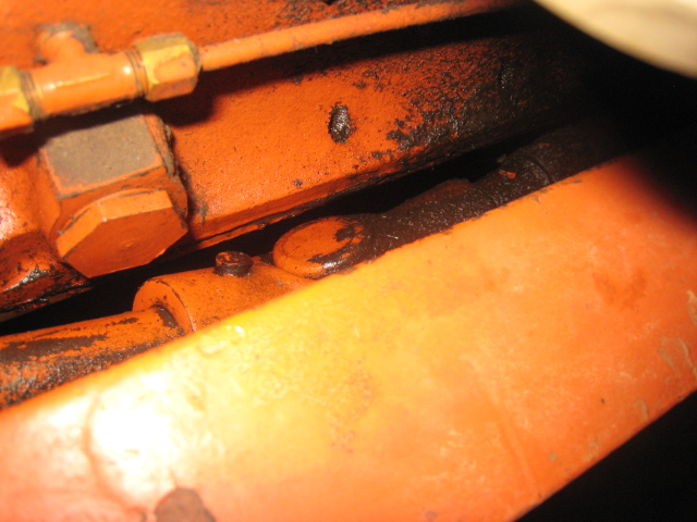

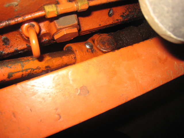

John, I think originally from the factory the pin was tapered and pressed into a tapered hole in the shaft. The small end of the tapered pin was then swaged (SP?) over to keep it tight. Check the hole and see if it is tapered. If so, if you just put a straight bolt or pin back in it will still be loose and subject to more wear than a tight fit.   You might be able to get a tapered pin at a good hardware store or at McMaster-Carr. On my WD 45 I noticed the tapered pin was loose and worried about it falling out on the road on a tractor ride. I took the pin out and drilled and tapped into the small end of it so I could add a screw and washer to keep it pulled tight into the tapered hole. I also applied Loc-Tite on the pin and screw when I put it in. I try to remember to check it often, but so far it has not loosened up. Here are pic's of before and after.
