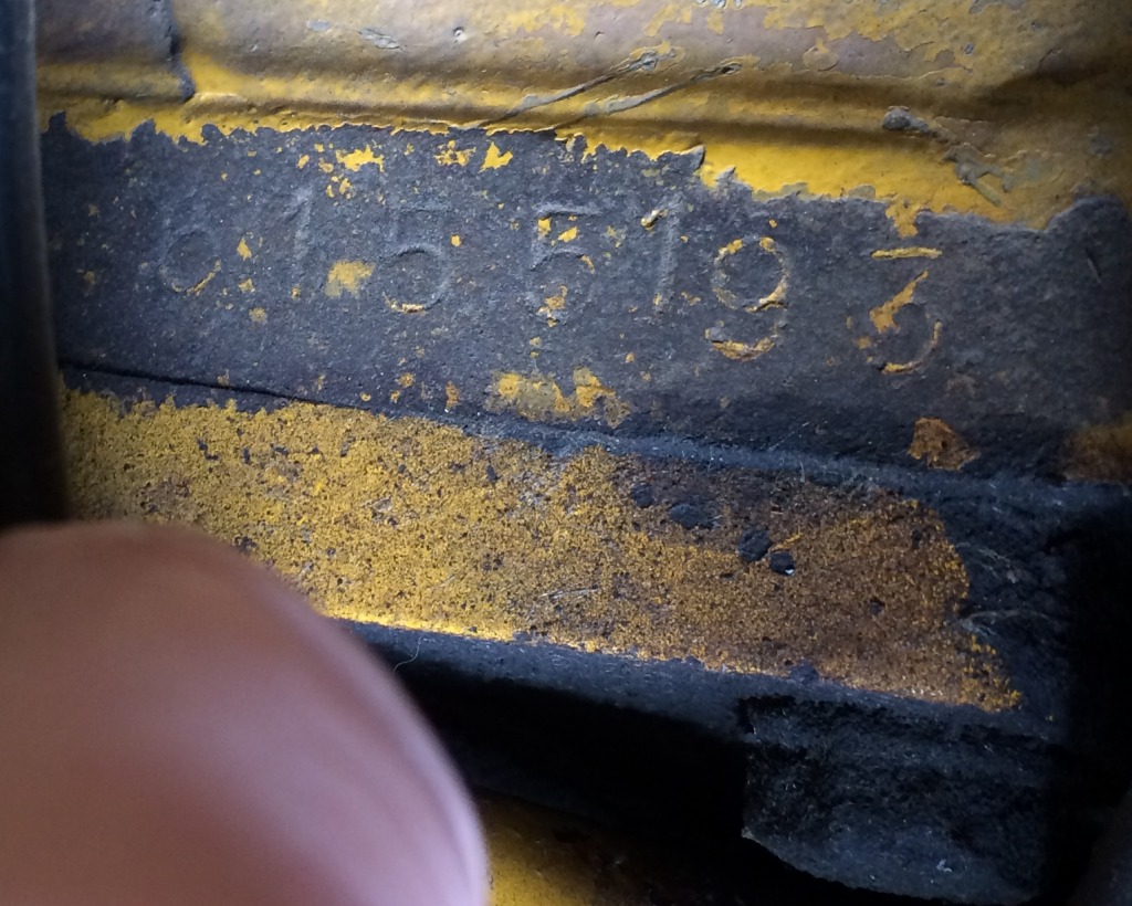

I bought a 615 on a Minnesota State auction a couple months ago and I am trying to find how to make the serial number mesh with Norm's construction book. The serial number stamped on it is clear 615 5193.  I got the original purchase paperwork that it was purchased on 11/17/69 for $5,694 from Frank Knapp Sales, 145 West 78th Street, Minneapolis, Minnesota.  The book says 1969 serial numbers started at 1501 and went to 1702, and by 1973 they were only up to 1280.  Was Allis Chalmers ever in the habit of transposing numbers when stamping so mine should be 615 1593?

They were hand stamped, so it is possible that is was dyslexic dave's day on the stamps...Wink

Our tractor is 6155489. We did have another tractor with loader that I sold in Iowa with a lower serial number, (5xxx). I was told that Allis used this series for municipal machine identification. Both 615's that I have owned came out of Kansas and were municipal machines.

Our tractor is a 1973 per Herc-U-Lift in Maple Plain.

Thanks, Then it looks like Norm's book needs an addendum on the 615 serial numbers.  Good to know that others have the same number series.

Knapp Sales changed to Breeze Industrial at same location in Bloomington, then they went out of business and Herc-U-Lift became the AC industrial dealer in area -
 that looks more like a casting number than a srl# which would be a stamped in rather than raised system. keep looking .
