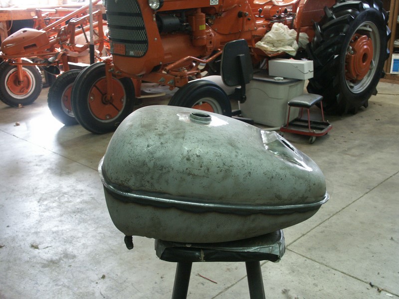

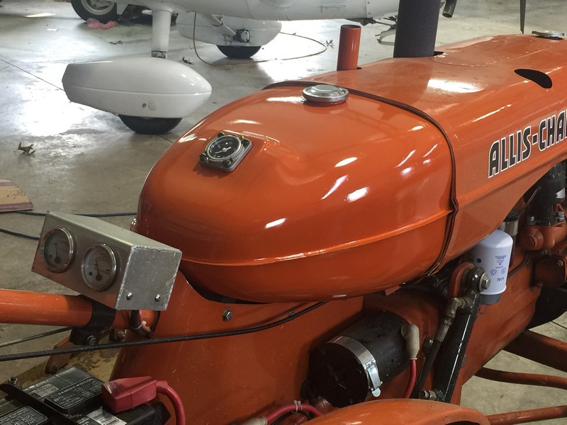

I do a lot of mowing with my lowered B, thought it would be nice to have a fuel gauge.

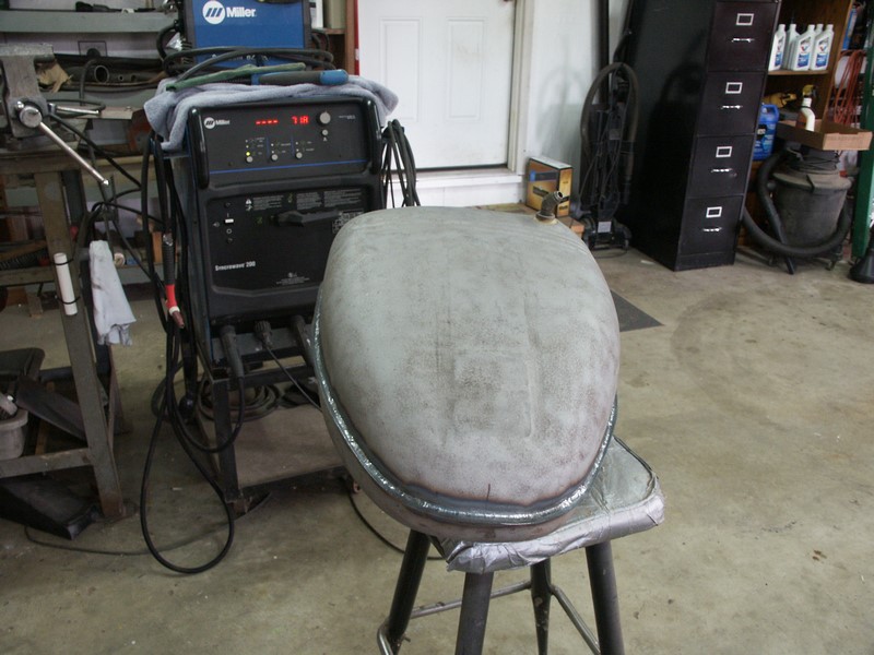

So I cut the gauge area out of a rusty D14 tank and welded it on the B tank. Also cut the tank in half at the seam so I could sand blast the inside.
I think I'm going to like not putting a stick in the tank to check the gas.
Sorry I can't seem to get the text and pics in the right order.Angry

Is that one of those glow in the dark gauges?
wbecker View Drop Down
Joined: 29 Oct 2009
Location: STL
Points: 837
Post Options Post Options   Thanks (0) Thanks(0)   Quote wbecker Quote  Post ReplyReply Direct Link To This Post Posted: 23 Nov 2016 at 3:22pm
No, glow in the dark.Confused

In the propane world those are similar to the junior/senior gauges. The black face are glow in the dark and the white face are standard. The glow in the dark is for transports and bobtail trucks with the round gauge. I just had not seen onethat small with the black face. Anyway, great job. Looks very nice and no more stick to check fuel with either!

Sandknob, the gauge is form a generic Allis replacement from a tractor supply, a simple float type.

I looked in all my catalogs, can't find that generic gauge i used, they now have one with the Allis Chalmers on it at twice the price, $74, glad I bought it a couple years ago.

Very nice work on that gage installation and taking the tank apart and welding back together also! Looks awesome. Gives the "B" a little bling! Wished I could weld that well!

And the best part is you know the tank is clean now.
