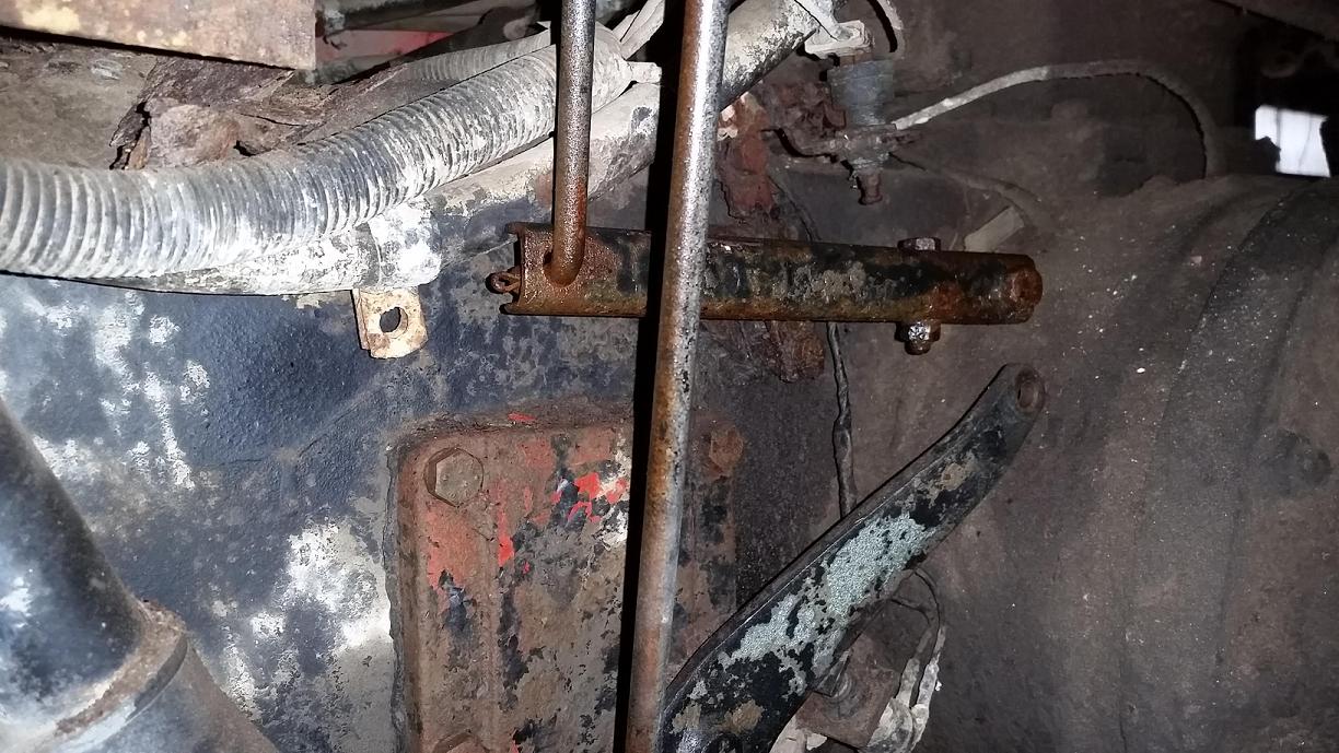

On the left side, the PTO handle connects down to the lever below the cab.  For me it is stuck  horizontal, which means it is in the on position.  In order to turn it off the handle and lever must go down?  I tried using a hammer to gently persuade it and made no progress.  Here is a picture showing the lever below stuck horizontal.  What is the best method for unsticking it?

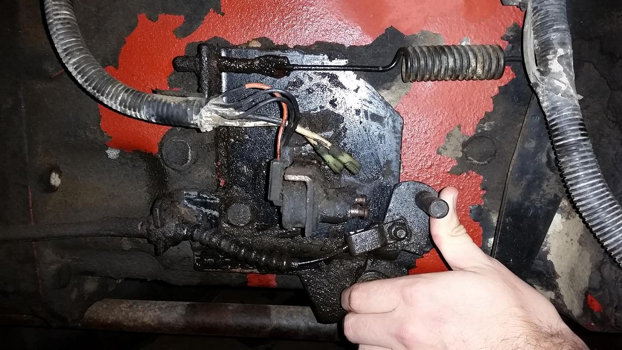

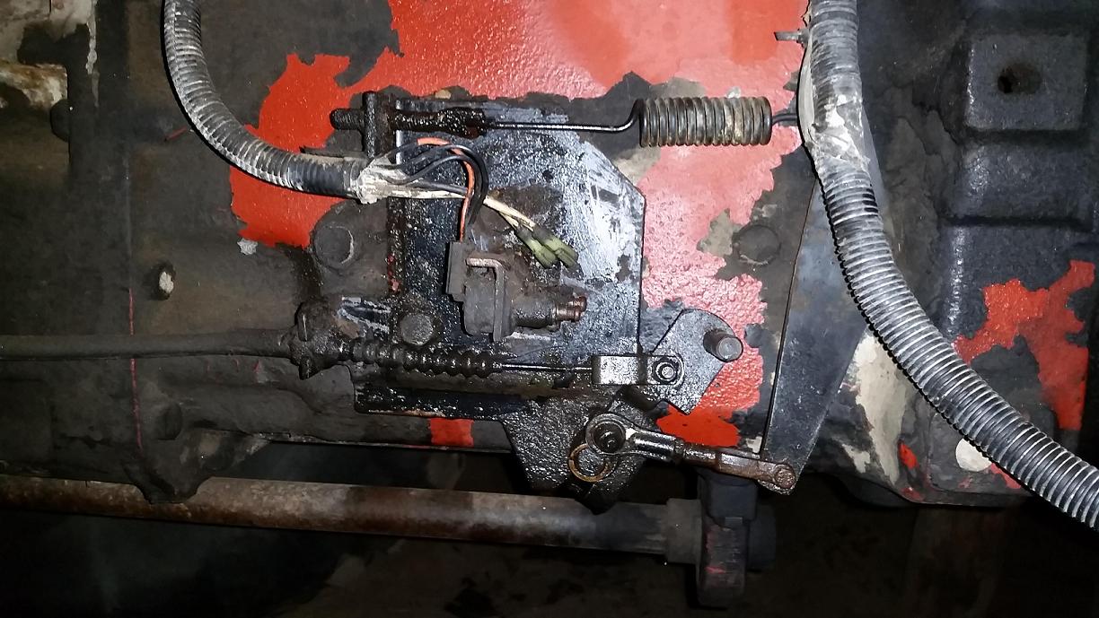

On the right side PTO clutch I found more issues.  I took the lever cover off inside the cab and it looks like there is supposed to be a connection so that the cable moves independant of the cable sleeve, but there is nothing holding the cable sleeve.  Can someone tell me if this is supposed to be connected at the floor or if i'm missing something?  Here is a picture:
So when i pull the lever, the entire cable moves but it isnt pulling the wire through the sleeve. I followed it down the the mechanism and started playing around with it.  Here is what it looks like.  I was guessing that those two wires that are disconnected are to over ride the disengaged safety start requirement for the PTO?  If that's right, the guy who owned the tractor definitely knew there were issues.  This is what that looks like:
I grabbed the piece that gets rotated and tried to move it just by hand and was able to get some travel but i don't think it is nearly enough.  I did take a picture with it rotated as far as i could do it by hand.  I also tapped it with a hammer and couldnt get any more out of it. Is that rod sticking towards me supposed to rotate until it hits those two things?  Are those switches? What do they do?  It looks like i should either replace or free the cable, get the cable sleeve held down by the lever base/floor, and free up the mechanism so it has full travel?  Is that all correct?  Is there any way to get full travel without splitting the tractor?  What if i get the cable working correctly with the lever and pull back on it hard, while starting the tractor with a piece of equipment hooked to the PTO?  Would that maybe allow the starter help break the clutch free?

Here is a picture of the clamp you are missing.
Here is the pto handle in the forward position.
Here is it in the rearward, pulled back position.

I would probably get the bracket on the cable and then do the adjustments per the manual first.  Could be all that is needed?

LB thanks so much for the pics. I can not physically get it to move that far back so I'm afraid something inside may still be stuck. At least now I know how things are supposed to look. I'll see if I can get that cable freed up tomorrow and start ordering more parts. It also looks like my wires are on the wrong terminals. Hopefully this isn't a trend...

pull up the rubber boot on the cable above where the bracket is missing and do a slow drip of some thin oil, looks kinda rusty. the way i see it wires on the terminals should not matter, they both getting compressed and released at the same time.

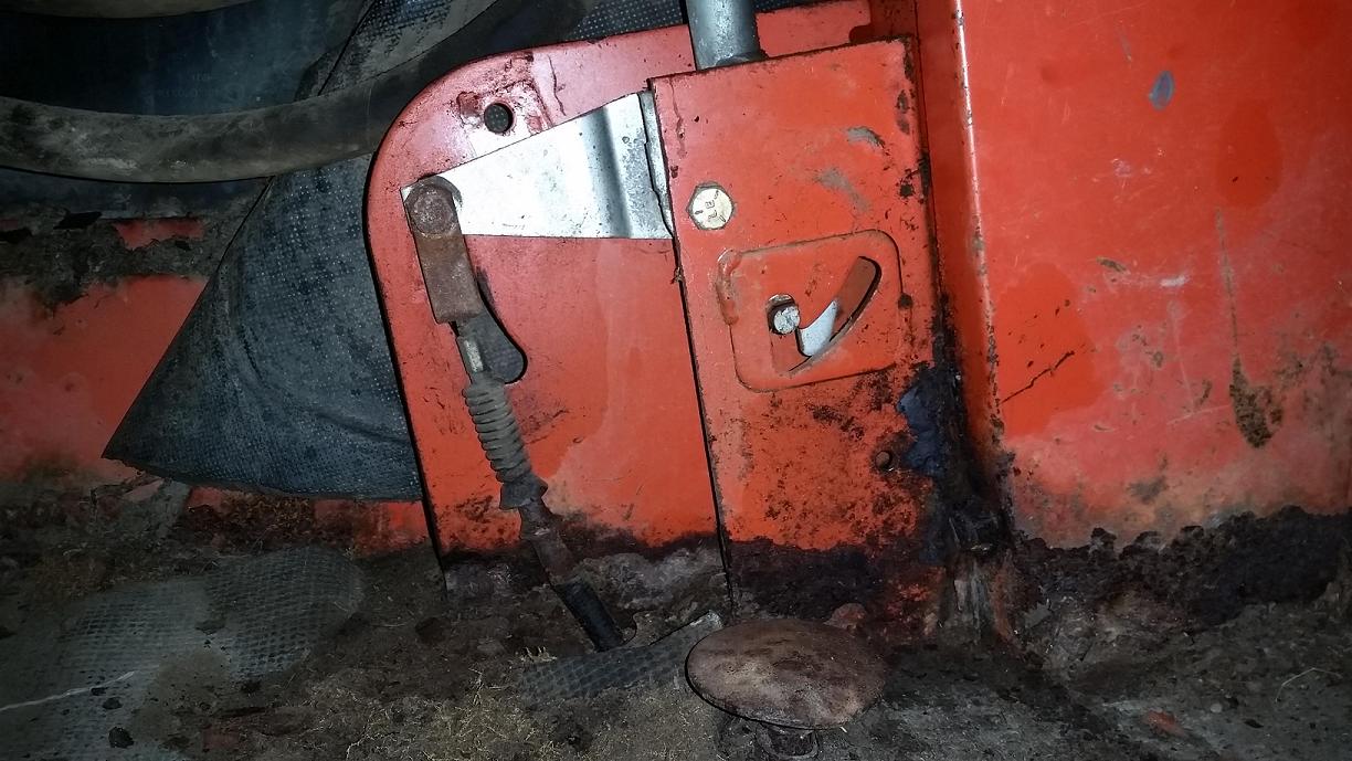

I am kinda guessing on this but in your 1st pic, is the top lever supposed to hook to the bottom black and silver lever where the hole is empty? Also the top lever about halfway there is a rusted off piece behind it,is that the pivot rusted into or nothing or nothing to do with it ?
I maybe totally wrong and the two levers are not related?

That lever with the empty hole is actually the parking brake. The parking brake handle was... you guessed it... seized up aND I pulled it to try and get it free.
That rusted piece behind the pto lever is part of the same lever, it kind of come back on itself like a pivot point as you said.

I'm not sure how it got so bad but i pulled up the floor mats and the floor is almost entirely gone.  The center piece has rusted away in to nothing and the left and right hand panels arent far behind. The PTO cable itself is free but the bracket that holds it is just a ball of rust and paper thin metal.  I'm going to price out replacement floor pieces but if it's expensive i'll have to go another route.
I might look at doing a plywood floor, the edges of the current floor are still solid.  Half inch plywood would be plenty of support and if it was too thick at the diff lock or PTO bracket i need i could router some out i'm sure.

Get the cable fixed first! that's a 2 to 1 mechanical advantage on that lever and there not easy to pull normaly so you won't be abel to pull by hand you will need a big bar . the two switches one is the PTO disengage light in the dash with to right lever back it should light up   the other switch ties to the foot clutch switch and seasonal disconnect switch . If seasonal left is down the right lever can be back or forward to start the tractor if seasonal is up right leaver has to be back to you to start tractor at ALL times unless using the right lever to stop the PTO it should be forward to keep pressure off. hope this helps we have six in the family hard to beat as a all around tractor

Thanks Bradley, i don't think my safety switch is working because the tractor starts up in neutral and the PTO is spinning.  So my seasonal disconnect must be on, and the PTO clutch is stuck on.  Bill said that the seasonal disconnect is just a gear shift so it should not be stuck in gear, but it is.  I have taken a hammer to it and it will not budge.  Its cold and dark here by 4pm so in the evenings i've only been hitting levers/shafts with acetone/atf mix trying to free stuff up.
On the PTO clutch, what movement is it exactly that causes the clutch to release?  Is it the rotation of the shaft in the middle of the piece which has the spring up top and the cable linkage on bottom?  Trying to figure out precisely where to attack this.
