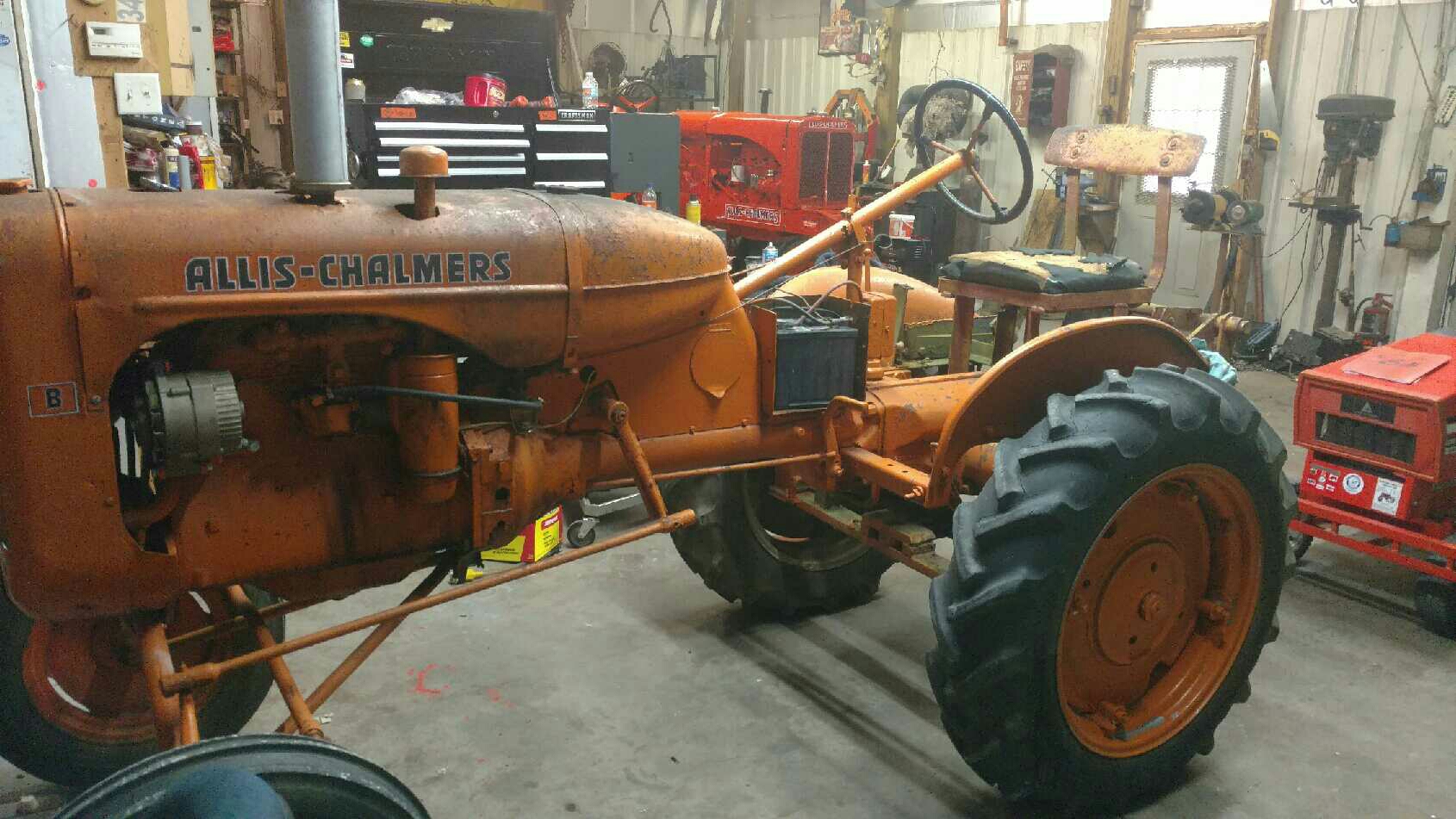

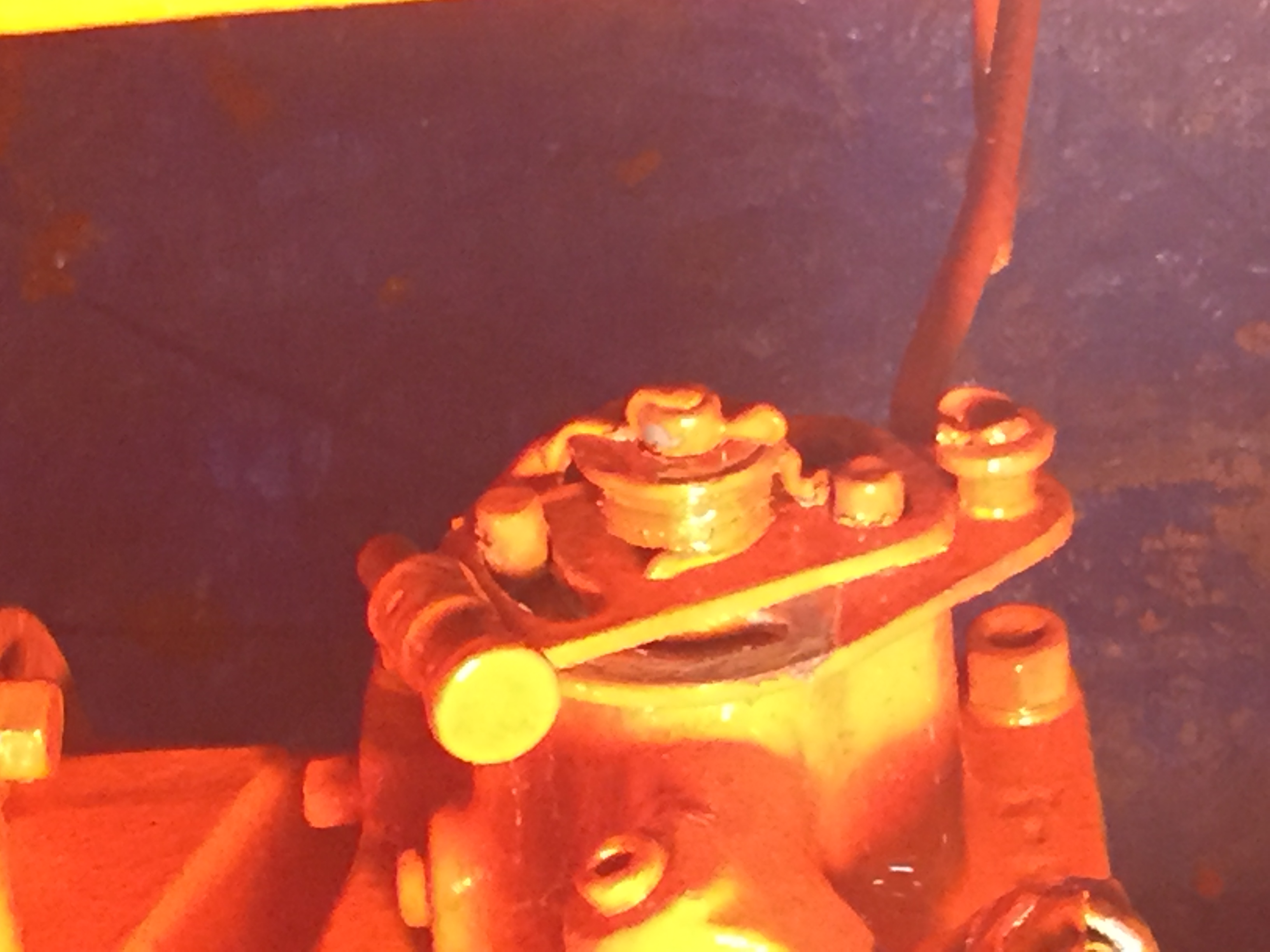

ok heres some pics of the tractor the second one of the hydraulic pump I posted because I would like some info on how the hydraulics work.  the last two are of the " PLUG " or bolt in question

You know, that is not a bad looking B.  Interesting drawbar and seat.  After all these years it is interesting what some modifications are made.  Also, I do not remember that opening being there.  I did not note a rear lift bar.  You have the hyd but looks like it was not used.  Tractor just for pulling.  Heavy Duty drawbar.

anyone have any pics of the hydraulic lever how it hooks up mines missing and the lift is pretty much all gone. But if possible I'd like to see if I can't get it going again
