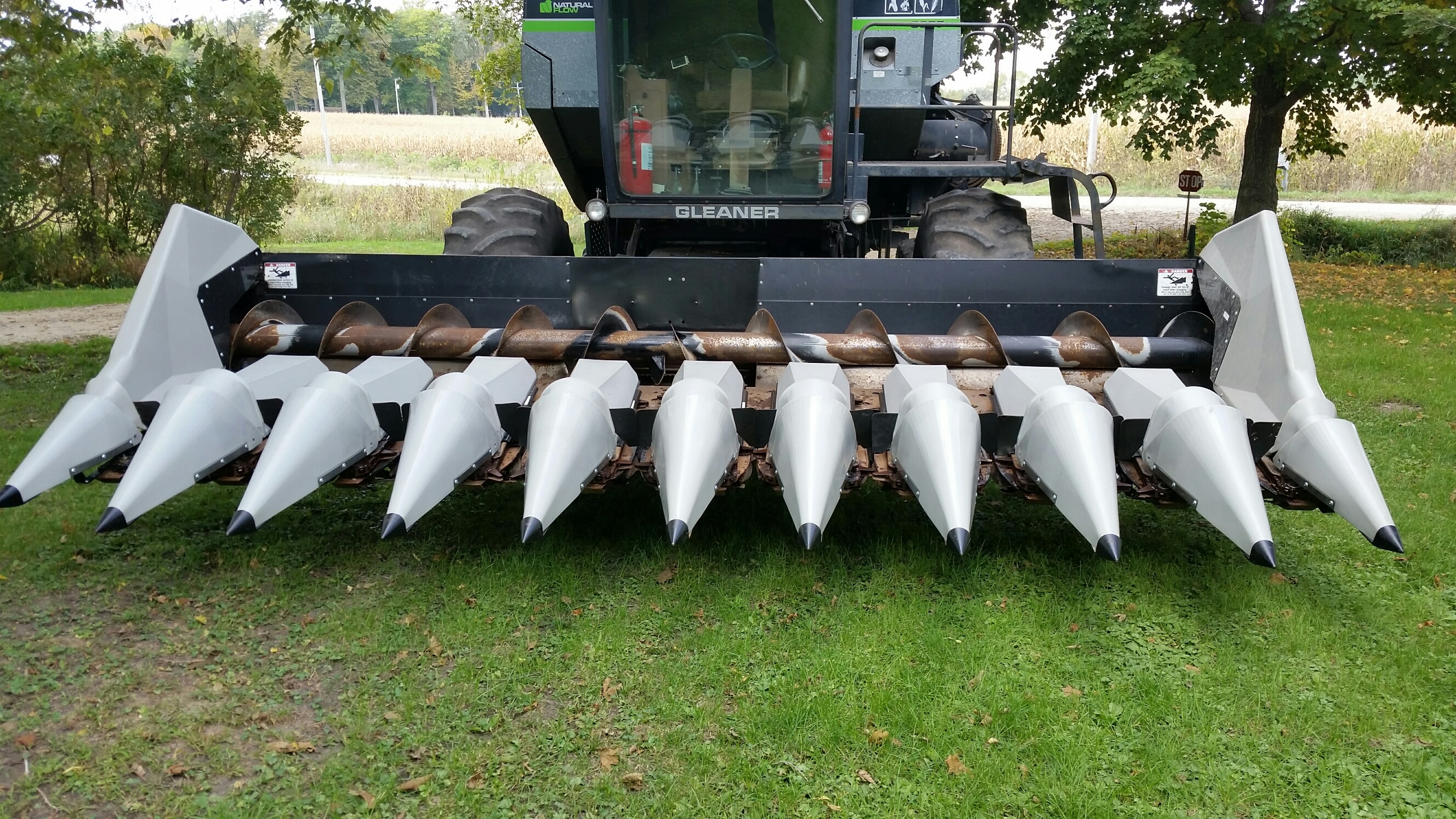

I run 20" rows, and built my own Hugger head and White planter.  My neighbor went to 20's a year before me and put a test plot in on one of my fields and beat my 30" rows that year by 20 bushel.  I've heard reports that the farther North you go the better sub 30" rows are in terms of yield.  Part of the reason I went with 20's was that I generally farm lighter ground that tends to dry out faster and wanted to conserve soil moisture.  It also helps with weed control since like mentioned above the crop will canopy about 2 weeks sooner around here in Northeast Iowa.  Generally I don't plant corn more than 2000 seeds heavier on light ground and maybe 1000 seeds per acre heavier on good black ground than what I planted in 30" rows.  One thing to keep in mind is that with corn you need to be careful on the hybrid that you select.  Some numbers like or don't mind the crowding and will produce excellent yields, other numbers like their "elbow" room and will drop in yield when planted in sub 30" rows.  When selecting a hybrid, if the seed company doesn't know how well it performs on sub 30" rows, I'll look at how well the hybrid likes high population.  If the hybrid likes to be crowded in higher populations, then I'll tend to figure it will tolerate the lower row to row clearance in 20" rows and plant it according to the recommended 30" population.
On the equipment, a standard 6 row 30" Gleaner Hugger head has enough frame to add 3 row units to it and have a 9 row 20" head, but if you are running a Deere 6 row 30" there is too much frame for a 8 row 20" and not enough for 9 rows.  If a Deere head is used, the best way is to use the 6 row frame and narrow it for 8 row 20" to avoid knocking the next row of corn over.  With the 8 row though it gets tight if you are running a 9400 series Deere combine (experience from the neighbor's adventure when he started on the 20's).  I don't have any experience with an IH head for if there is enough room to get them down to 20's.  You can get aftermarket row dividers for building your own head from GVL poly in Minnesota, or Poly Tin in Iowa for both Hugger and Deere heads.  I prefer the Poly Tin row dividers on 20" rows since the hood between the rows is lower and doesn't seem to bounce ears as much.  My neighbor on the first head he had (was bought used as an 8 row 20" with GVL poly), the head seemed to bounce a lot of ears out on the ground.  He doesn't seem to have that on his current head that has Deere poly on it now.
I don't know if your planter is a 3 point or not, but on a pull type you will either need to put the lift wheels on the very end of the toolbar or spin them around and mount them on the front of the toolbar to have clearance between the rows.  If you mount the wheels ahead of the toolbar, it will be tail heavy and have negative tongue weight.  There is an aftermarket company the neighbor bought his current lift wheels from and they are made on a narrow frame with a narrow tire that will fit between the rows, but you will need to purchase an aftermarket narrow (2") gauge wheel for the row units beside the lift wheels to clear the narrow lift wheels.  If you are interested in the narrow frame lift wheels, I can get the company name from the neighbor.  To drive the row units, if you already have a hydraulic drive or electrically driven seed meters, you are OK, but if still using ground drive you will have to mount the transmission on one end or the other of the toolbar since there won't be enough room between the row units to leave it mounted in the middle (the narrow lift wheels the neighbor uses don't have a provision on them for ground drive that I know of).  If you are running the factory lift wheels ahead of the frame, then you could mount the transmission ahead too and run the drive chain back to the hex shaft behind the main frame.
Just a picture of the 10 row 20" head I use built from a 6 row 38" Hugger frame.
