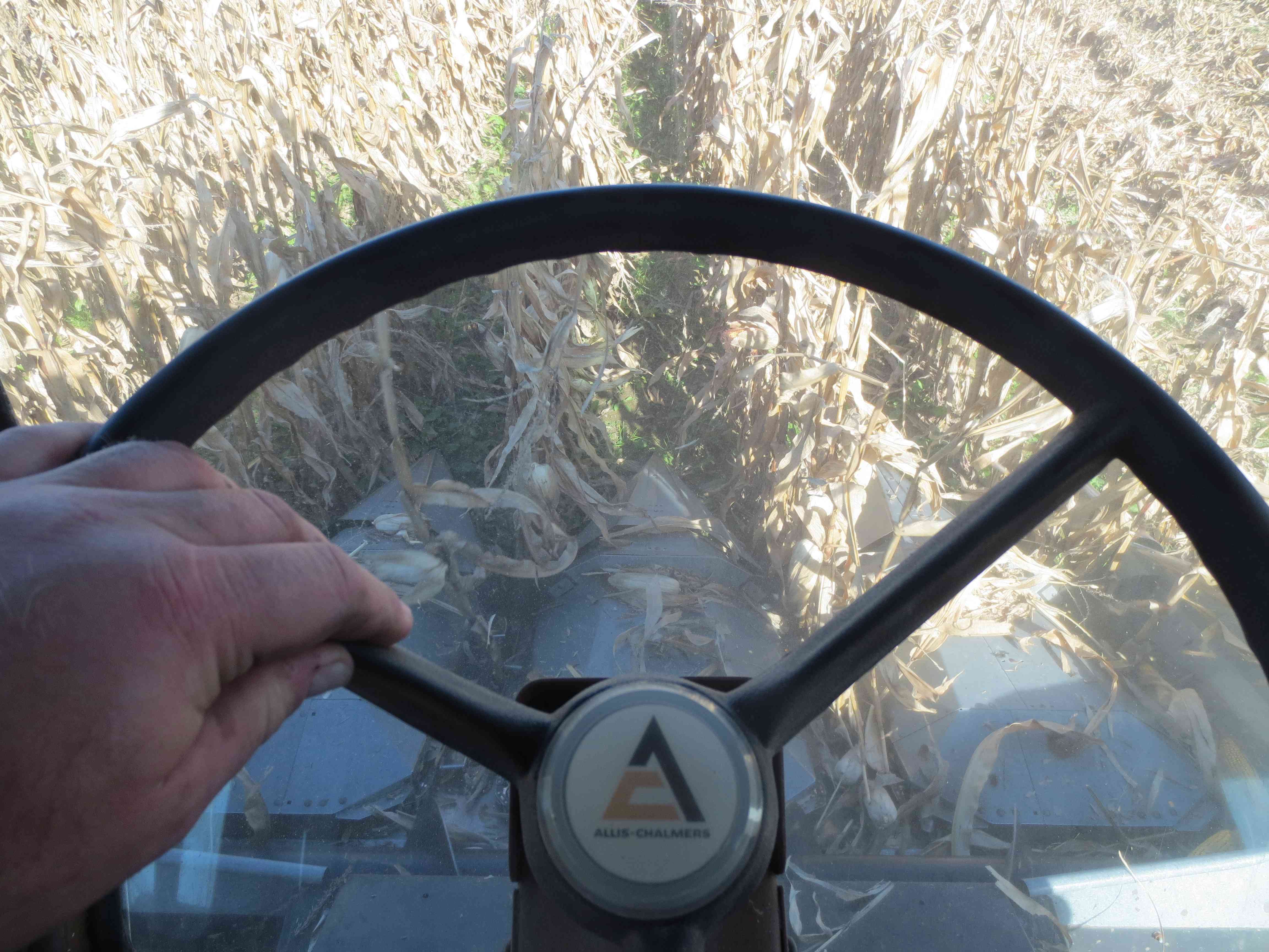

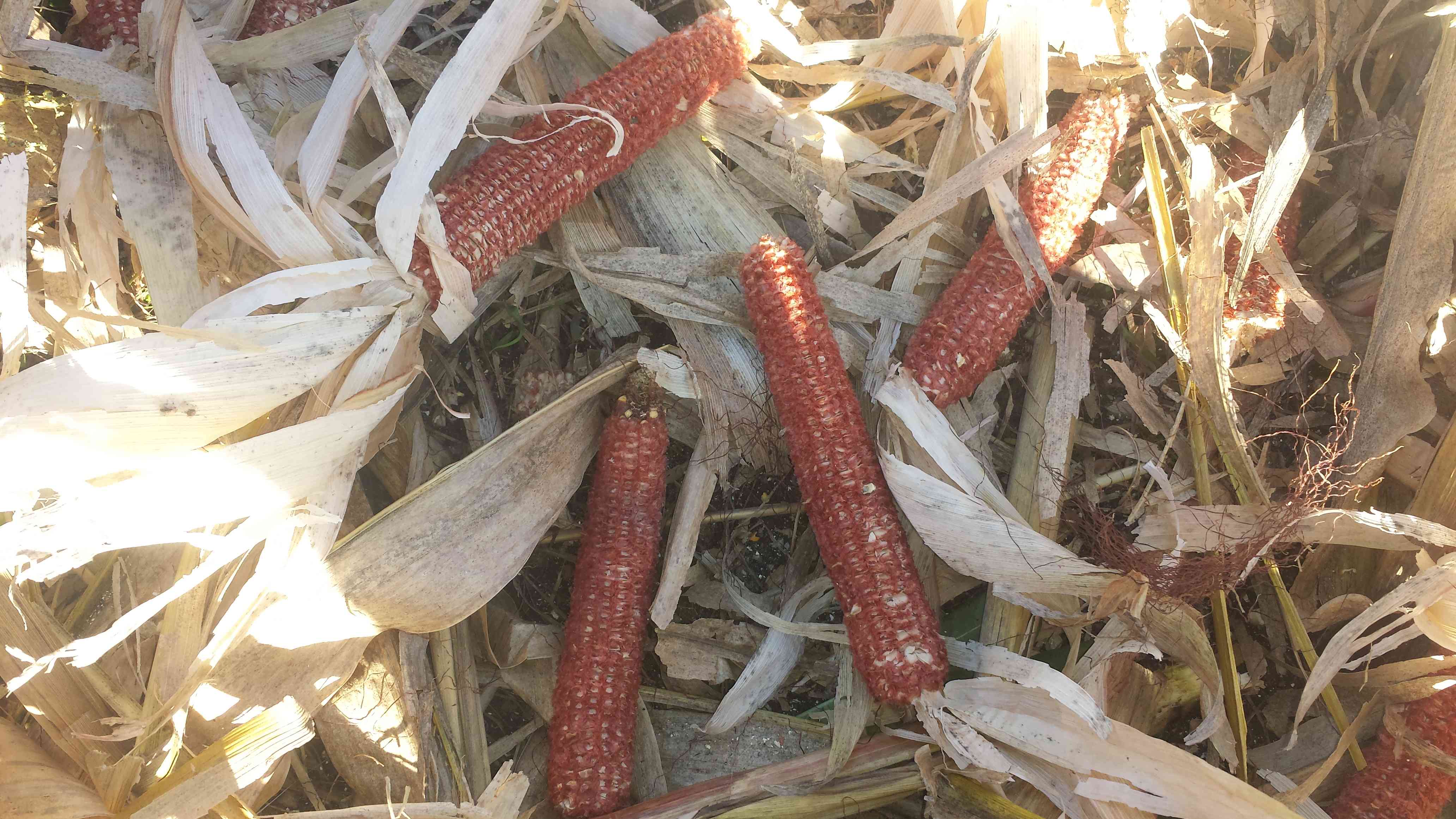

Here are some pictures of our F3 at work on Saturday.  Looks like she's doing a pretty good job.

combine looks good, looks like it's doing a good job! operator looks comfywhat more could you ask for!

traveling very slow....wonder it aint throwing it out the back with so little on the shoe
