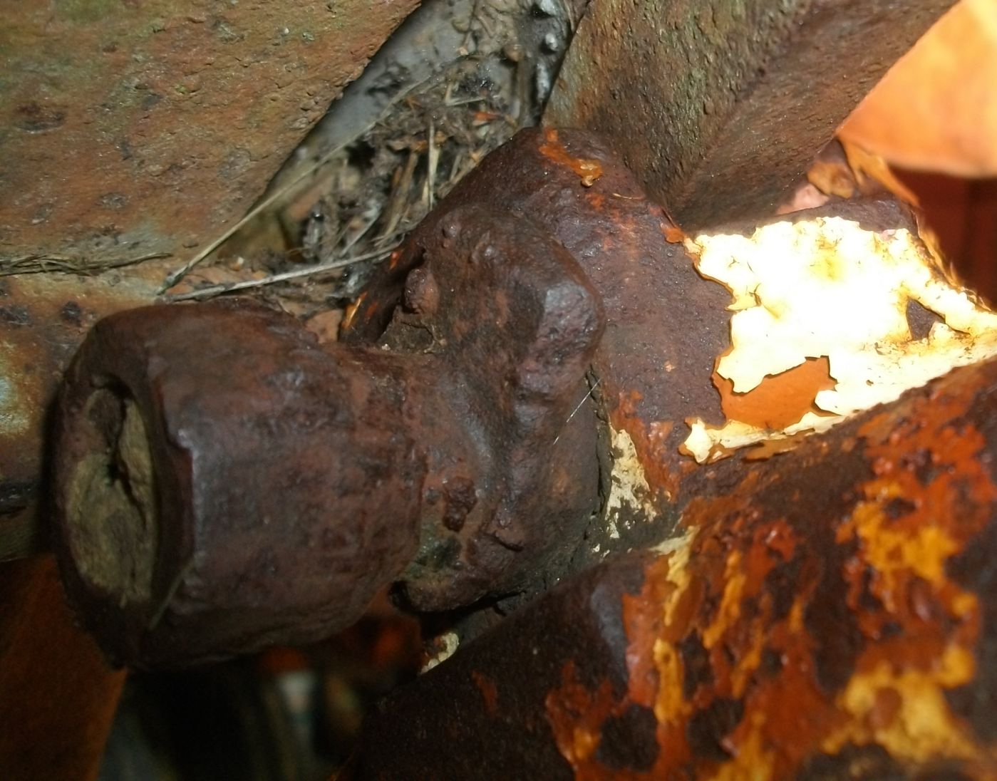

Here's what mine look like right now...

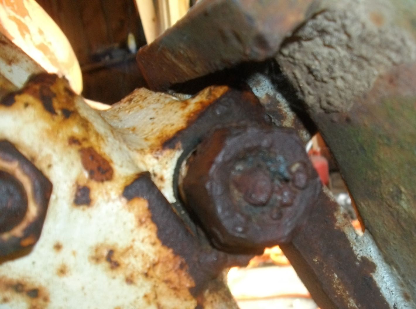

And this:

Well, I'm not sure whethere I'll need a six or four point socket, mebbie a three, five, or seven point socket...  or mebbie I'll be welding a tab on 'em and using a pipe wrench?  hee hee...  Fortunately, if I can get these apart, and find ONE good example in the bunch, I can probably make a replacement fastener.

Looks like it used to have 6 points. You might get lucky with a 6 point impact socket. All 4 of these have to turn c'clockwise about 180 degrees to free up the eccentrics. Then you just spin the wheel in. I'm gonna bet you will have to take the rim off by unbolting the wheel centers from the eccentric bracket thingy. You got a long weekend and good weather. I'd say you should be done some time Monday if not sooner. LOL
