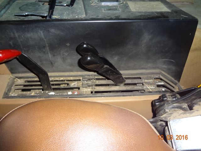

If reaching behind your back to move the levers is difficult, this may help.
This is the original:

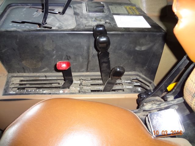

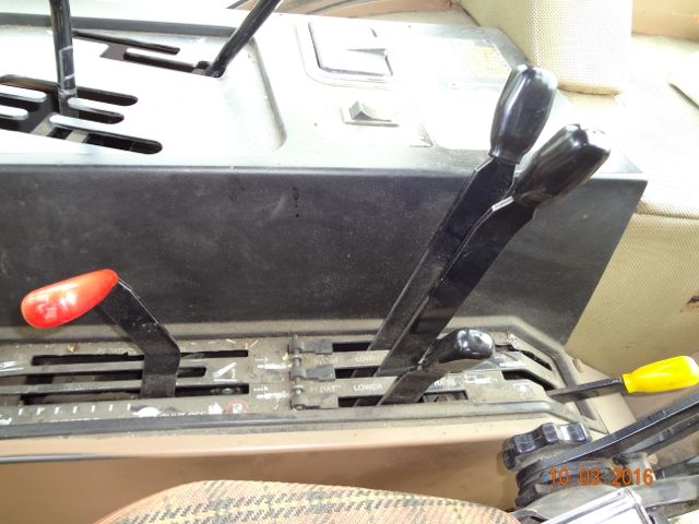

First mod:

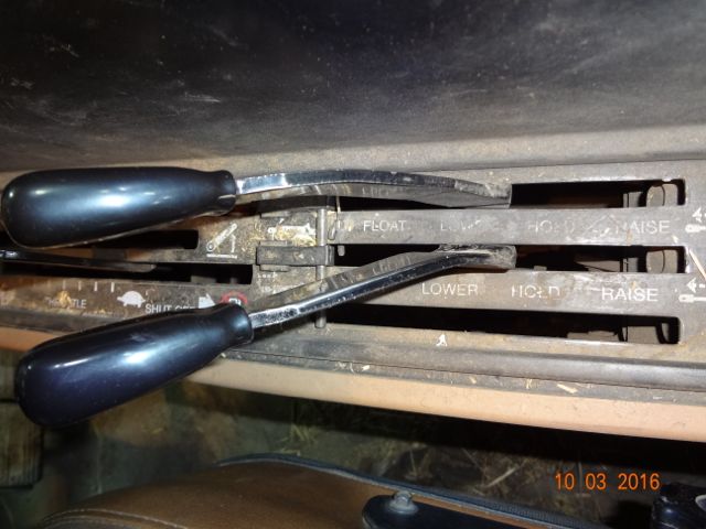

Second mod useful with a loader hooked to the remotes.
Close up.

Did you cut and weld them back?
Ron(AB) View Drop Down
Joined: 27 Dec 2009
Location: Alberta
Points: 962
Post Options Post Options   Thanks (0) Thanks(0)   Quote Ron(AB) Quote  Post ReplyReply Direct Link To This Post Posted: 08 Oct 2016 at 3:11pm
Yes, I removed the levers, cut them shorter, overlapped them, welded, and painted.
When the levers are overlapped it eliminated some side wiggling. That's a bonus.   As these tractors get houred up, the pivot holes get worn.
On the shorter handle version, I had to modify the the other end of the control cable by lengthening the valve pivot bracket, making it just as easy to operate as a long original lever.
